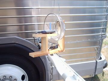

For the DIY'er, the poor and the cheap ;D
 http://www.turnpoint.net/wireless/has.html
 A Google search turns up many such sites.
  Mine    http://i667.photobucket.com/albums/vv34/jjrbus/bus%20pics/Bus%20exterior/tmpphpsVVB4s.jpg
                                                     HTH
