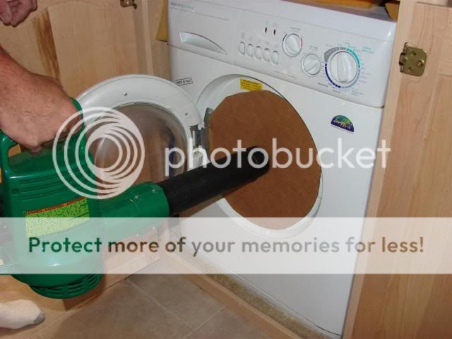

I am on my third Splendide and my current model is the 2100XC. I too dislike laundromats because I am impatient and you never know who put what in their washing machine before you get there. The space it takes up in my bus is worth it to me. I work from my bus, so I don’t mind the longer cycle time as I can wash and work at the same time.  I generally wash my clothes on a daily basis or at least 5 days per week  because the equivalent of two large towels is about the limit.  I also hang everything but pants and shirts in the bedroom to dry every morning to save electricity.  They are always dry by the end of the day here in CA. I have found that if you dry each shirt and pair of pants separately, it keeps them more wrinkle free.
I have the vented model and like it much better than the non-vented model (I have had both). I also have the optional drain pan and luckily it has never leaked, but if it did, it would drain down through a hose to under my coach instead of all over the floor.  The only problem I have had with the 2100XC is that the door has an engineering flaw where the latch is very thin plastic and I have broken the latch three times on this unit already in the course of about five years.  And of course, you cannot replace just the latch, you have to replace the entire door at a cost of over $100 each time.
The non-vented version can take up to one additional hour to dry, thereby using much more electricity and water.  The capacity is 15# which is a bit more than the older models.  You also need to be aware of the vents tend to clog up every several months and cause it to overheat and not dry your clothes completely or shutdown the machine when it gets too hot.  It takes a lot of work to remove the unit and clean the vents out.  However if you run 1 cup of vinegar on #12 cycle (Wool) monthly, it will help break down the soap and keep the vents cleaner.  There is a specific process to use monthly to clean the unit properly, which you can get if you call the company.  It involves running the machine through three specific cycles which takes about four hours every month.  This helps keep it clean inside.

Here are the steps I follow monthly to keep my Splendide vents clean.  Your mileage may vary.
1.   Do not put any clothes in the washer
2.   Do not put any Laundry Detergent in the washer
3.   Put 1 cup Vinegar in far left tray
4.   Set the dial to cycle #11 (Silk)
5.   Turn the machine ON
6.   Set the WASH TEMP to Hot
7.   Set the DRY TIME to OFF so it will not enter the Dry cycle
8.   Set a timer to 4.5 Minutes
9.   Push the Start button
10.   When the water stops entering the unit push and hold the Start button until all lights comes on, then release the button.
11.   If the water is at least half way up the glass, go to Step 27
12.   If the water is not at least half way up the glass, read on…
13.   In my case it only came up to the bottom of the circular glass on the inside of the door.
14.   Rotate the Cycle dial one full turn to cycle #11 (Silk)
15.   Set a timer to 3.0 Minutes
16.   Hit the Start button.
17.   When the water stop entering the unit push and hold the Start button until all lights comes on, then release the button.
18.   This time the water came up almost to the bottom of the horizontal bevel in the glass.
19.   If the water is at least half way up the glass, go to Step 27
20.   If the water is still not at least half way up the glass, read on…
21.   In my case it only came up to the bevel on the glass, which is less than half full still.
22.   Rotate the Cycle dial one full turn to cycle #11 (Silk) (Again)
23.   Set a timer to 3.0 Minutes
24.   Hit the Start button.
25.   When the water stops entering the unit push and hold the Start button until all lights comes on, then release the button.
26.   By now, the water level should be at about 5/8 full which is over half-way as instructed.
27.   Move the cycle dial to cycle #12 (Wool)
28.   Press the Extra Rinse button
29.   Press the Start button once (do not hold) and let it run through that complete cycle.  Even more water will enter the machine bring it up to almost 5/8 full before the water started agitating.
30.   This cycle will run for 59 minutes.
31.   Run thru this entire cycle again until you have run it 3 times completely.
1967 Eagle with Series 60 Power Plant

100. connect leaf blower to vent hose with duct tape...
Wow that is quite the process you have there!
I did not know about the drain pan option, sounds smart!
