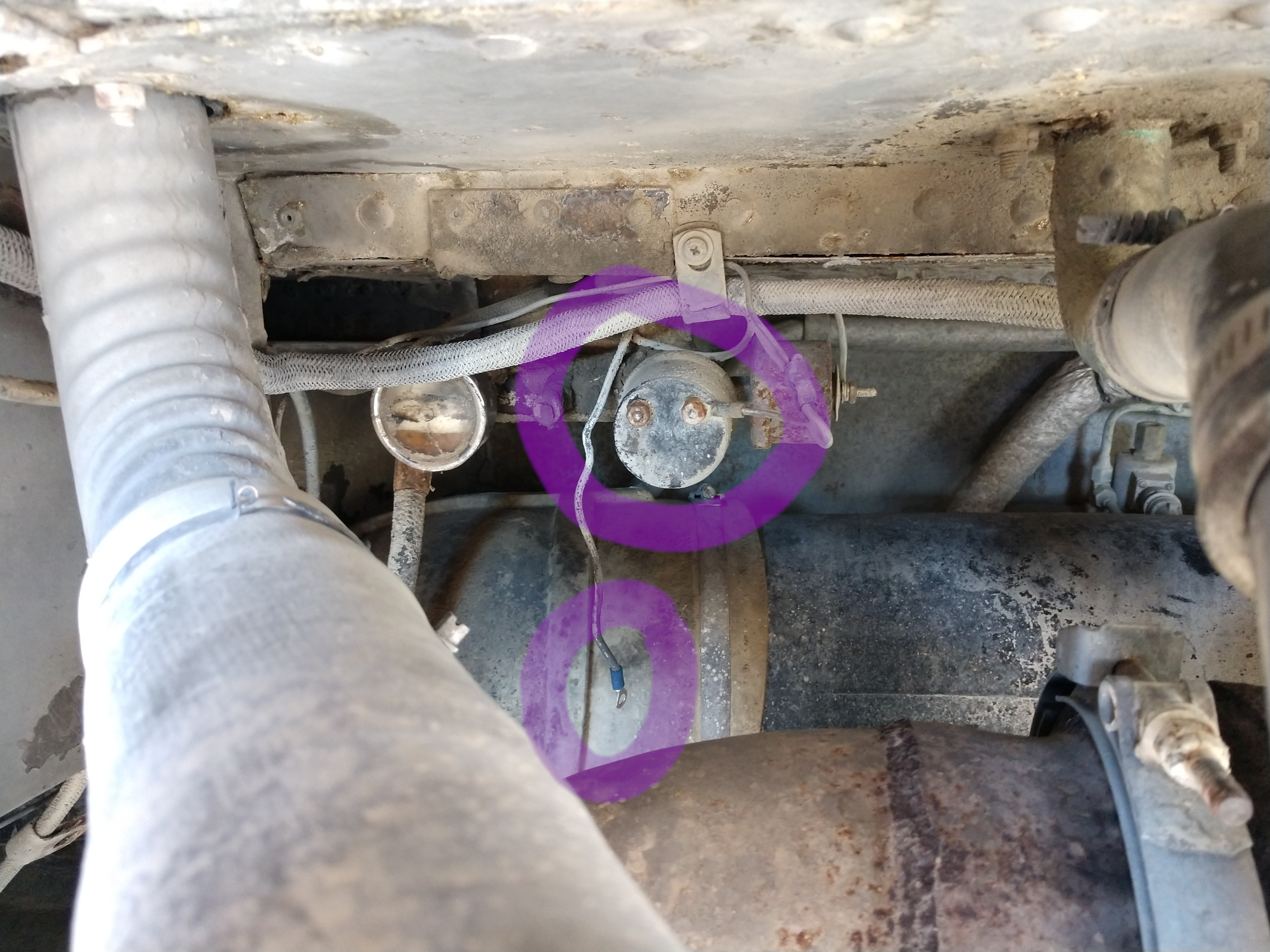

There is some sort of sensor that is possibly involved.  I noticed that a wire had come off of it.  I tried reconnecting it and then my bus would immediately shut off when it got air pressure even when it was completely cooled.
Photo attached, or here:
http://tmp.davepics.com/Bus/Cooling-Sensor.jpg
Does anyone know what this sensor is?  It's right next to what the maintenance manual claims should be my temperature gauge - or perhaps this is the temp gauge?
Offline daveola
  • Galactic Bustastic!
  • Posts: 360
  • Big Red and Little Red
    • Dave's Bus
Re: Overheating problems - trying to make my way up I-80 towards Reno
« Reply #2 on: August 30, 2021, 04:46:36 PM »
 Here's the page from the maintenance manual:
http://tmp.davepics.com/Bus/Cooling-Maintenance-Manual.png
