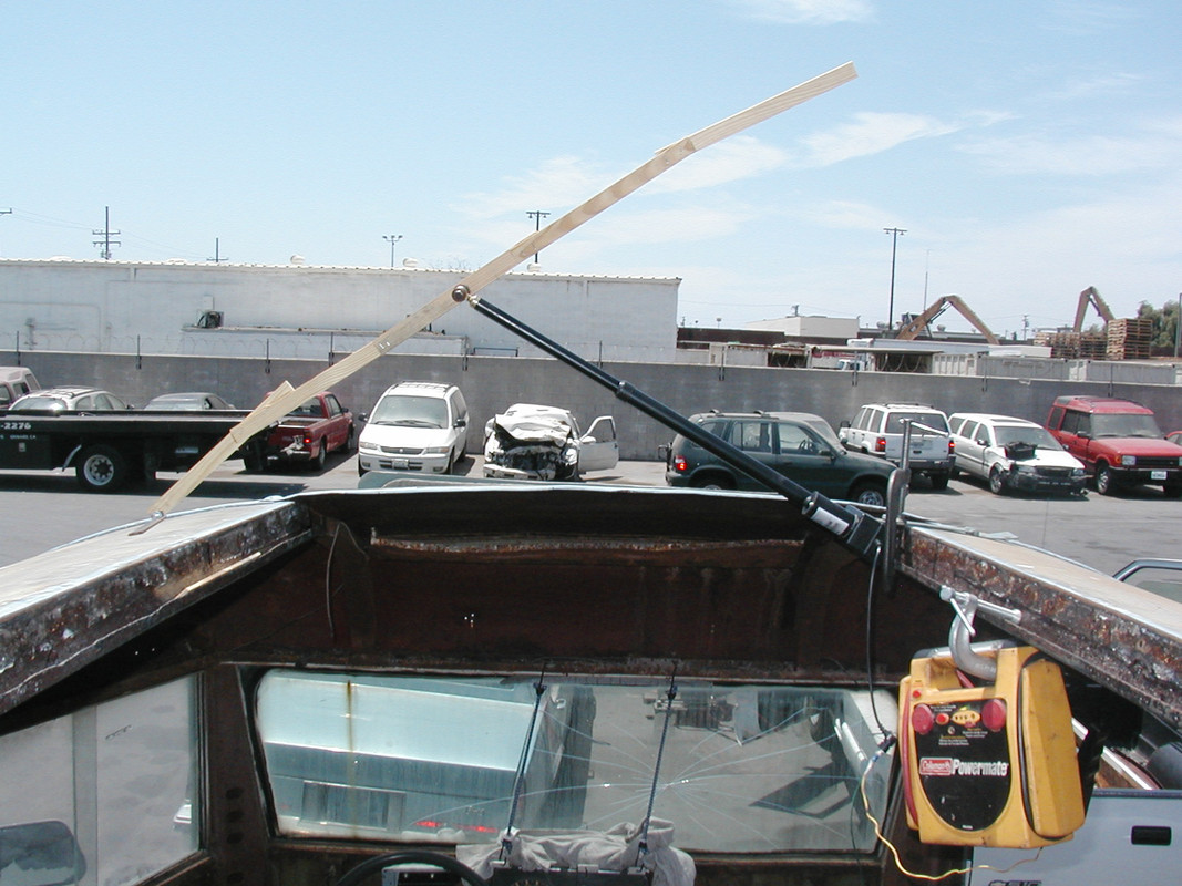

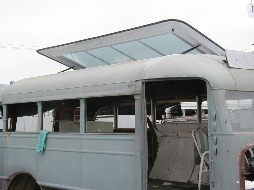

Quite a bit of hardware but the electric linear actuators I use to tilt the top of my bus work great.  I did have to reinforce the base plate on the actuators as they were plastic and not up to snuff.  Once that was done I've had no trouble with them.  Jack
During design:
Finished:
