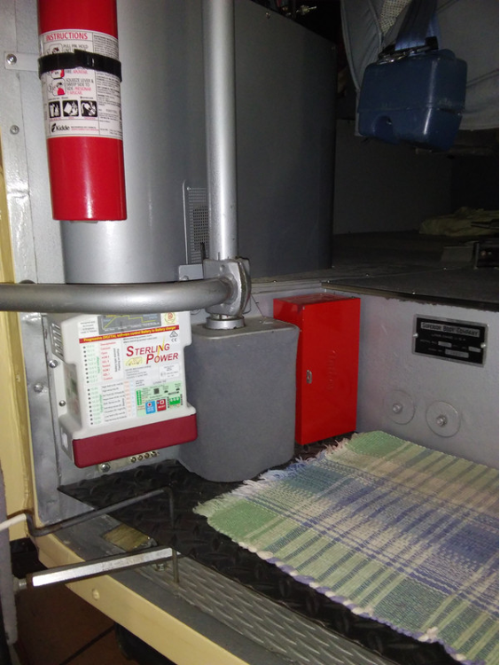

I use a Sterling battery to battery charger on my little bus.  The only time it seemed a little hot was on the first trip with it, as the "new" feeling was wearing off.  I installed a switch in its circuit so it doesn't try to charge the house batteries while the alternator is recharging the start batteries at the same time.  Once the start batteries are topped off, I add the house battery load.
As a side note, the reason I went with the Sterling was to thwart the Yosemite camp host Gestapos who got their knickers in a knot when I ran my nearly silent generator to charge the house batteries when dry camping.
