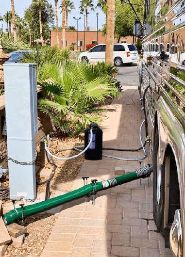

Softener and cartridge pre-filter hooked up to the bus for normal operation.

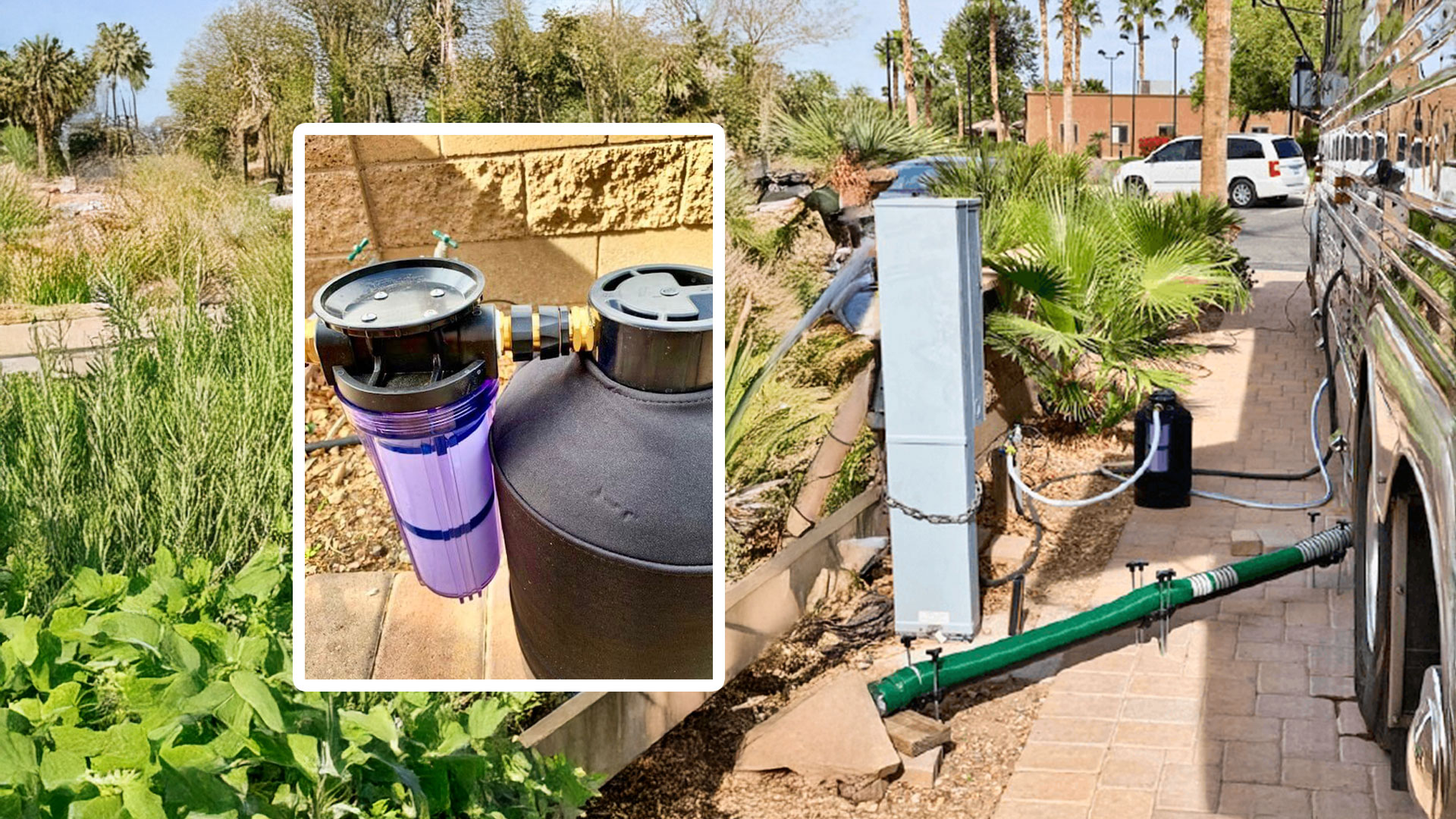

Close-ups of the softener and cartridge pre-filter attached to one another.

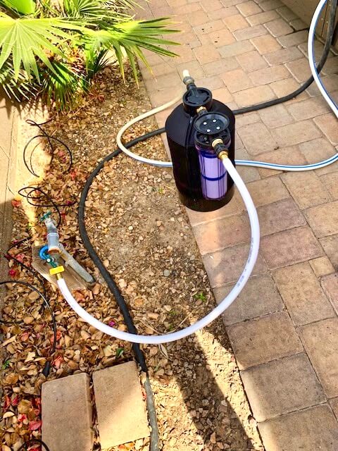

Another look at the system.
Run fresh water through the canister to make a salt brine at a rate that will allow a pencil-sized stream of salt brine to pass through the water softener and out the input side of the softener.  This back flush will make sure all the softening resins are exposed to the salt brine where the chemical reaction between the salt brine and the resin beads will flush all the hard water residue out of the softener and make it ready for another round of softening.  Run the pencil-size stream for 15 to 20 minutes and then turn the water on full blast for about 5 minutes to flush all the salt out of the softener and the canister.

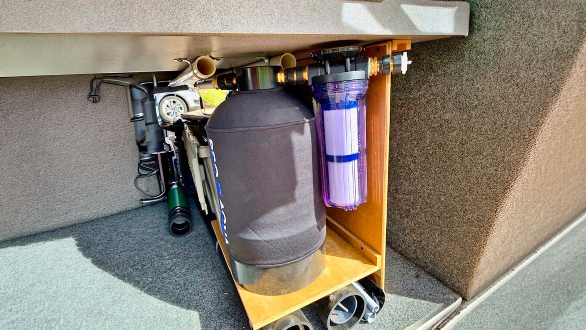

Storage area in the bay with and without the water softener and cartridge pre-filter.  My folding Brompton bicycles fit between the four portable solar panels (the black units forward) and the water softener on the shelf so nothing shifts around while going down the road.
Water softener in the under-storage compartments.

I rigged up both male and female caps with the same quick disconnects so I can securely seal everything up during transport.  That sure beats tipping the heavy water softener over to drain out the water before putting it into the bay. I built a simple platform that the softener and pre-filter sit on in the forward storage compartment on the driver’s side of my coach.  Full of water the units weigh over 50 pounds so making storage easy and fast is important!
