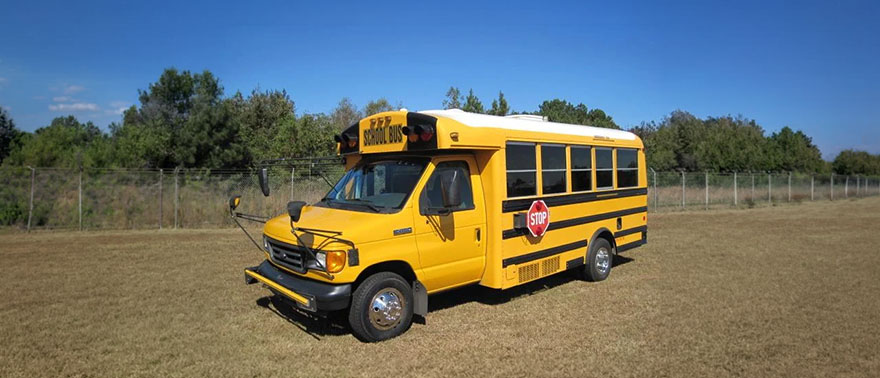

Type A (Short Bus): Built on a cutaway van chassis, these are easy to maneuver and park in standard spaces. They are ideal for solo travelers or couples who prioritize mobility over space.

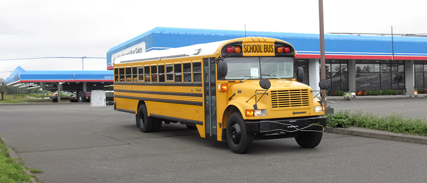

Type C (Conventional): The classic school bus with a "nose" where the engine sits out front. These offer easier engine access for repairs but provide slightly less interior living space relative to their overall length.

Typical Short Bus.

Conventional Bus.

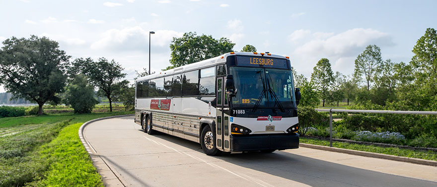

If you plan on full-time living with high-end amenities, a motorcoach might be the right path. These vehicles are designed for long-distance highway travel and often include massive "under-bay" storage for water tanks and batteries, so you don’t have to hang your tanks underneath where they are exposed to the elements.
However, they are more complex and expensive to maintain than school buses. Much like planning Coach Tours, self-drive vacations, choosing the right vehicle requires careful consideration of comfort, cost, and long-term practicality.

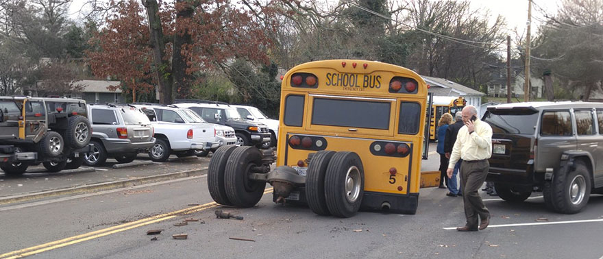

A beautiful interior is worthless if the engine fails two hundred miles into your first trip. You must evaluate the mechanical components with a professional eye or hire a diesel mechanic to perform a pre-purchase inspection. Repairs on an older bus can easily exceed the purchase price if you are not careful.
How to Choose the Right Bus for Your DIY Conversion Project - bus conversion photo
What can happen if you do not properly maintain your bus.

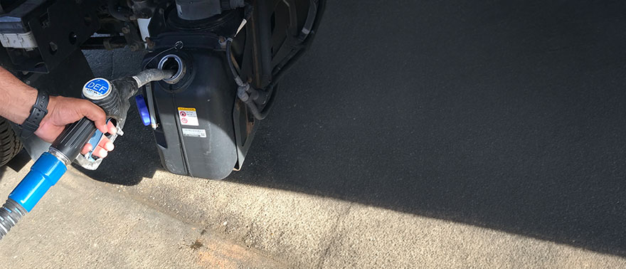

Conversely, newer engines (post-2004 and especially post-2007) often include complex Exhaust Gas Recirculation (EGR) and Diesel Particulate Filter (DPF) systems. While better for the environment, these systems can be prone to failure and expensive to repair in a DIY context.
Diesel Exhaust Fluid (DEF)
