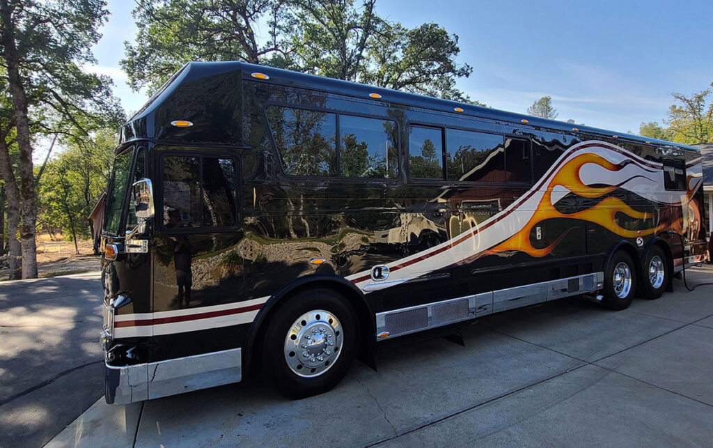

A year-long process had the bus in fresh black basecoat with better than new aluminum and steel bodywork. Al and his son Scott also fabricated a panel to utilize Corvette Z06 tail lights and license plate panel, a nod to Al’s love of Corvettes.
Then Al and Scott finished the custom paint with old school House of Kolor candy flames and multiple layers of clear coat, again, all done at home. The bus was then color sanded, buffed, pinstriped, and lettered, and the Crown Royale III was unveiled.
