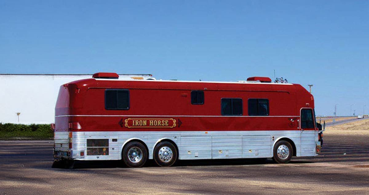

With its deep red upper body paint and anodized aluminum lower panels the profile was quite striking. The name “Iron Horse” was on the side done in gold and black western type. The bus was open to visitors for much of the rally, and one peek inside the entrance door told me that this conversion was going to be very unique. They were gracious in allowing me to photograph their bus and interview them at length about how it came to be the Iron Horse.

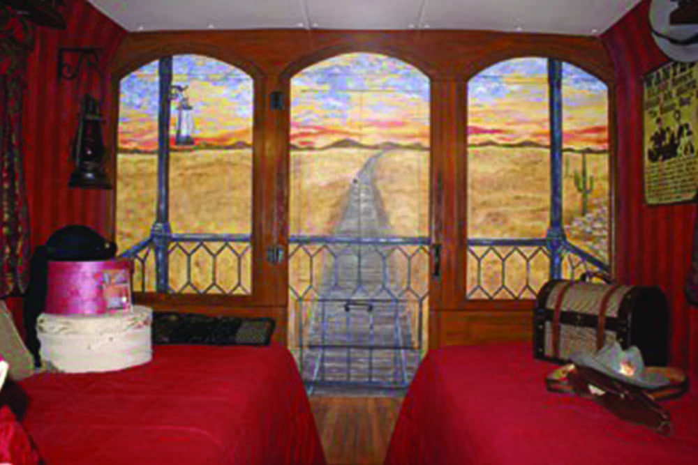

The interior layout is actually fairly standard, but you are unaware of that when visiting. The bedroom is in the rear and features a mural on the rear wall. The mural gives the appearance that you are standing on the rear platform of the last car of a train that is traveling through the old west. Carpeting is a deep red color and is offset with gold colored accents in keeping with the Victorian sense of décor that was prevalent in the late 19th century.

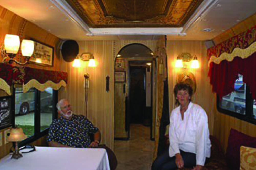

Jimmy and Sadie in the parlor (view looking rearward)
The parlor (view looking forward)
The parlor

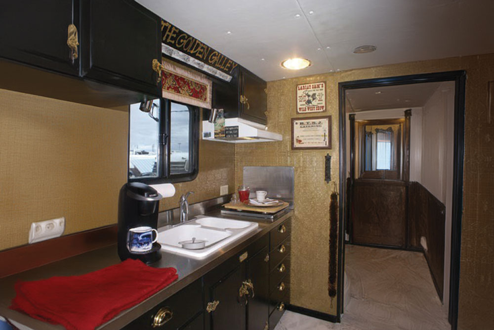

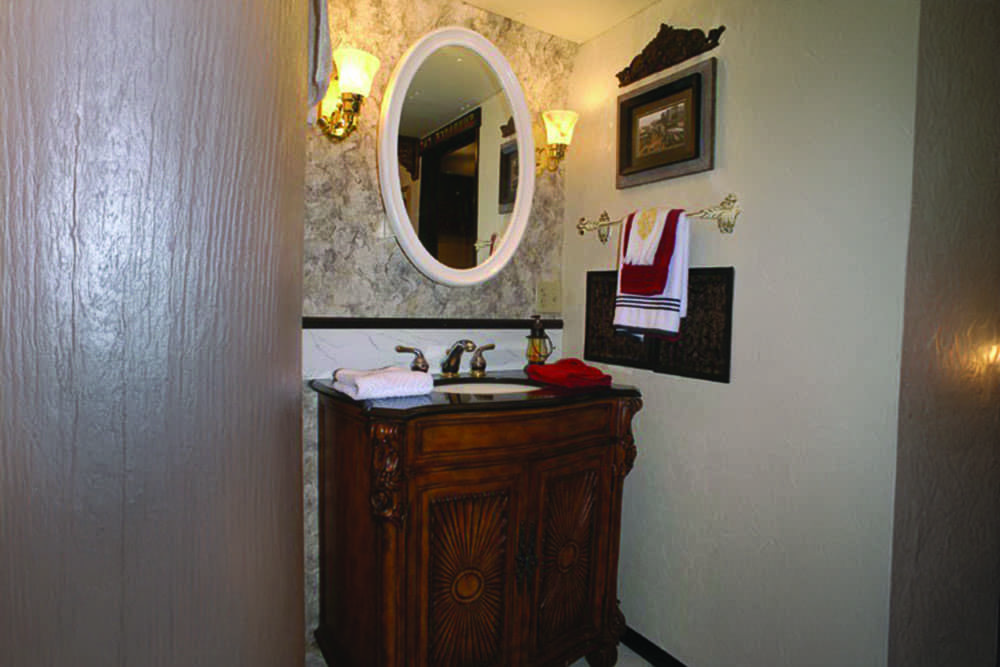

The bathroom comes next and then the galley mid coach. This area features a white grained marble floor. The cabinets, shelving, hardware, and fixtures look “old” and are period appropriate as much as possible. No hand pumps for the water, however; the plumbing is modern, albeit mostly out of sight.

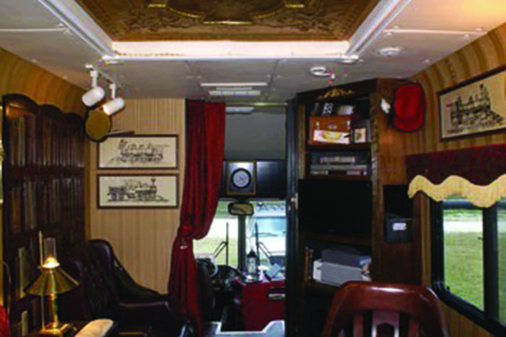

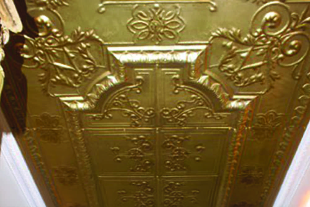

The “living room” is designed like the parlor of a private train car. It is not completely open to the driving compartment, which is a bit more difficult to make look like the cab of a locomotive. The parlor has a “tin” ceiling, three comfortable chairs, and a table. There is shelving in one corner, and a “faux” bookcase with leather bound books in another. But one of Sadie’s favorite interior features is the antique “fainting sofa.”
It has an authentic appearance but includes concealed storage space underneath. Jimmy and Sadie have even gone so far as to create authentic looking certificates and posters in which the names and initials have something to do with their family. While the interior just looks neat to the casual visitor every detail is intentional and has meaning to them; even their clothing reflects the “style” of the period.
