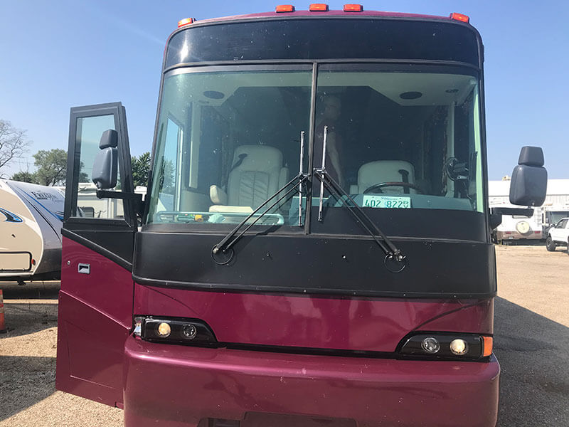

This is the front view of the coach before it was upgraded.

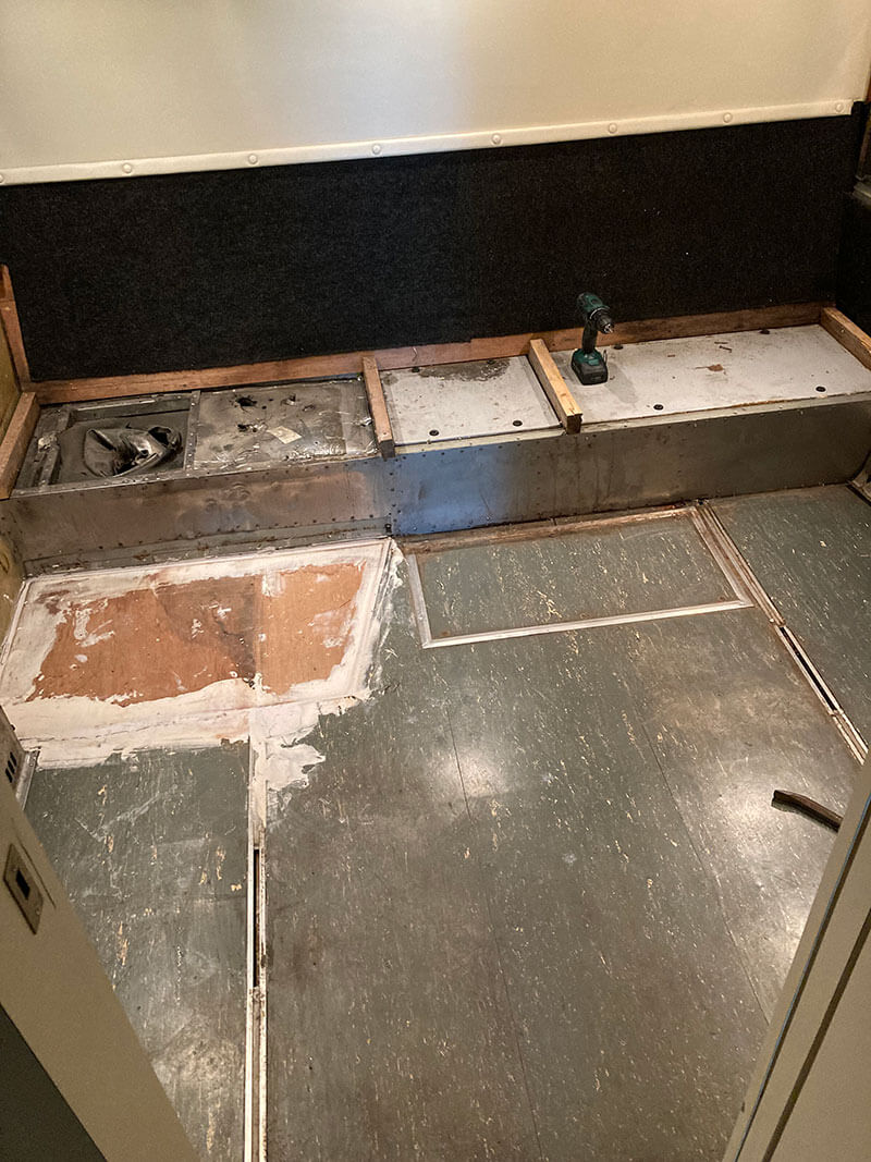

The rear interior area where the original toilet was. Also, there were access panels for the engine and transmission.
Editor’s Note:  If there were engine and/or transmission access panels, or any other access panels such as the fuel-sending unit, never, ever cover them up permanently.  Always leave them accessible when you complete your conversion.  Eventually, somewhere, sometime, someone will want to get in there.  If you fail to do that, you may end up tearing up your floor at a later time.

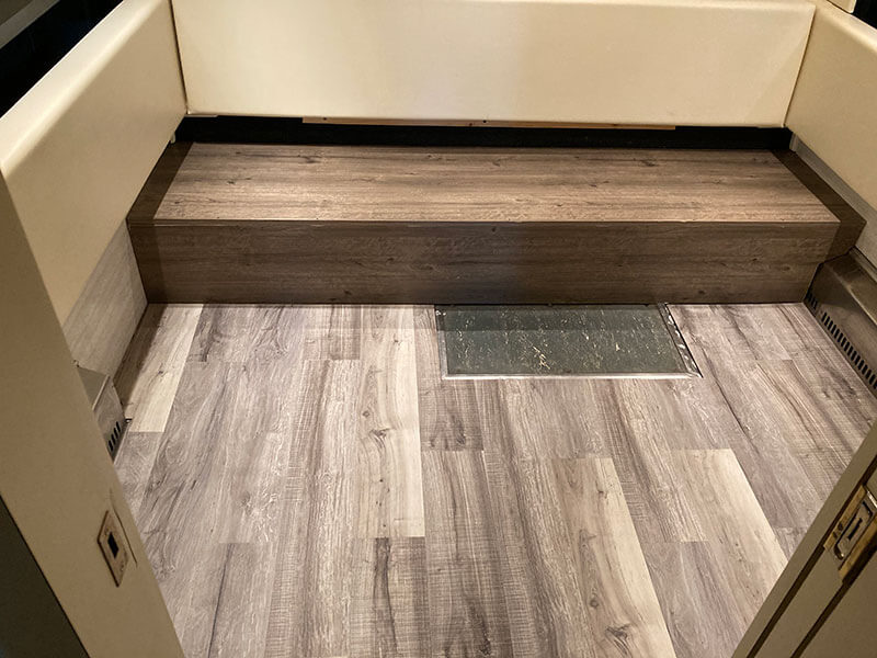

The rear interior area after the upgrade.

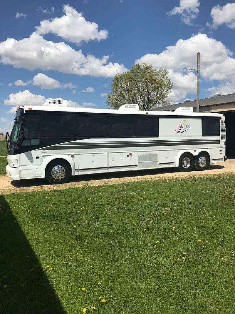

When we bought the bus, it was set up as a day bus. It didn’t have a bed in the back, just a U-shaped sitting arrangement. So, we went to work and tore out the old U-shaped seating in the back and fixed the floor and area where the original toilet was located, insulating, and sealing up any holes to keep the varmints and elements out.

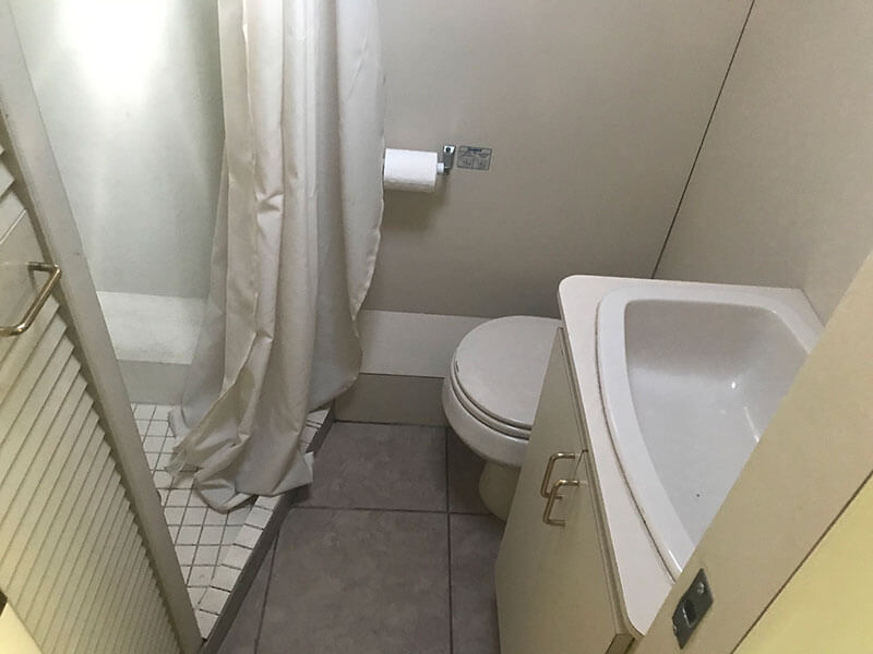

Because of not being winterized, it needed pipes and drains fixed that were broken. The toilet was also broken and needed to be replaced. We replaced the old toilet with a new porcelain ADA-elongated bowl RV toilet. The rest of the bus just needed a good going-through to get it up to par.
The 102 in the model means it’s 102 inches (8-½ ft.) wide. D is the model and D3 means it’s 40ft. long. It’s the perfect length for traveling and getting around.
After we purchased the bus, we took it to the MCI Regional Center on East Oakton St. in Des Plaines, IL to get a bumper-to-bumper checkup. This was during the fall of 2020 when COVID really hit the travel industry hard, especially the bus industry. They were glad to have a project to work on, and that’s where I met the shop foreman, Marcos, and the Service Manager, Cary, both were great professionals to work with and we were also able to meet some of the great technicians that work on the buses to keep the local fleets in top shape.
Because the workload was especially slow because of COVID, Marcos, and Cary were anxious to work with us to develop a plan to update the bus to give it a more modern look.

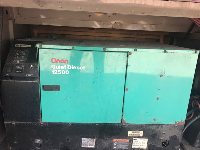

The Onan 12.5 KW Quiet Diesel generator that powers all the coach house accessories.

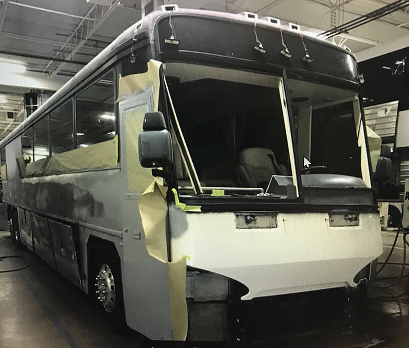

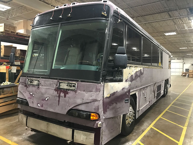

The front of the bus in the body shop.

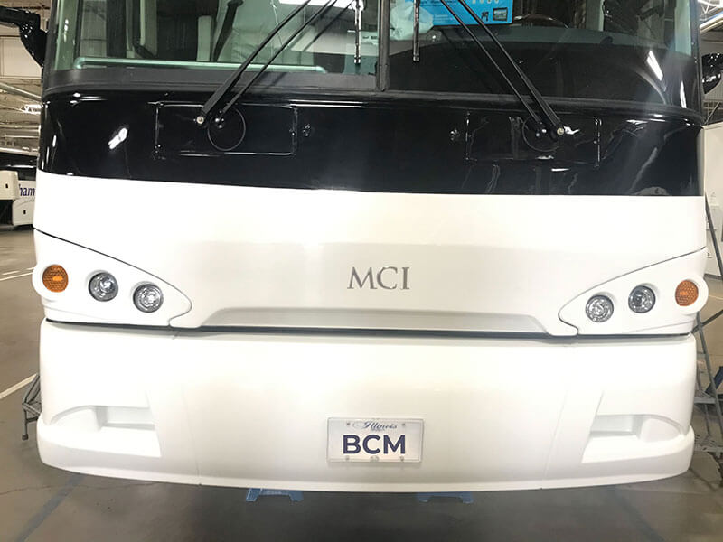

The 2021 front cap being installed in the body shop.
The front end after coming out of the paint shop.
Then the bus went to Cary, who also oversees the full-service paint and body shop. They totally sanded down the bus, installed a 2021 front cap on the bus, and gave it an OEM paint job with 2-part epoxy paint. They also installed new fiberglass wheel wells, and front and rear bumpers and replaced all the old exterior lighting with new LED lights.

Second, the 12.5 KVA Onan Quiet Diesel generator is powered up when we’re parked or boondocking, it is automatically switched to power the breaker panel providing all the power necessary to run all the AC loads at one time. When the Onan generator or shore power is connected, I also have a 100 Amp 120 VAC to 12 VDC converter that automatically switches online to power any 12-volt load in the bus. Some of the interior lighting is 12 VDC and needs power from a converter when the engine is not running.

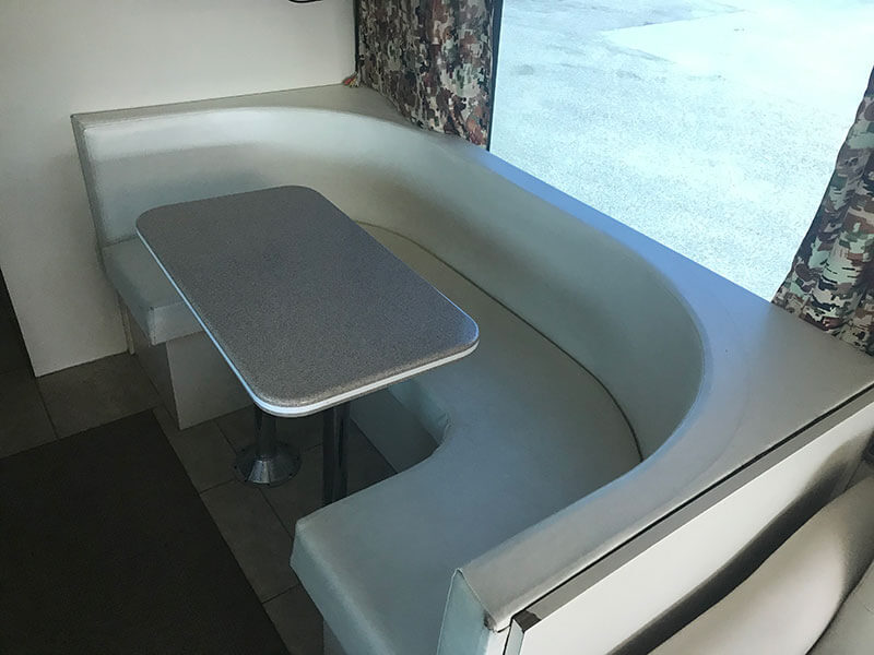

The wrap-around dinette seats four people.

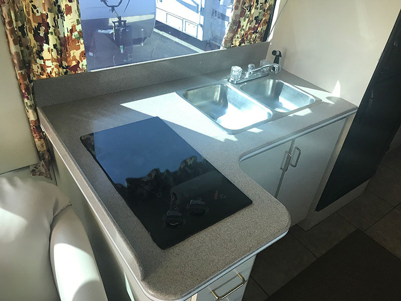

The 2-burner stove top and 2-basin sink.

Next to the pantry are the refrigerator, sink, stovetop, and cabinets. In front of the restroom on the driver’s side is a wrap-around dinette. Then in the main open area, we have two jack-knife couches and four-barrel chairs.

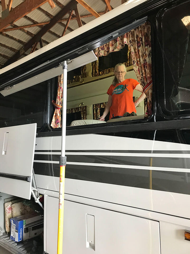

The windows hinge out to provide access to move appliances in and out.
