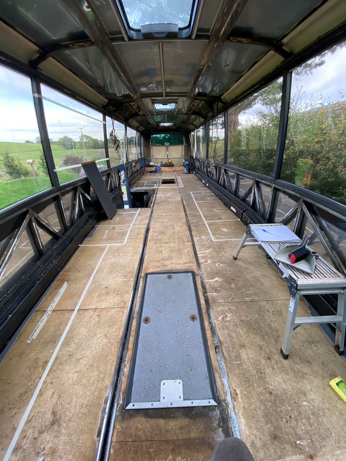

The empty coach.
The empty coach.
The next job for stripping the coach was removing all the overhead lockers and curtains, and ripping up all the flooring, ceiling, and walls to remove any old insulation. Given the model we wanted and bought, we had to remove the bathroom. This was a difficult and long job which resulted in us having to cut the fiberglass into pieces and pulling it out from above. After the bathroom had been removed, we had just the bare bones of the coach ready to start building our dream home on wheels!
We had no real drawn plans of the coach to build off, so a lot of it was mapped out on the floor using tape and notes placed here and there on pieces of paper throughout. We did draw a completed floor plan with electrical details and plumbing eventually…even if it was halfway through the build, it still helped!
Given the fact we had no plan at the start, we had plenty of ideas and inspiration in our heads of what we wanted, along with individual specifications as we both wanted a change and improvement from the old static that we used to live in.
The first internal building job we faced was to raise the floor at the front of the coach. From about two meters (6.5’) in from the cab, the floor sloped downward, this obviously wasn’t suitable for living. It was raised 8 inches at the front to nothing, so it carried out flat the whole way through. Given the access hatch for air tanks that were in the raised area, it gave us the perfect chance to create a “secret” storage compartment down the middle of the planned living room space.

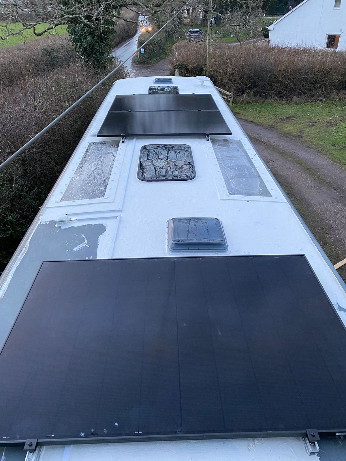

For us, having as much power off the grid was a big yes, so we fitted four 400W solar panels to the roof which gives us a 1.6KW solar system. This is paired with two Renogy charge controllers, a Renogy battery monitor, a Renogy 3kW pure sinewave inverter charger, and the Renogy One; we have a complete off-grid system that can be remotely accessed and monitored anytime.
Victron Energy was going to be our choice for the DC side of things but after sizing the system and what we would need, we just couldn’t justify spending that amount of money for something that was available for less and just as good. The storage for the system consists of four 180Ah Leisure batteries, giving a total capacity of 720Ah, and all the equipment is specified to take and operate off lithium batteries later.

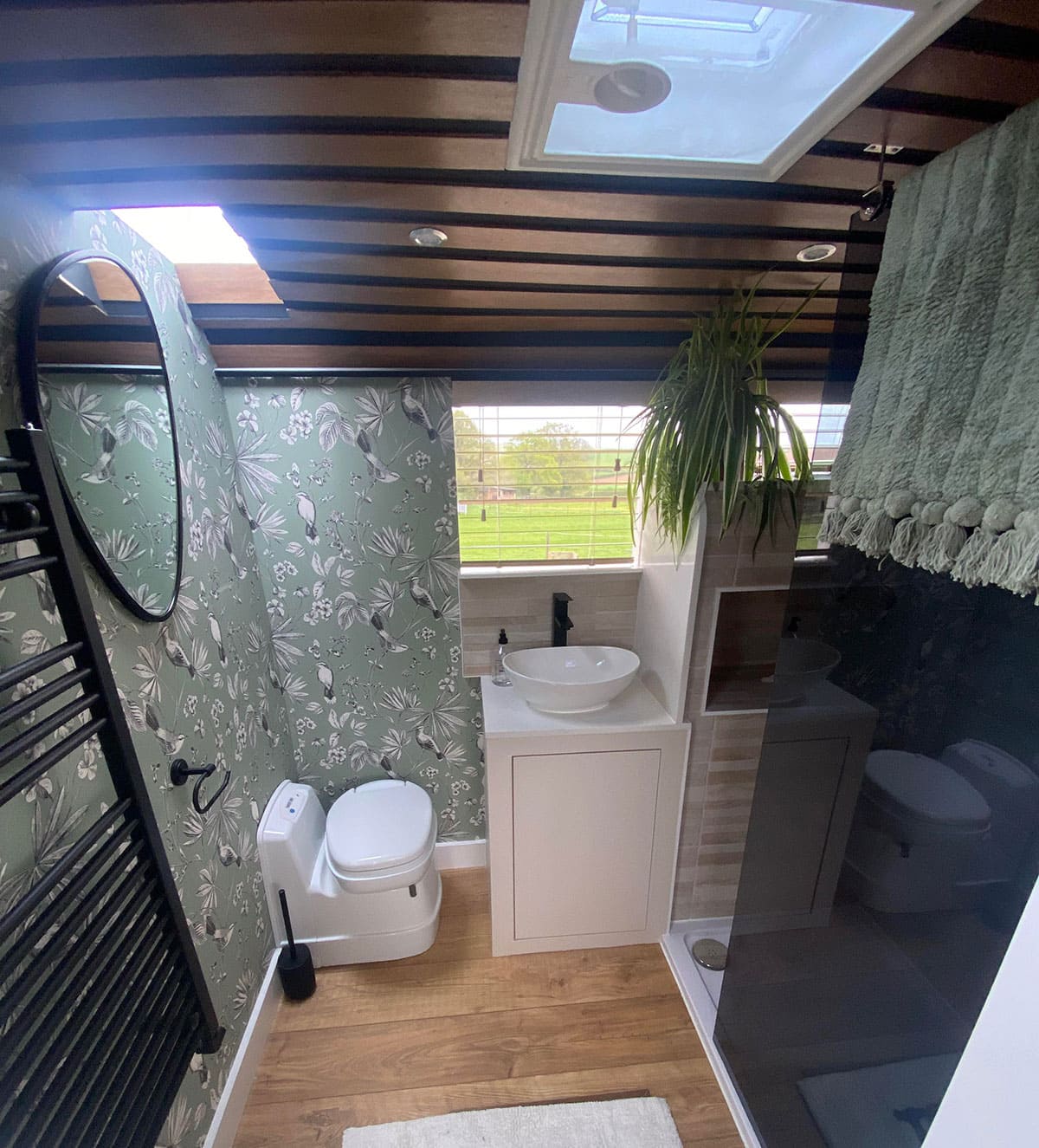

Having a full-size bathroom with a big shower and space to move around in was one of our requirements as we didn’t have this before. The other requirement was a functional kitchen with plenty of counter space to cook, eat, work, and socialize. Having a selection of base units, including a pantry and a built-in fridge freezer let us achieve this.

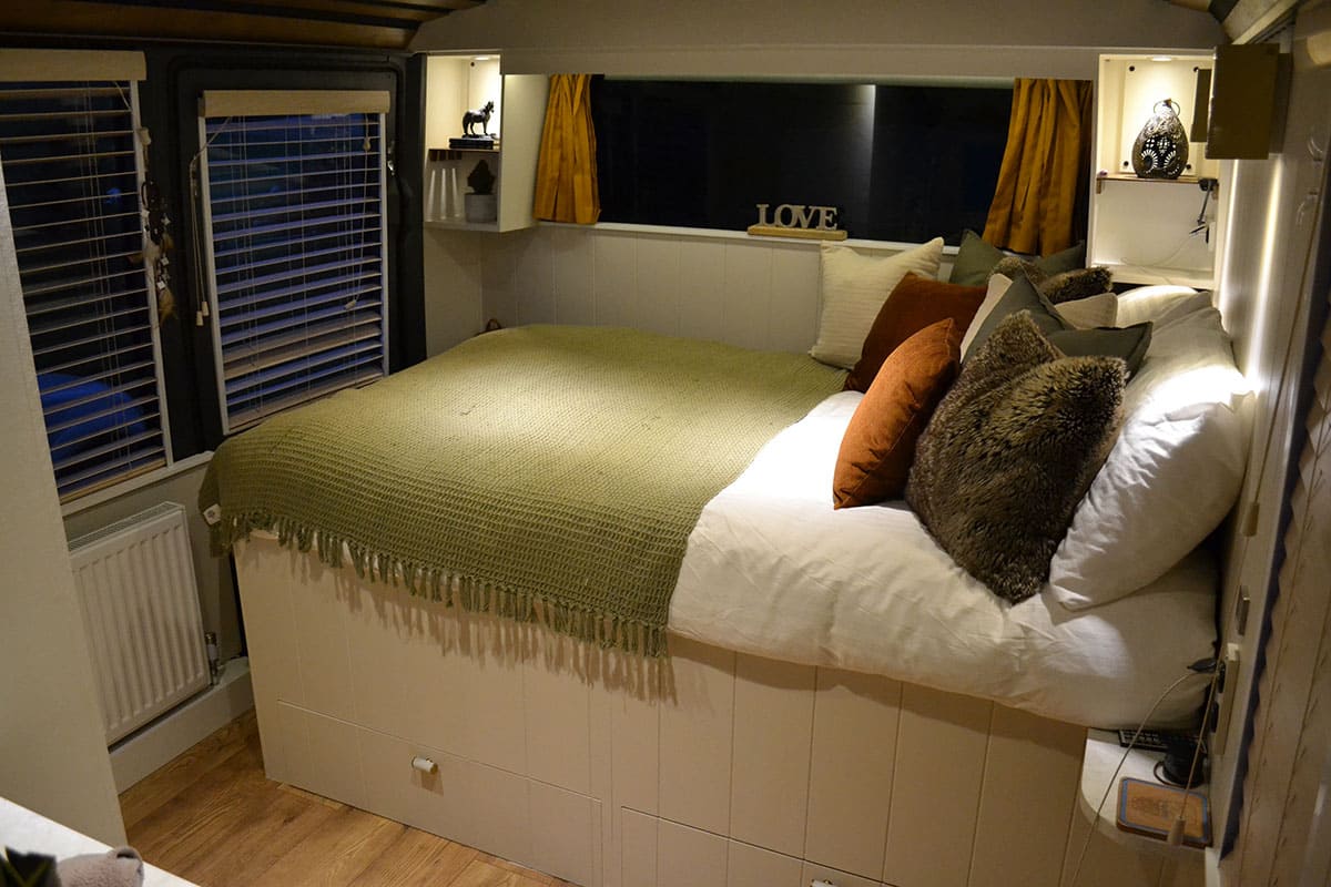

The bedroom.
The bedroom.
For the bedroom, storage was important. We decided that having a raised ottoman bed would be ideal, but we then decided to go one step further and add drawers underneath that too! The bed has been built against the back wall, which helps maximize space but also the views we get from lying in bed are dreamy. As for clothes storage, we have built a small wardrobe in the corner of the room where we have a hanging rail and some shelves.
We decided to get lots of small, fabric storage boxes to put on these shelves to keep our clothes in, rolled, as again this maximizes storage which is essential for a tiny home! Finally, a space to get ready in the morning was needed, so with the leftover worktop we added a small dressing table. This fits beautifully between the wardrobe and our bedroom door. Alcove shelves and dimmable LED lighting make it the perfect space for unwinding and sleeping in.

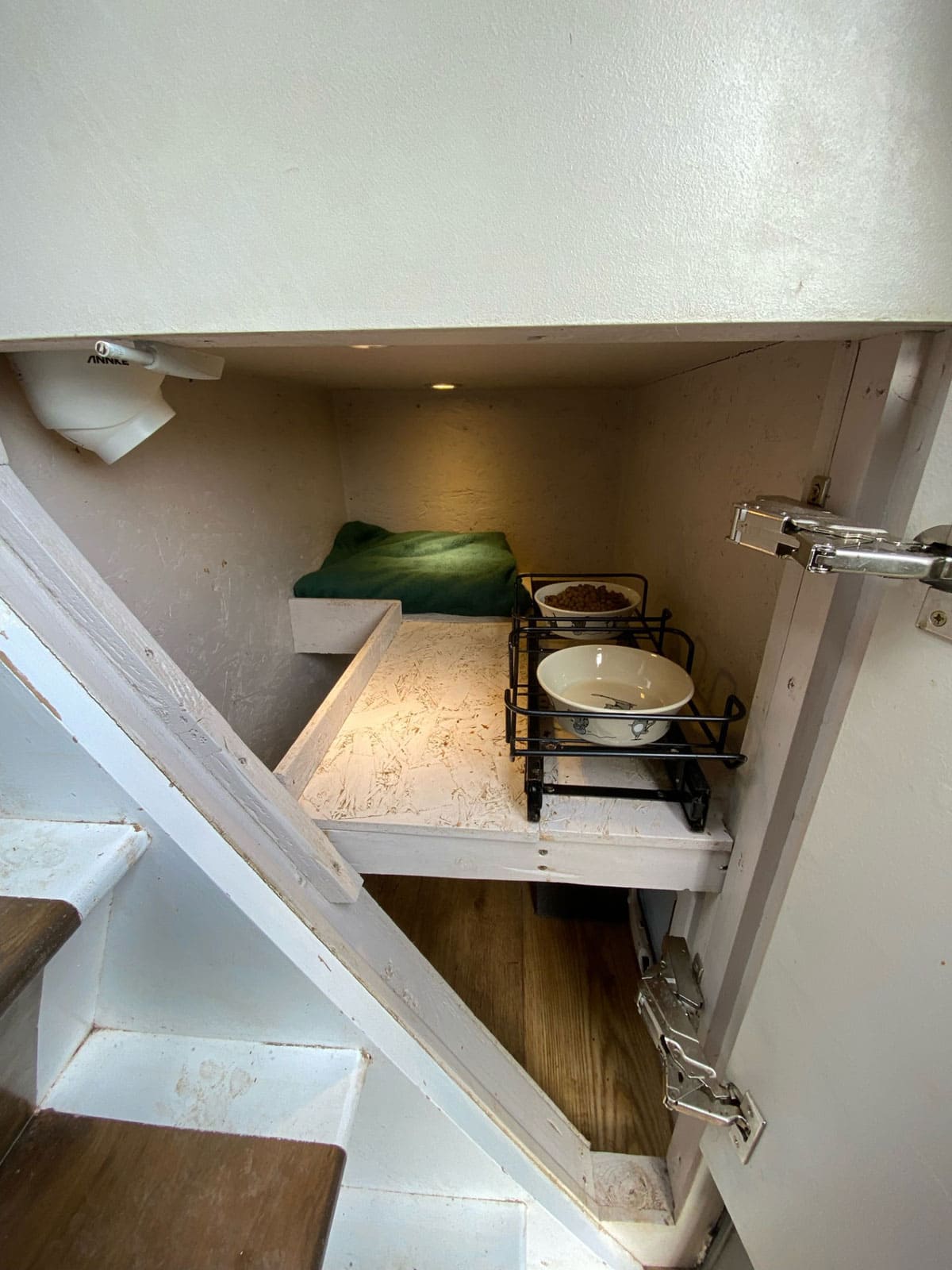

The cat’s private area in our bus.
Just as we couldn’t forget about our dogs, we certainly couldn’t forget about our cat either! We wanted a private space for him where he could feel safe and secure, especially for any future travels. After watching many videos for inspiration, we had the perfect spot…the old coach bathroom area. This was boarded over for extra kitchen space and to act as a floor for the dog's bed, underneath was a perfect space for the cat house!
It consists of two floors, a feeding station, a bed area for sleeping or comforting (although our bed is his preferred option), a litter tray, and a microchip-activated cat flap. He is also lucky enough to have his own lights and security camera to keep an eye on his activity. Access is needed to feed him and clean, so the door is a recessed push-to-open door located on the side of the staircase wall, coming in through the main door (side door).

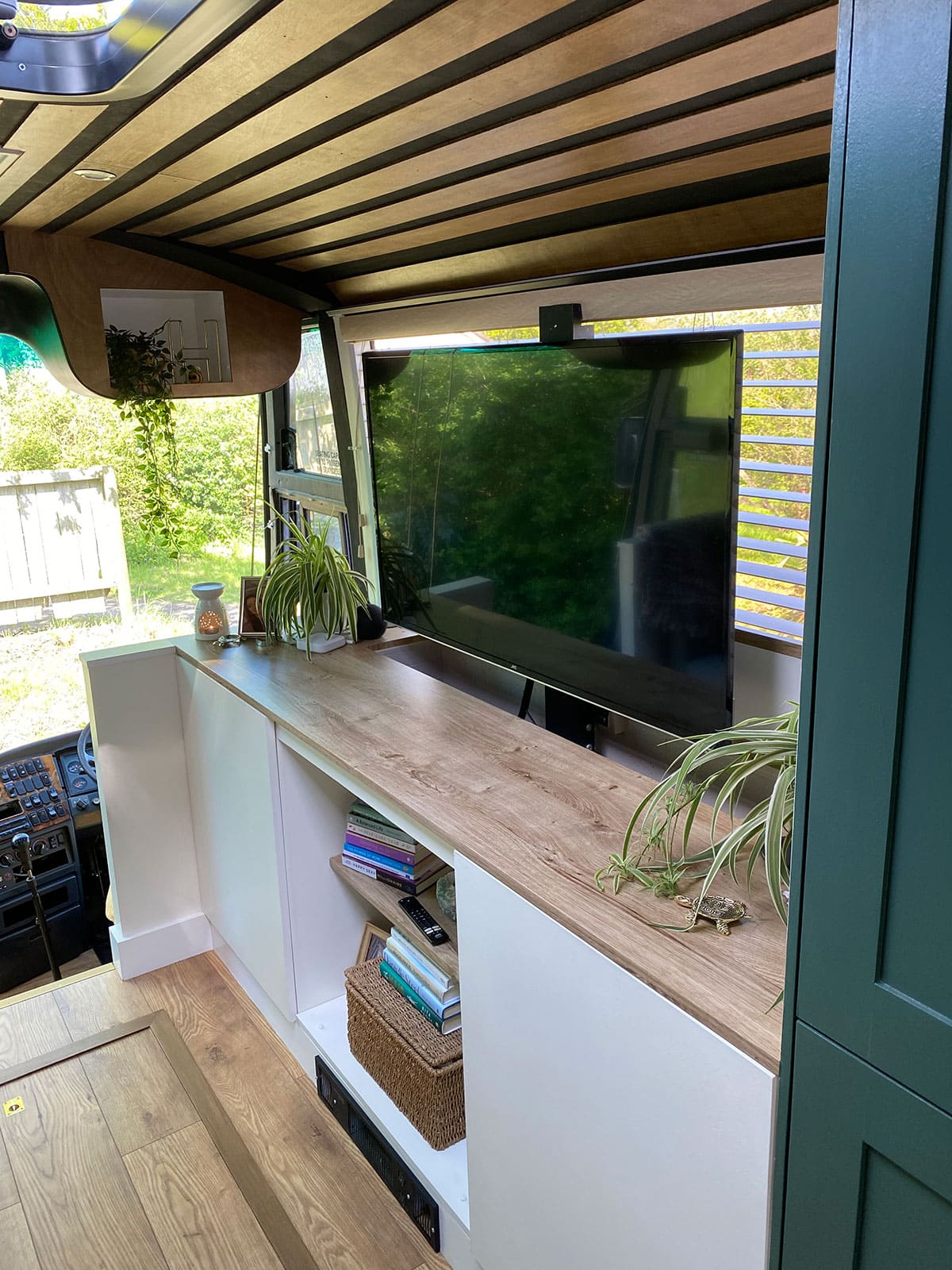

Moving on to the living room space located down at the front of the bus, where we had raised the floor level. We had a lot to fit into this area, but we have managed this with a custom-built media and storage unit. The unit is the whole length of the living room and butts up against the kitchen on one end and the back of the driver's seat on the other.
Located in this unit are two cupboards with shelves for storage. All the electronics i.e., computer, printer, TV aerial, sockets, and 4G router are nicely tucked away, not forgetting the TV which sits between the two cupboards and is fitted on a motorized rise and fall bracket.
This is perfect for us as when not in use, we have the full workspace free, then when the TV is needed it opens and rises from the back of the top using our remote! In front of the TV is a small built-in bookshelf, lit by LED lighting at night. Opposite all this is the sofa with a slatted feature wall presented behind it complete with hand-made custom brass wall lights for the finishing touch. These are also made and used for the bead headwall in the bedroom.

The major modification made on the bus was the roof. Originally there were two A/C units fitted on each side of the centre skylight. These internals were already stripped out when it came to us so the idea to remove them and open a whole lot of light seemed to be a great option.
The air conditioner units were removed, and plexiglass was installed to create the two new roof windows. They are situated in the kitchen/hallway and over the entrance door/bathroom areas. Other than a couple of additional skylights cut into the roof that’s about it for modifications to the actual bus other than the installation of four CCTV cameras located around the outside.

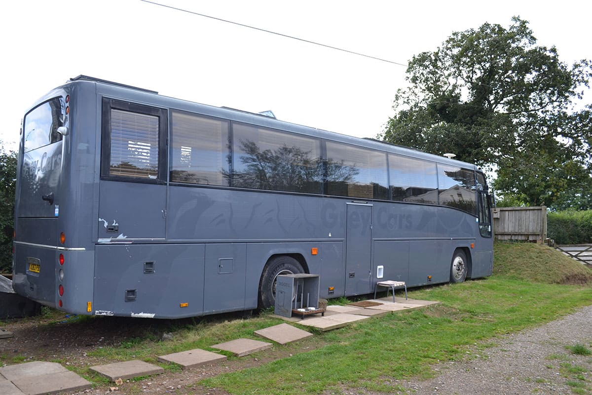

On the outside, there are a couple of inlet points, one for water and one for the electric hookup. On the same side is the gas fill input too. We decided to install a Gas-It system for ease of connection and practicality on the move, this means we can stop at any garage that sells LPG and simply top up our onboard propane tank. Or if being stationary for a long period and traveling to a garage for fuel isn’t easy, we can connect a bigger 47kg (103 lbs.) bottle to the outside and run our appliances from that!

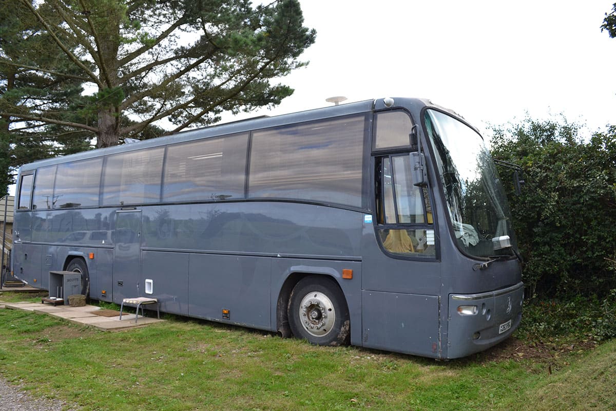

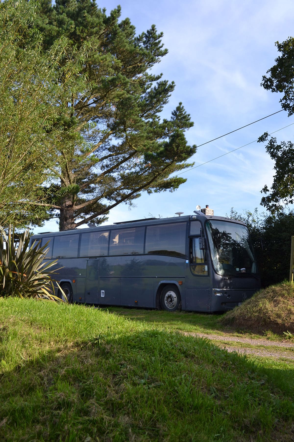

Hiding beneath the tree and hedge.
Ophelia awaiting her respray.
Profile shot of the bus.
