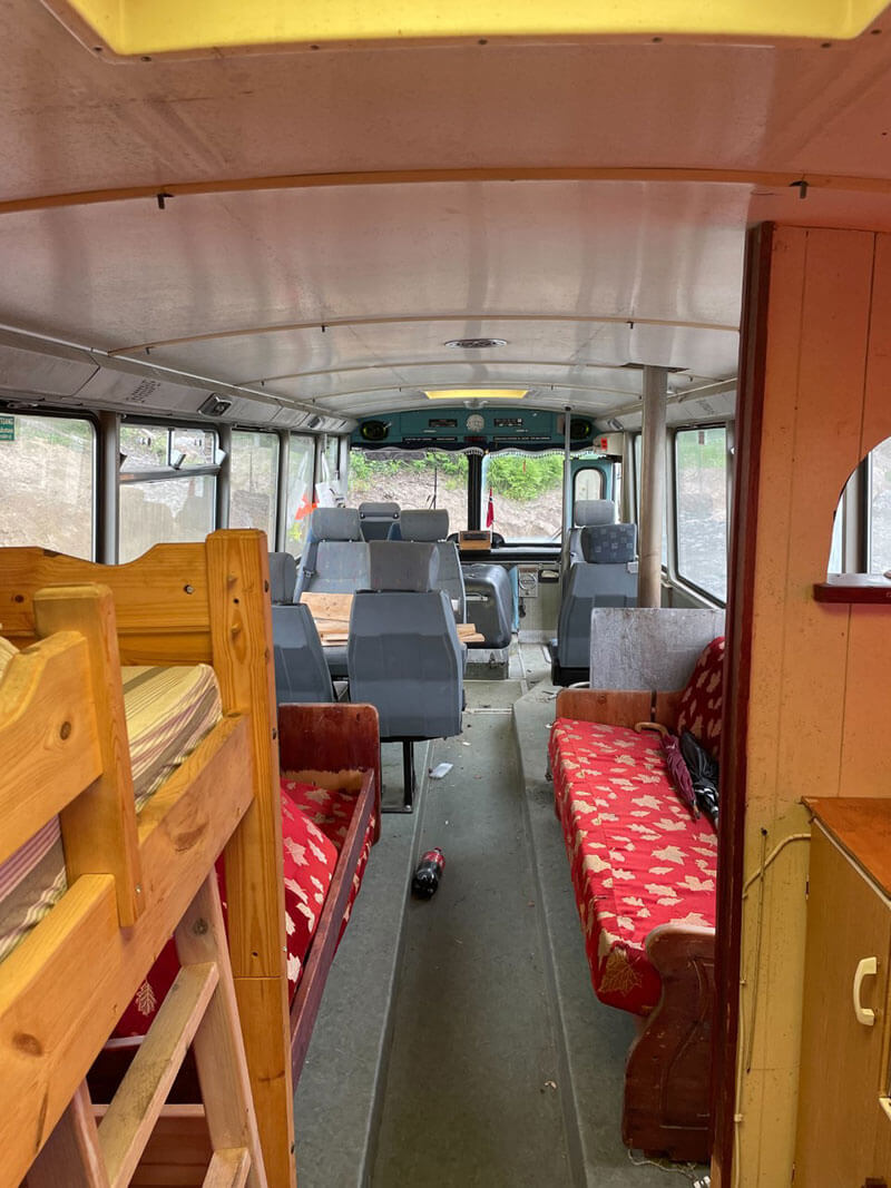

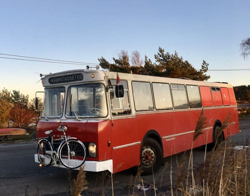

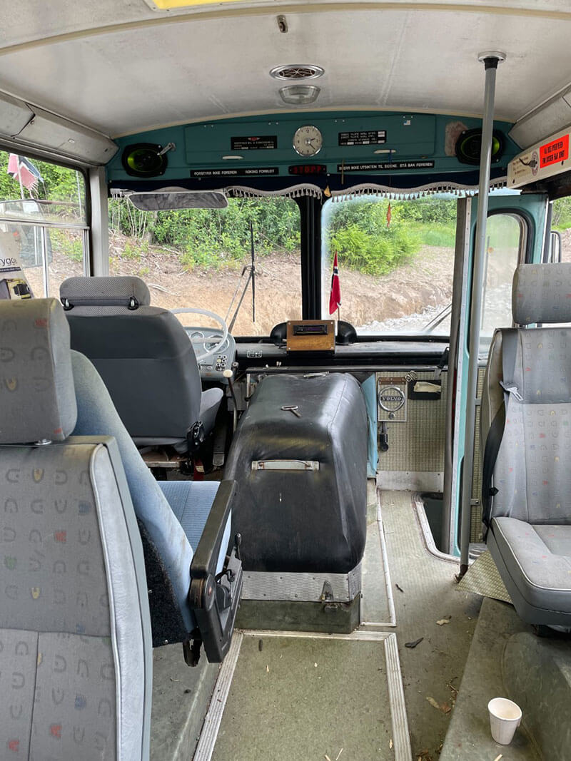

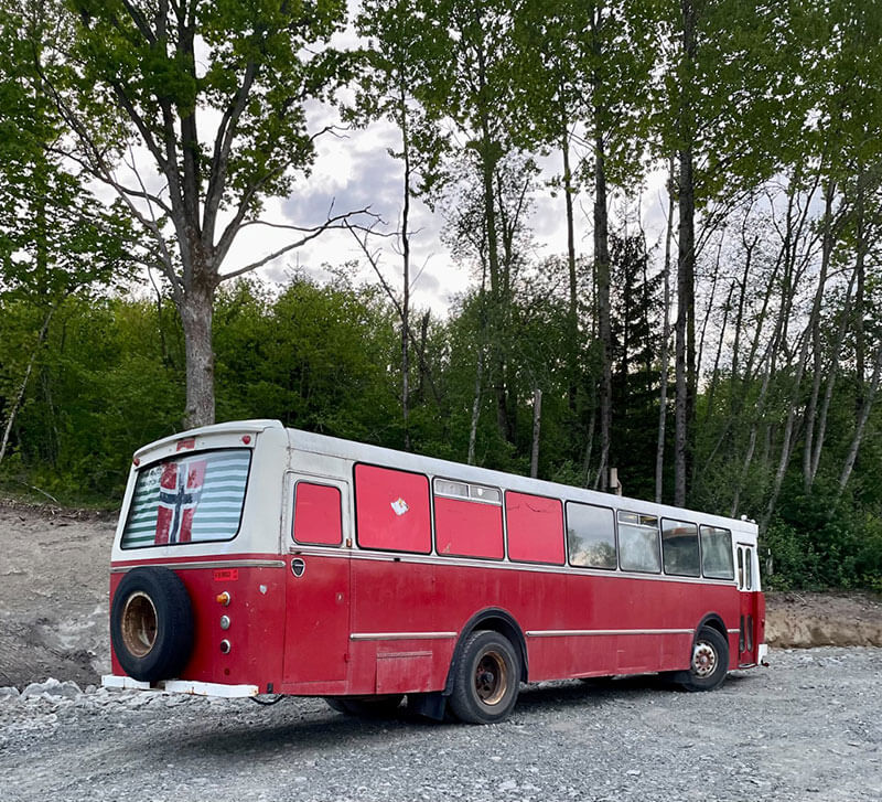

One night it all came to me. I was scrolling through the marketplace on Facebook when an old rusty bus showed up. It was quite rough, but the lines and style ticked all my boxes. It was a 1969 Volvo bus. It said it ran but needed some work to get it roadworthy and was approved by the Norwegian State Highways Authority. Neither my fiancé nor I had a bus driver’s license, but it didn’t bother me.
The bus as it looked when we got it.
Rear view of the bus when we got it.

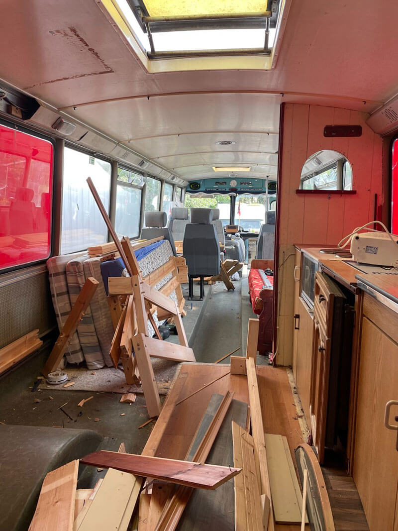

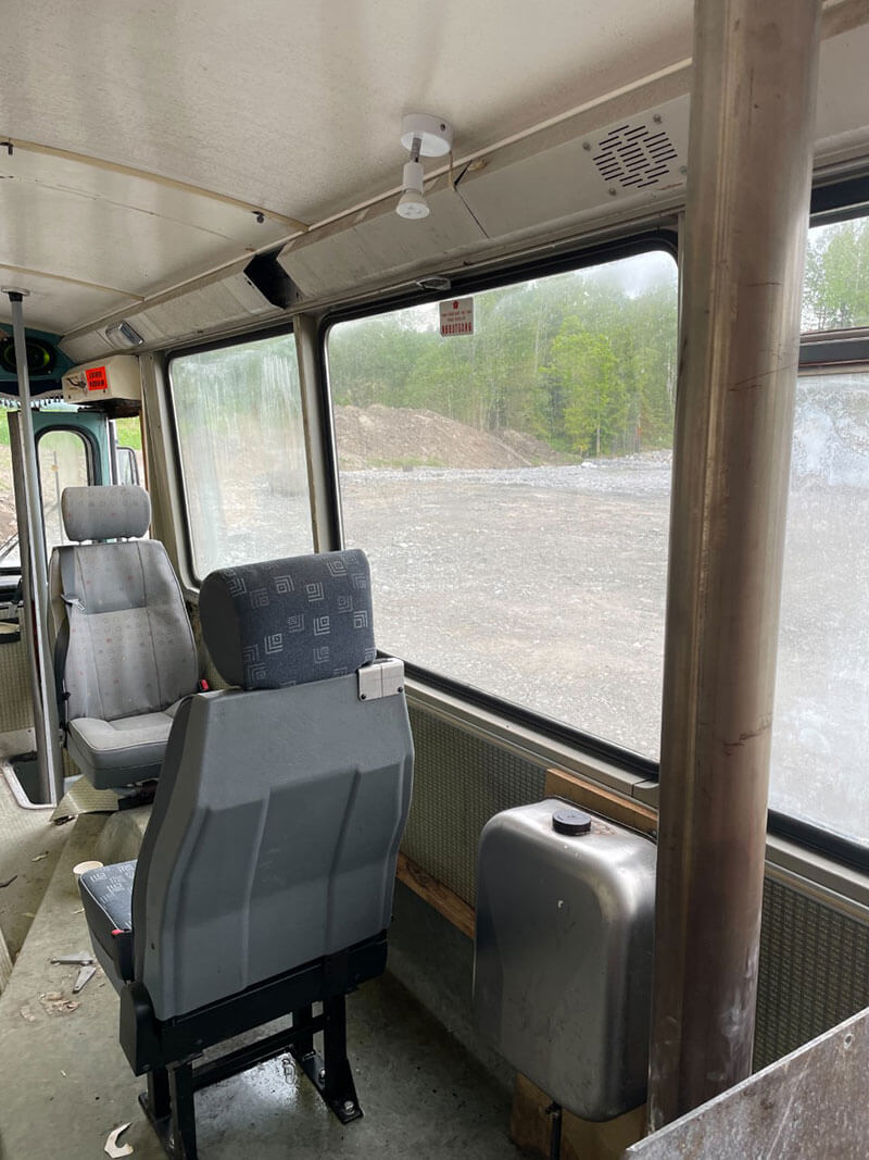

Minutes before we begin to rip stuff out.

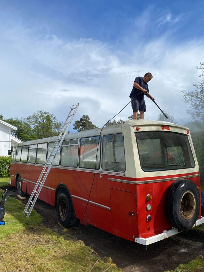

The roof is getting a most-needed power wash.

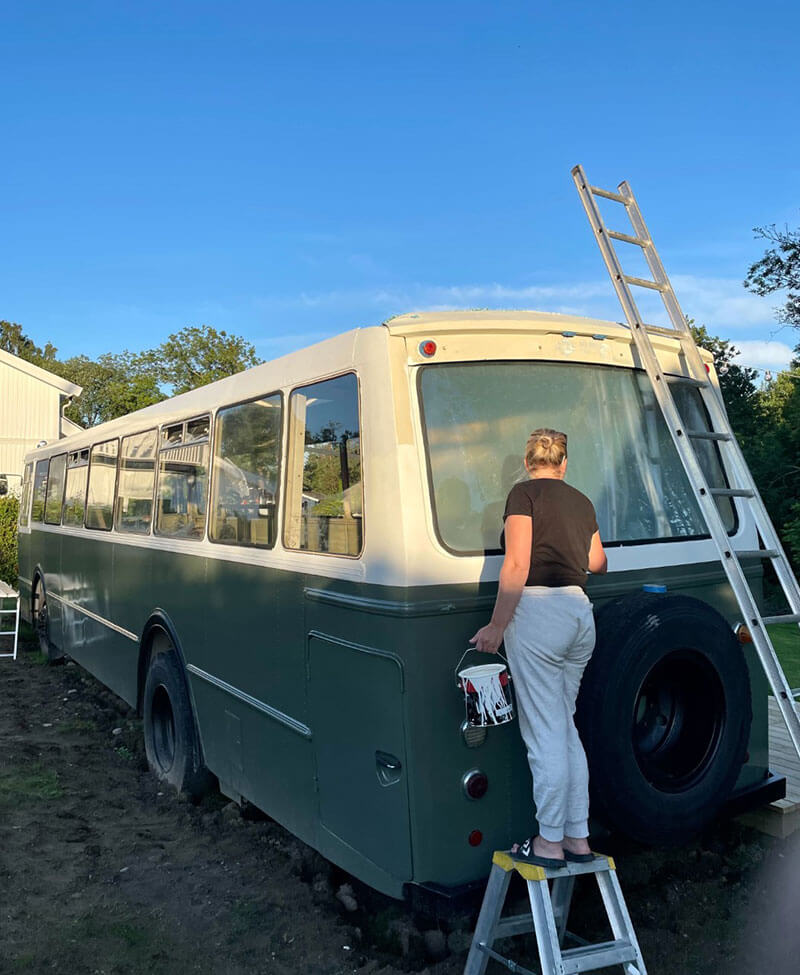

Irene doing some touch-ups.
Soon enough my fiancé was told and eventually shared my vision. She really had a hard time seeing it. With my day job as a carpenter, I have no problem seeing the end result in my head and I hoped she would come around. Things got worse when the bus got home on our parkway, my fiancé absolutely freaked out, “OMG, what will the neighbors say and think of us?” Yeah, she had a lot of anxiety about the bus. To help calm her nerves, we decided to paint the exterior as soon as the bus was driven down in our backyard, before doing any work on the inside.

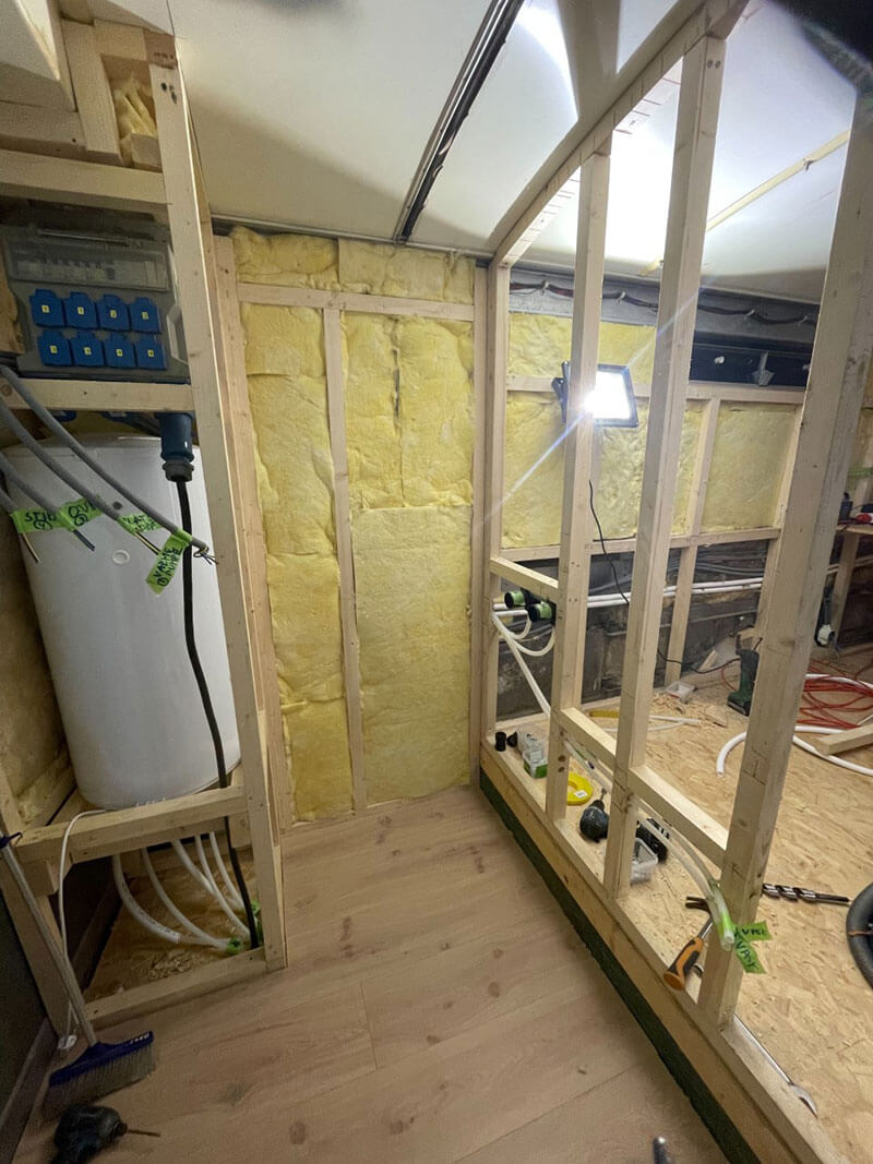

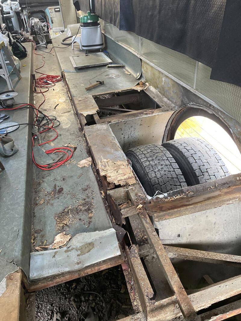

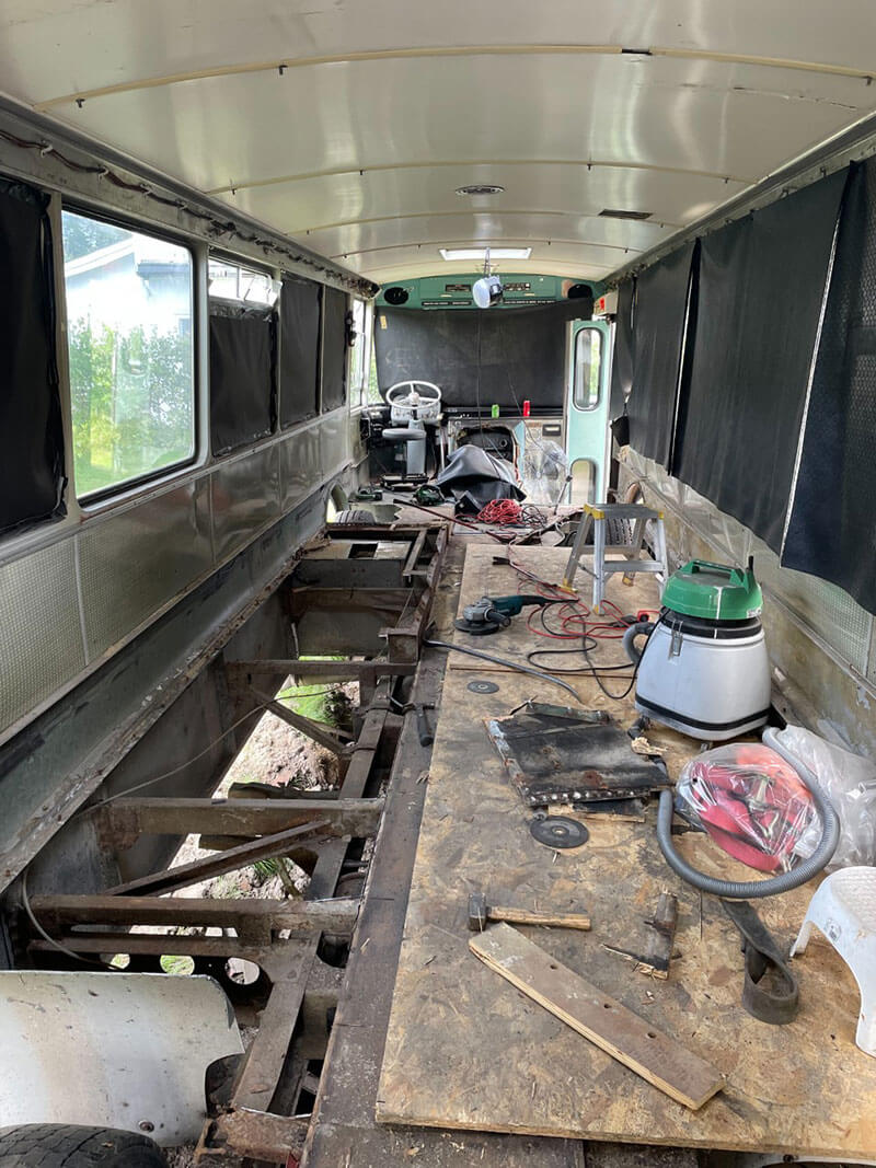

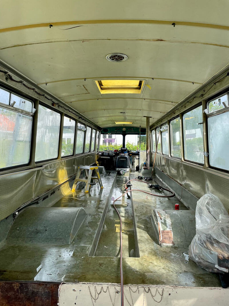

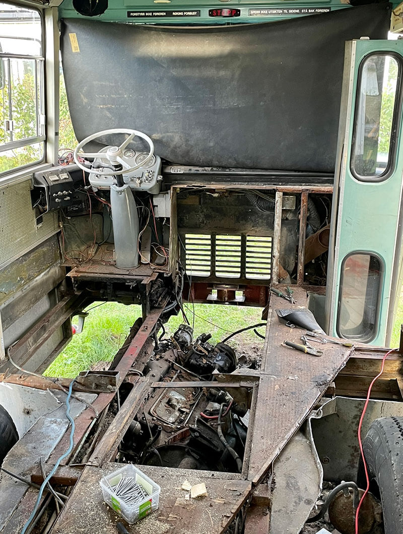

With all of that done, came the next obstacle. When stripping the bus, I realized the ceiling was going to be way too low on the inside if I was going to insulate it. At first, I imagined that we were going to renovate the bus and sell it but quickly my vision ended with the bus begging me to keep it… Stripping the bus to literally a shell of nothing scared my better half for weeks. The bus was kind of only my project now. It was around this time that I decided it was going to end up as an Airbnb bus.

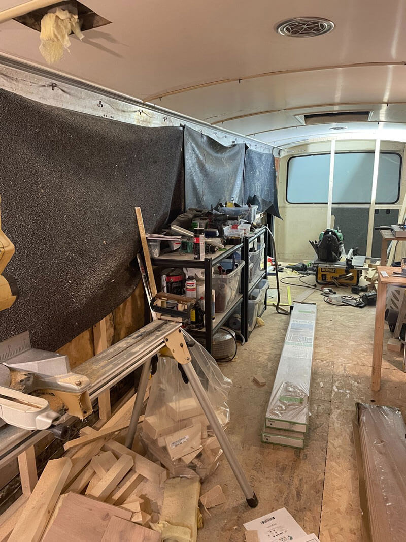

Here you can see the bus with insulation and subfloor. Throughout the whole underside of the bus, we installed a kind of flexible stone facade panels to mouse secure the bus.
The reason it would now be an Airbnb, was because the time, work, money, and layout weren’t worth it. To do this, I had a plan that was irreversible. I decided to remove the probably 500kg engine. With the engine gone, it would give a lot more space in the front of the bus. Maybe give room for an air conditioning unit for the hottest Norwegian summer days.

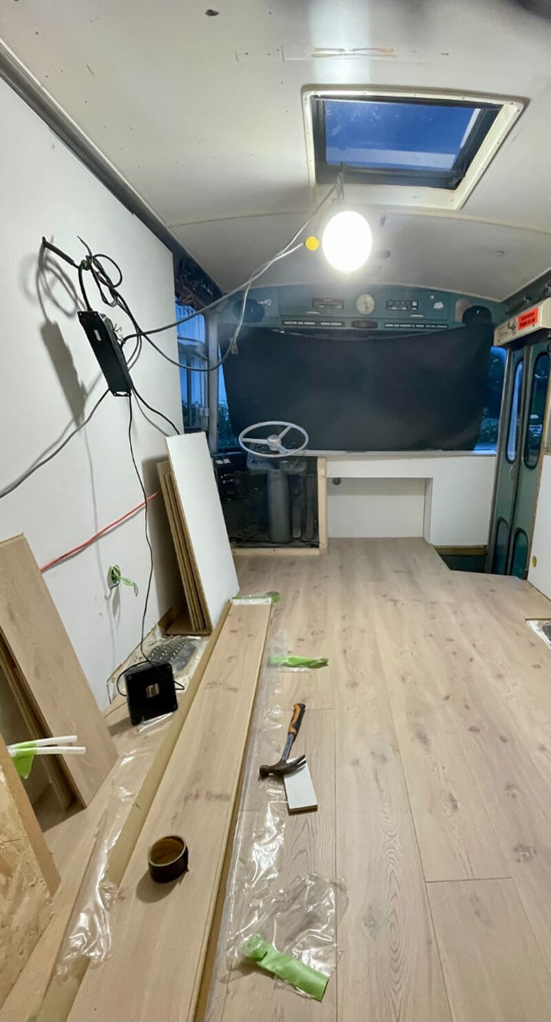

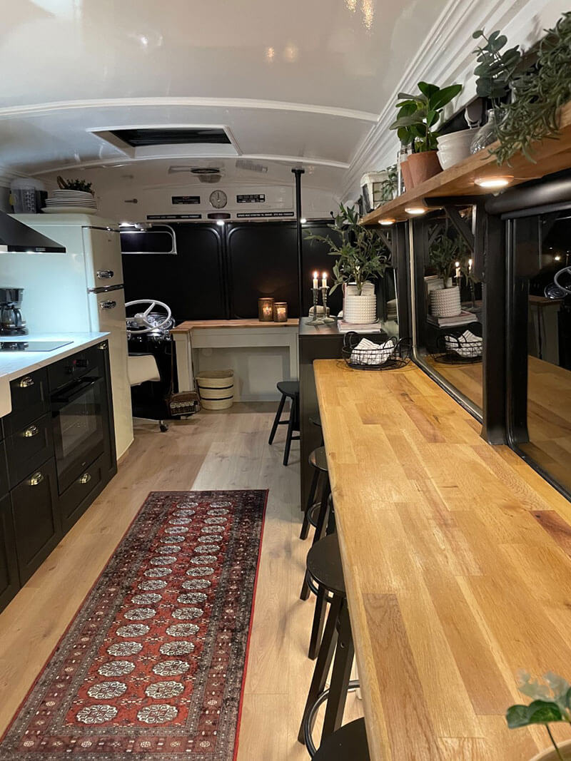

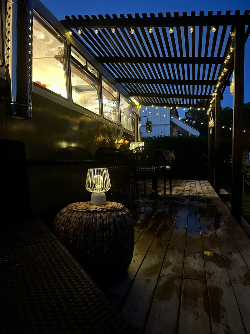

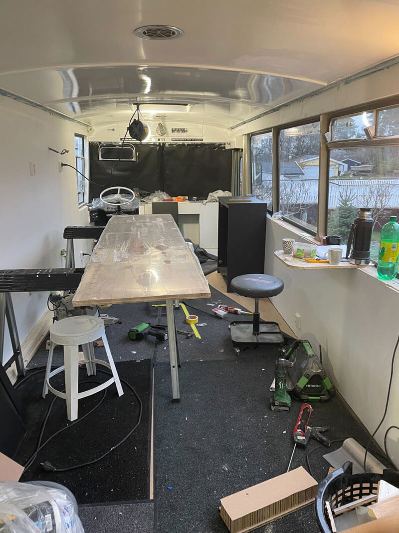

As soon as I began to close up and rebuild the bus my dearest showed up to help with the bus. We were now sharing the renovation and we were at full steam. We both have day jobs, so working on the bus could only take place in the evenings and weekends. It took us roughly five months with everything on the inside including some wood decking, planting hedges, and getting a wood-fired tub for our coming guests.

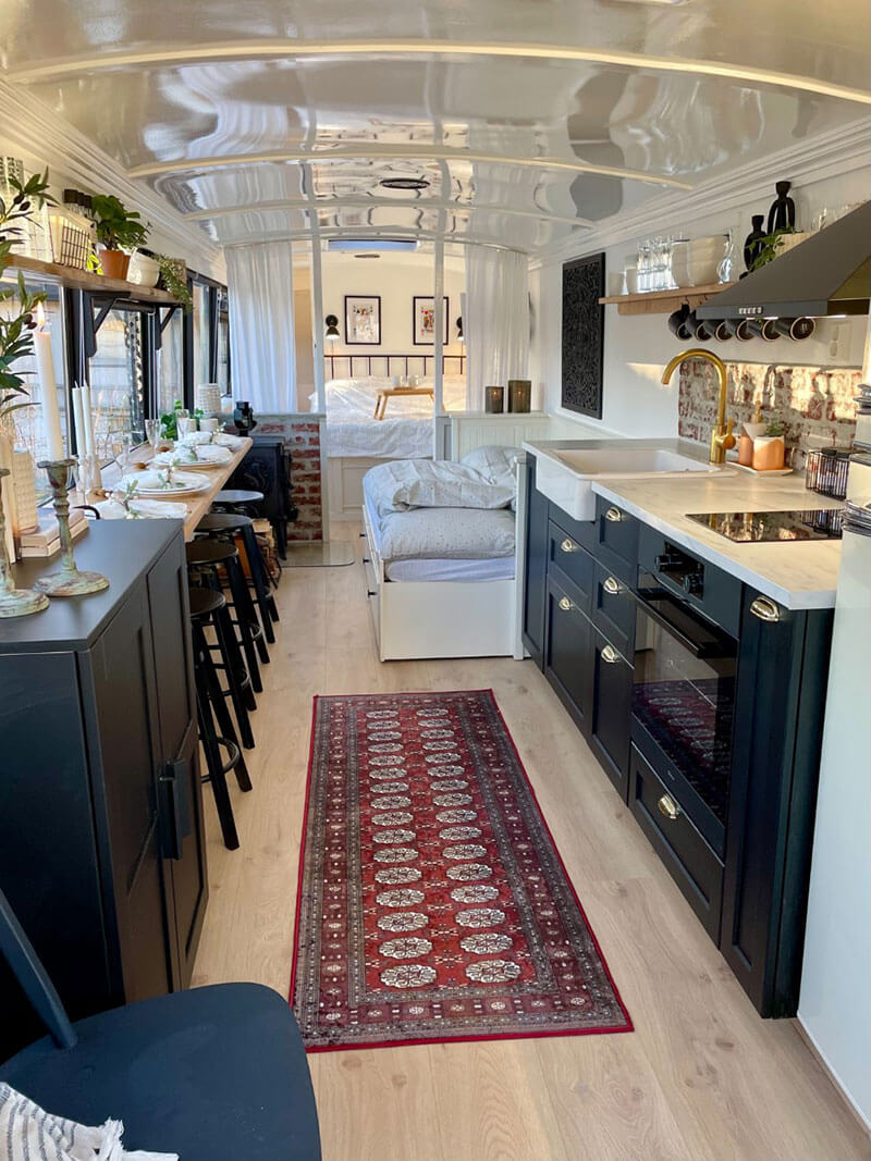

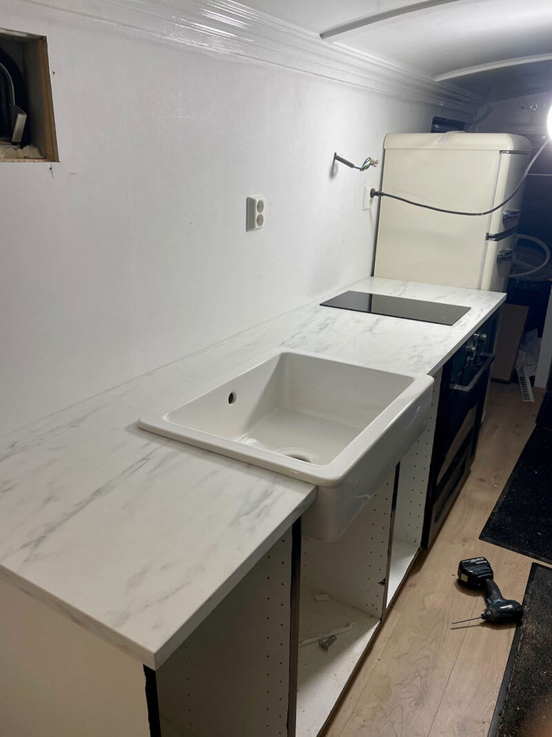

Much of the conversion is built off lots of used and old stuff bought on the Facebook marketplace. It was on a strict budget as with all our builds. With the bus being stationary we drained all fluids out of everything. The engine is removed so it won’t be an environmental hazard. The bus got “summer“ water, hot and cold, as well as a shower and toilet. It also got a queen-size bed and a daybed that turns into a 120cm (3ft 9in) bed.
We also got a freezer, fridge, oven and a TV. Nothing operates on gas, it’s all-electric from the regular power supply. We have some fun features for children if they’re staying in the bus. We have an authentic bus bag that was used at the time the bus was a school and city bus.

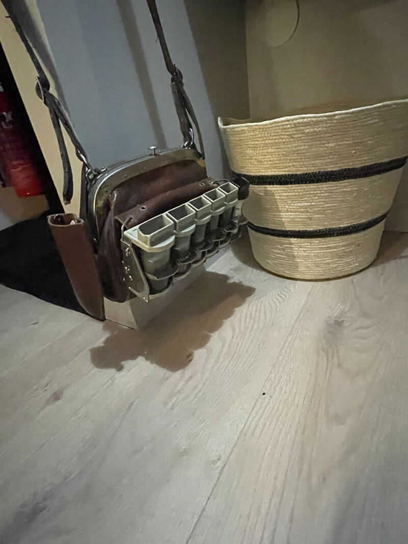

A Norwegian bus bag with a coin machine, filled with 1969 coins of the time.

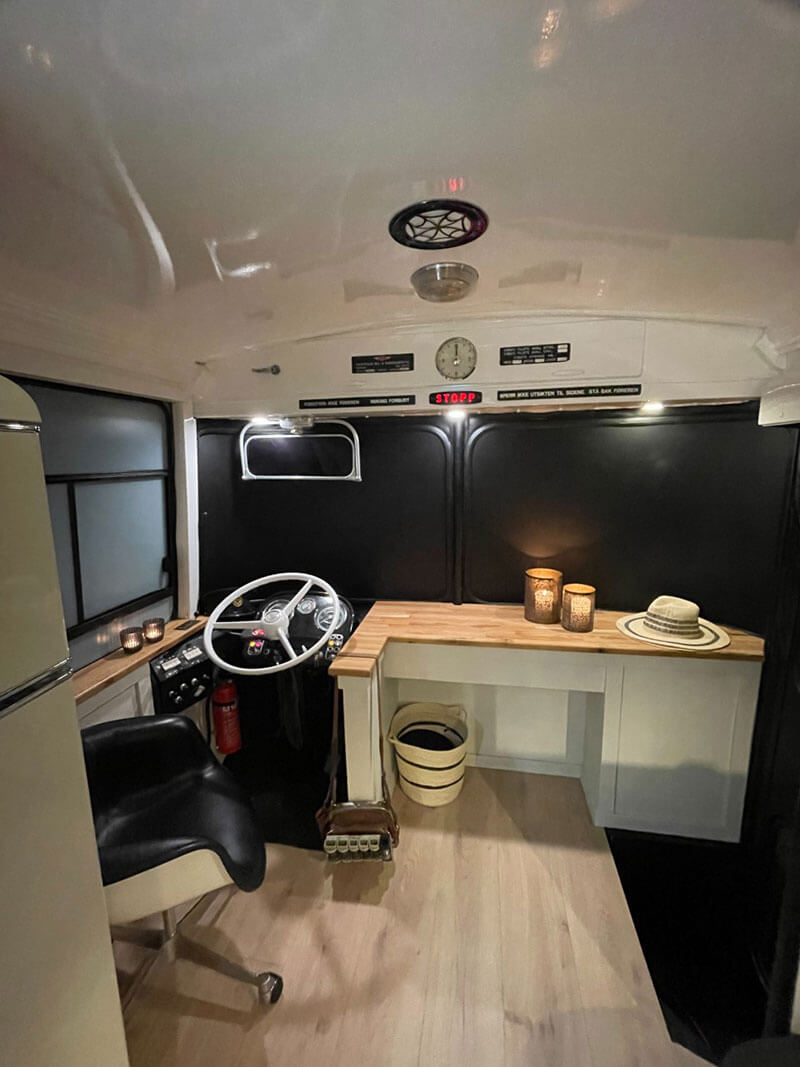

It has a coin mechanism that makes you press out real coins from the same year as the bus (1969). We also have some old bus hats. The bus ignition is also partly working. You can switch on lights over the dashboard/ bus driver. Turn on and off the stop light. And turn on all the outside lights at half power.

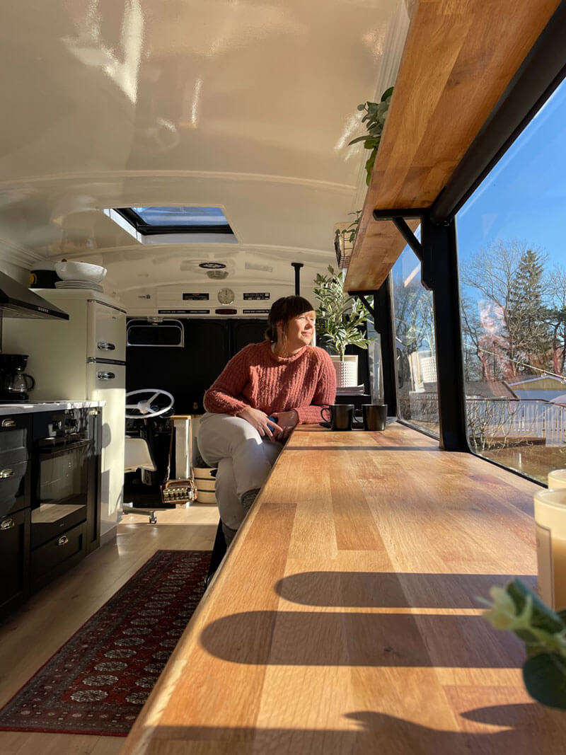

The interior queen dreams of summer.

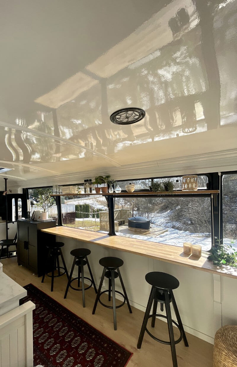

It seems we’ve been an inspiration for many of them. Now that’s quite a bonus and boost. The bus is now finished and is bookable on Airbnb, in Larvik, Norway. Just a couple of hundred meters from the nearest beach, the “Stavernfestivalen“ a famous Norwegian music festival and stunning Norwegian nature as well as city life. Larvik is about 100 kilometers (not even a mile) south of Oslo our capital.
The relaxing patio space outside the bus.
