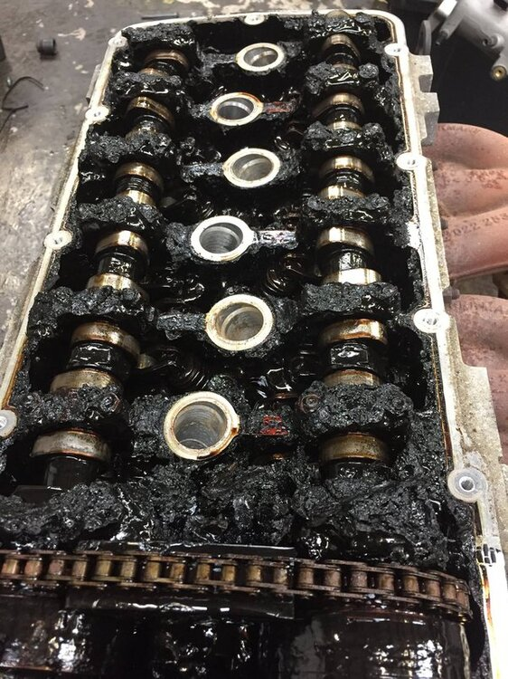

Post by: Gary Hatt - Publisher BCM
Do you mean like this?
Post by: CrabbyMilton
Whoa! That's almost as scary as looking at an Insect B movie.
