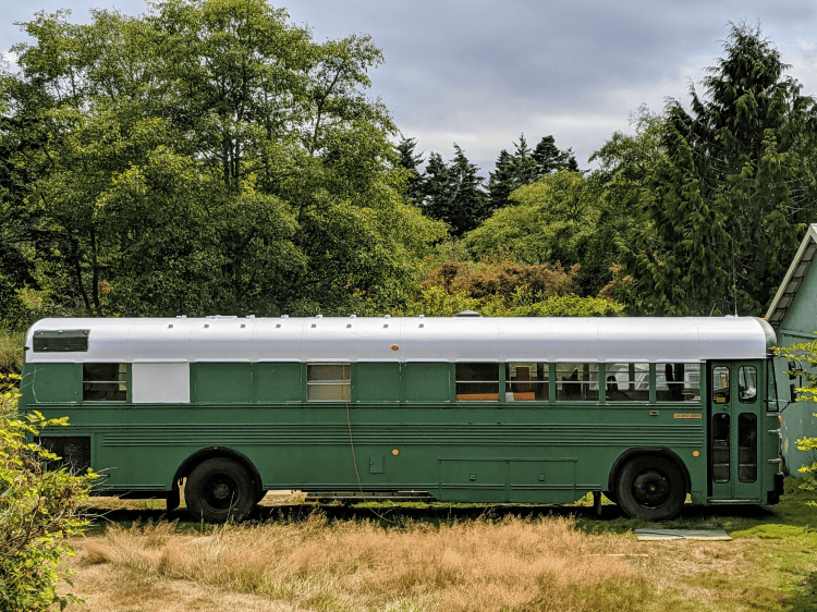

We painted our Skoolie with Behr House Paint five years ago. We used rollers and paintbrushes. We used two gallons for everything but the roof, which is painted with Henry's Tropi-Cool. The roof took two gallons the first time and another two gallons for a touchup a few years later.
The only blue part that needs touchups are a few places by the rub rails. Only the spots I didn't sand well enough the first time seem flaking. I posted a picture of the paint job five years after applying it.

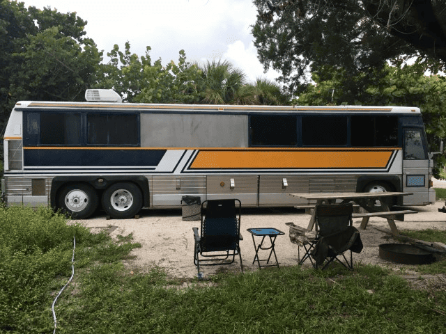

When I made the metal plates to fill the windows, I had steel cold rolled 16ga stock sheared, and then I bent the edges in a break to fit as plugs and dipped them in muriatic acid to remove all of the mill scale. Then, I used Pettit Rustlok primer from Jamestown distributors. After it was cured, I used a Pettit EZPoxy top coat with a hardener. I installed the window metal plates using polyurethane sealer and then painted the polyurethane sealer after it cured. I also rolled and tipped the whole bus.
