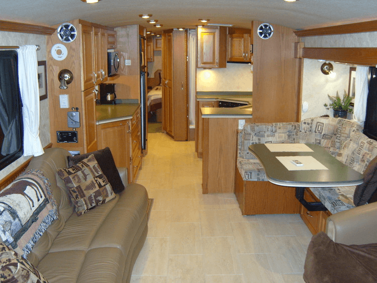

If you were to convert a bus from scratch, knowing what you know now, would you build it with a Side Aisle or Center Aisle to get to the Bedroom and why?
Post by: dtcerrato
Center Aisle as we did ours. One of the advantages is further insulating of the side exterior walls lends to better HVAC, shallower storage on both sides instead of deeper storage on one side, more options to passageways from bottom compartments to the main cabin, and our list goes on.
Post by: luvrbus
We had a short side aisle at the bedroom.  We had that layout to have a large bedroom closet facing forward, and a refrigerator that faced forward not sideways.  Along the wall, my wife wanted a kitchen and bathroom, which meant you had to have a side aisle.
Our current RV has a semi-center aisle, and my wife doesn’t care for it much because the refrigerator is not forward facing.  It is easy to raise the roof on the Eagle buses, so you will see a lot of side isles in the Eagle coaches.  The inside height dictates the type of isle; in the older buses, you may need a side-isle unless both are short people.
Post by: thomasinnv
My first bus had a center aisle.  The second bus is a side aisle layout, and if I ever do another one it will have a side aisle as well.  I would much rather have a private bathroom and not have to go thru the bathroom to get to the bedroom.
Post by: dtcerrato
Our center aisle bus layout has a full private bath all on one side.
Post by: luvrbus
Center aisles do make for smaller bathrooms and are usually split.  Sonja doesn’t like that in our current coach.
Post by: Jim Blackwood
I put the shower on one side and the toilet and vanity on the other. My doors are set up so that you can close off just the small bathroom and leave the aisle and shower open or make it one big bathroom.
Post by: luvrbus
Our setup is about the same except we have a large vanity in the bedroom area also.  We have plenty of room in the bedroom for the king-size bed since it has 2 slides.
Post by: sledhead
My 1st coach had a side aisle.  The coach we have now has a center aisle.  We liked the side aisle better as it made a nicer layout.
Post by: tr206
In my case with an Eagle, a center aisle helps in case you need to remove the access panels in the floor.
Post by: Gary Hatt - Publisher BCM
One advantage of a center aisle is that if you have roof A/C units, which are almost always on the center line of the roof, like I have in my Eagle, and the air seems to flow better between rooms.
But the side aisle affords more privacy in the bedroom and may be better if someone is an early riser, whilst the other mate is not.  But then again, a door in the middle aisle will do about the same thing, right?
And yes, if you have a center aisle, you will have a split bath, but is that all that bad?  With a split bath, one person could be using the commode, and another one taking a shower at the same time.  The other disadvantage of having a split bath is that you may want to add two exhaust fans. One for the commode area and one for the shower to suck out the moisture.  But fans are cheap anyway.
Another disadvantage of a center aisle, as noted above, is that if the bathroom is occupied, no one can access the bedroom, which may or may not be a deal breaker.  And correct, you can put a door on each end, so you end up with one extra large bathroom if you like.
Good point about the center aisle allowing more insulative air space between the outside walls and the living area.  It may not make a big difference, but everything helps.
