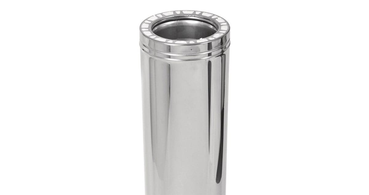

Ensuring your chimney is properly constructed and has UL-listed stove pipe going through the ceiling is important. Several stoves today can use 3" or 4" pellet stove pipe, which started with the Kimberly model and has continued with the KatydidTM and KrikitTM models. This type of pipe, however, CANNOT pass through a wall or ceiling.
It is imperative that the pellet stove pipe travel through a section of Class A pipe, as shown below.  Class A pipe provides an air barrier between the hot stove pipe and combustible materials.  Failure to follow these instructions can and will start a fire in your rig.
Class A Stovepipe.
Class A Stovepipe.
