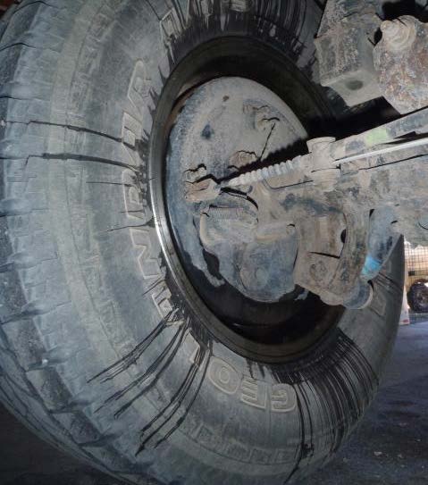

- Tires should be in good repair, have no cracks, be less than seven years old, and preferably be equipped with a TPMS (Tire Pressure Monitoring System). Look for cupping, uneven wear, and other signs of abnormal wear and abuse. Check tire pressure and adjust to the tire manufactures suggested pressure for the weight on each axle. If the tires are showing abnormal signs of wear, take it to a bus alignment shop and have it checked out.
