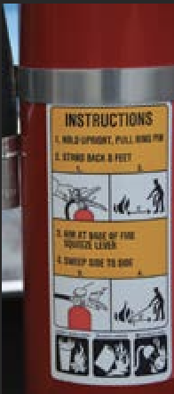

- Go on the internet and learn how to use your fire extinguishers (The PASS method seen below, is a good starter).

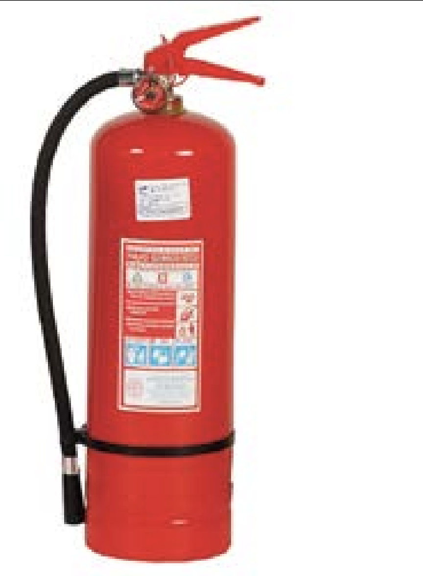

This is a photo of an Amerex 2A:10BC fire extinguisher. They are also available on Amazon for around $35. The ABC-rated fire extinguisher recommended above is adequate for a typical fire in an RV. The two extinguishers may cost up to $100 with shipping, but you will be adequately prepared for this common disaster.
Amerex is a good quality fire extinguisher, but there are others. Find one that suits your needs and your budget. There is no particular need to buy a halogen or CO2 extinguisher for your use. They are more for commercial applications and are pricey.

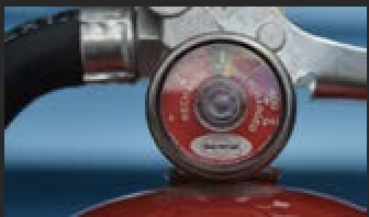

Clockwise from left: Instructional placard demonstrating proper use. Pressure gauge as it should look when fully charged. Ratings label that shows the ratings of the extinguisher.
