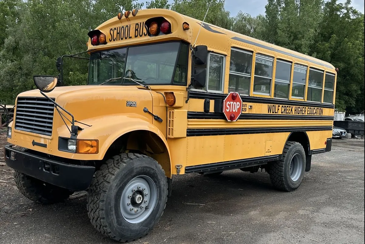

Used School Bus for Sale. Great for boondocking.
Once you decide what length bus you are interested in based on your needs, your next step is finding the right bus to convert and what to look for. Every basic bus conversion costs about $75,000, and it can go up from there. That is just for the interior buildout and does not include any work to the shell. If the bus has body damage or rust, it can easily double the basic conversion cost. I did so for me on the RTS and Spaceliner I converted. Both were cheap buses to start with and the Spaceliner was free. Rust is usually not as much of a problem with school buses. All the ones I went through were rust-free.

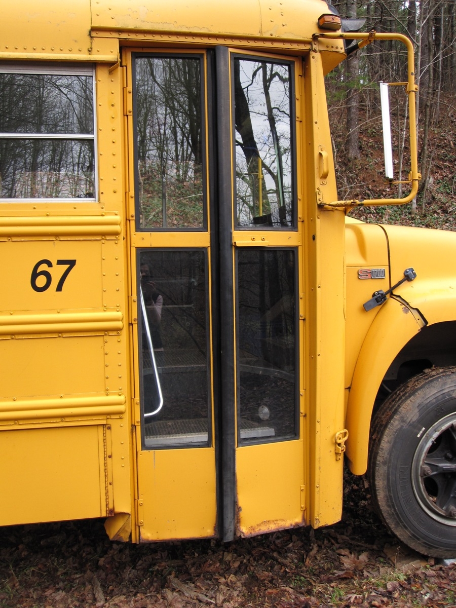

On the inside, check how much work it will take to change the entrance door, or can you live with the bifold door that came with the bus? Most people enjoy driving down the road with the door open for fresh air, which you can do with a bifold door.
How easy will it be to remove all of the seats if they are still in the bus? Removing seats can be a real pain if it is an older bus due to rusted bolts. The bolts may have to be but off using a grinder.  If you can have the seller remove the seats, it will save you the hassle of doing it yourself, and you won’t have to dispose of a pile of seats. Seats are hard to sell, and many end up in the landfill which can be expensive to dispose of, unless you repurpose them as Mary did in this article. Besides, they may be able to use them in another bus if they are in decent shape.
Bifold Doors can be opened when driving for better air circulation.

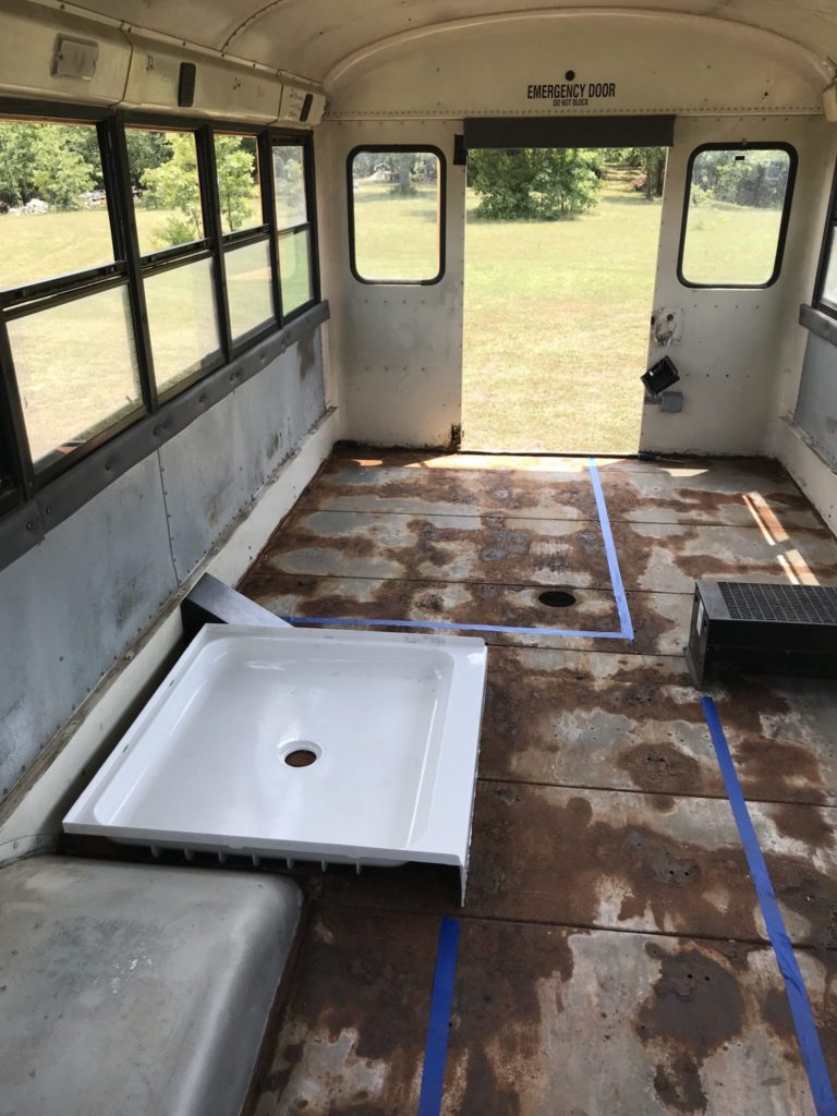

Is the floor soft and spongy?  If it is, it is probably water-damaged and either rotted or rusty. Can you see any signs of water leaks from the roof and windows? Does it have a flat floor, and if not, how far do the fender wells protrude to the inside?  The more they protrude, the harder it is to build cabinets and furniture around, which is not an issue with an over-the-road bus which have flat floors.  Are the walls straight, and is the roof flat and square to the walls? Curved walls and roofs caused by leaks and rust will add to the work required before you even start your conversion, delaying the date you may plan to take your first trip.
Rusty floor.  You must remove all rust before starting, which can be very time-consuming.
Rusty floor.  You must remove all rust and seal all floors before starting, which can be very time-consuming.

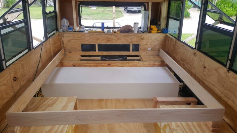

Fresh water tanks are not as problematic as they can be located under the bed or sofa. You can easily fit a 110-gallon tank under a double bed between the wheel wells. They can be drained with a ½” diameter hose, unlike a gray or black tank that requires much larger plumbing. Of course, if you have a rear-engine bus, you may have to remove not only your bed but also your fresh water tank to access the top of the engine, making engine access more challenging and time-consuming.  However, if the tank or plumbing starts leaking above the floor, it can create a lot of water damage. Whereas tanks in a bay in an over-the-road bus will not damage as much if they start leaking.
Water tank fits nicely under bed.

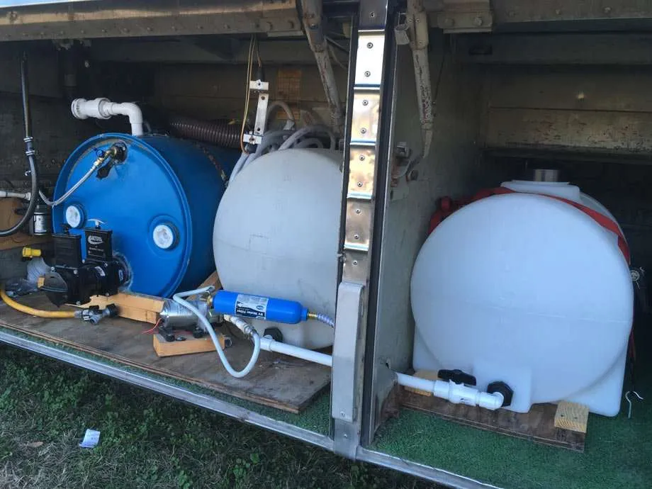

Gray and black water tanks can be more problematic.  The black water tank must be positioned more or less under the toilet.  A straight drop is recommended, but you can add an elbow and a short pipe under the toilet if the tank has to be shifted off to one side a little bit. But anything that impedes the flow of “solids” will require more water to flush them into the tank.  When boondocking, this can be a concern. This being said, the toilet is one of the first things you position in a bus conversion.
The gray water tank can go almost anywhere, but the preference is to locate it as close to the shower and sink drains as possible.  If the drain lines get plugged up as they sometimes do, the less piping you have to deal with, the better.  However, the bottom line is that water only flows downhill, so both the black and grey water tanks need to be placed below the floor unless you want to deal with a pumping system to pump the liquids and solids to a tank above the floor.  Which, if they are above the floor, they also take up floor space.
Tanks in a bus bay are protected from the elements and can be heated.

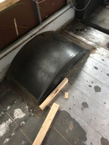

The other drawback with converting a school bus, as noted before, is the wheel wells.  Almost all school buses have wheel wells, whereas coaches are built with the floor higher off the ground, so there are no wheel wells to build around.  Wheel wells are also often an area you need to check for rust as they tend to rust out before anything else on the bus because of the tires slinging dirt, salt, rocks, and other debris against them when traveling.  Many Skoolie people have to rebuild their wheel wells before they can start their conversion.
When building cabinets etc., round wheel wells have to be built around. Storage space that would be available under a sofa is not available if you have a wheel well in the way. Also, if you buy furniture, you are limited in where it can go in your bus.  Anything fitting around the wheel wells must be custom-made.  Building around it is not a problem, but it is one more obstacle to deal with, and you have to be concerned about leaks that may occur while driving on rainy days.
You also need to ensure that the wheel wells are completely sealed before you cover them; otherwise, you may see little puddles around the cabinets or whatever you built around your wheel wells. Again, this is another issue you do not encounter when converting a coach-type bus.
Wheel wells must be sealed completely and boxed in to work around easily
