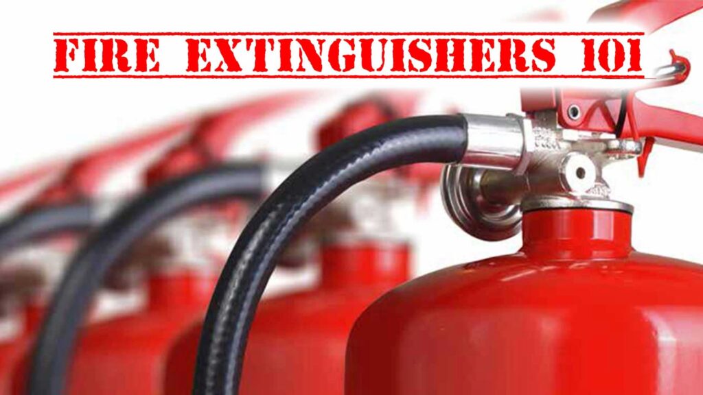

Fire Extinguishers 101

The best construction of a good reliable fire extinguisher should be metal to metal contact where the pressurized tank is attached to its operating hardware, and is very difficult to fracture. The gauge can be plastic but little else. Further, small and lightweight fire extinguishers do little for you in the control of most fires. The small fire extinguishers found in a typical RV might extinguish a small fire in a wastebasket. But if it has gotten away from you at all, scram the heck out of there. Grab your spouse and animals, if you can, and get out.

There is nothing complicated about taking care of your fire extinguisher. However, these words assume that you have an ABC rated, dry chemical fire extinguisher, in a metal tank, with metal workings. The little plastic ones do not need any maintenance and cannot be recharged if used.

  • At least once per month, examine the extinguisher as follows: Check the pressure gauge for a full charge. The needle should be in the green area on the gauge. They are very good at holding pressure for years, but if the needle shows in the red, the extinguisher should be recharged. The trigger should be held away from accidental operation by a hindrance pin. In the old days, the pins were secured by a lead and wire seal. Lately, the hindrance pin is held in place by any number of plastic or composite seals. Just make sure the pin is in place and sealed. Next, look at the hose and nozzle. If it is exposed to frequent sunlight, the hose could be cracked and weakened. If so, have it replaced?
