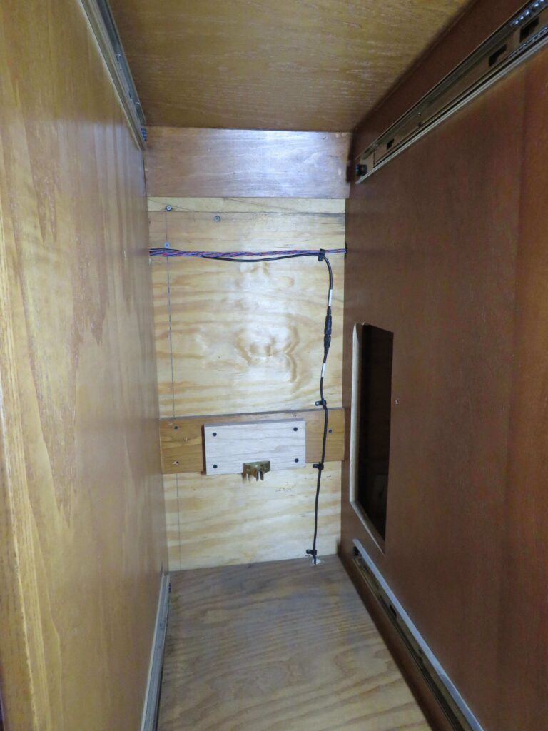

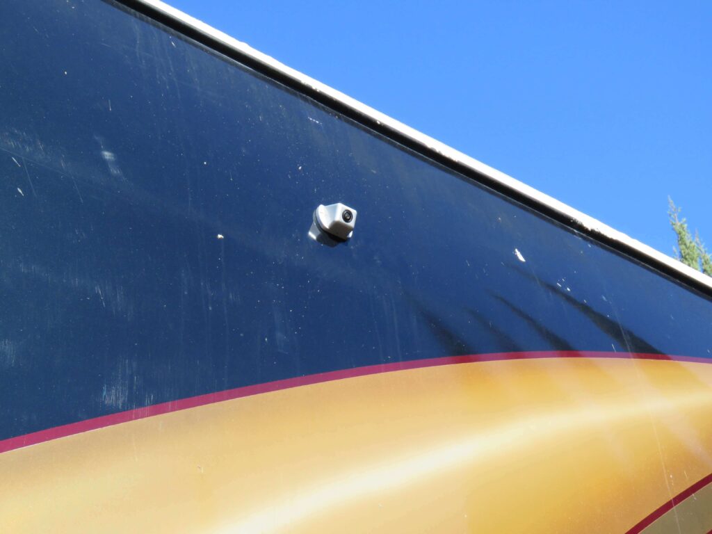

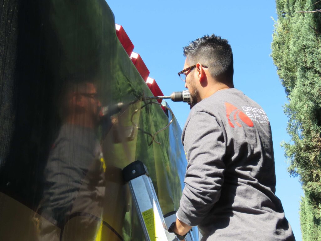

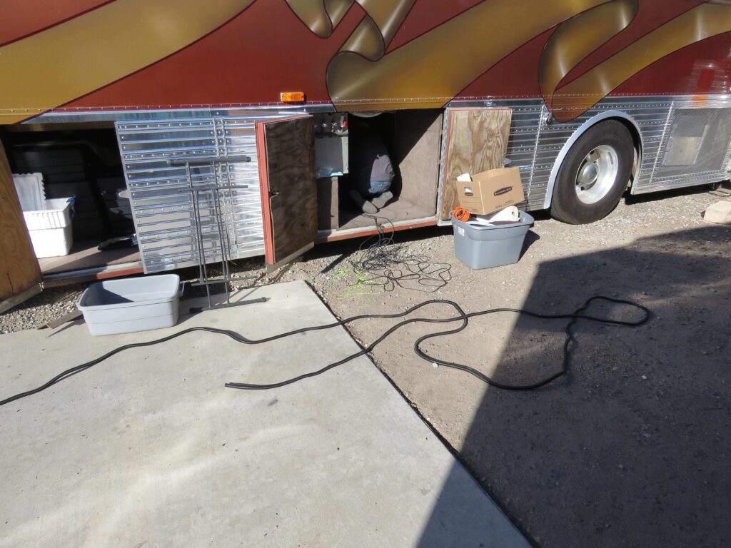

Installing the cameras is relatively simple, but can take an entire day or weekend if your bus is already converted. This is a hard-wired system. Wireless systems are not as reliable and if/when the batteries get weak, you could lose one or more of your camera signals. Wireless systems also sometimes have a time lag, so you may not be seeing everything in real time. Therefore, I chose to go with a high-quality wired system to provide the best image.
The cameras are mounted on each side of the coach just below the roofline, except for the front camera, which in my case, is mounted below the windshield due to the shape of my custom-built front cap. This can vary depending on the design of your bus.

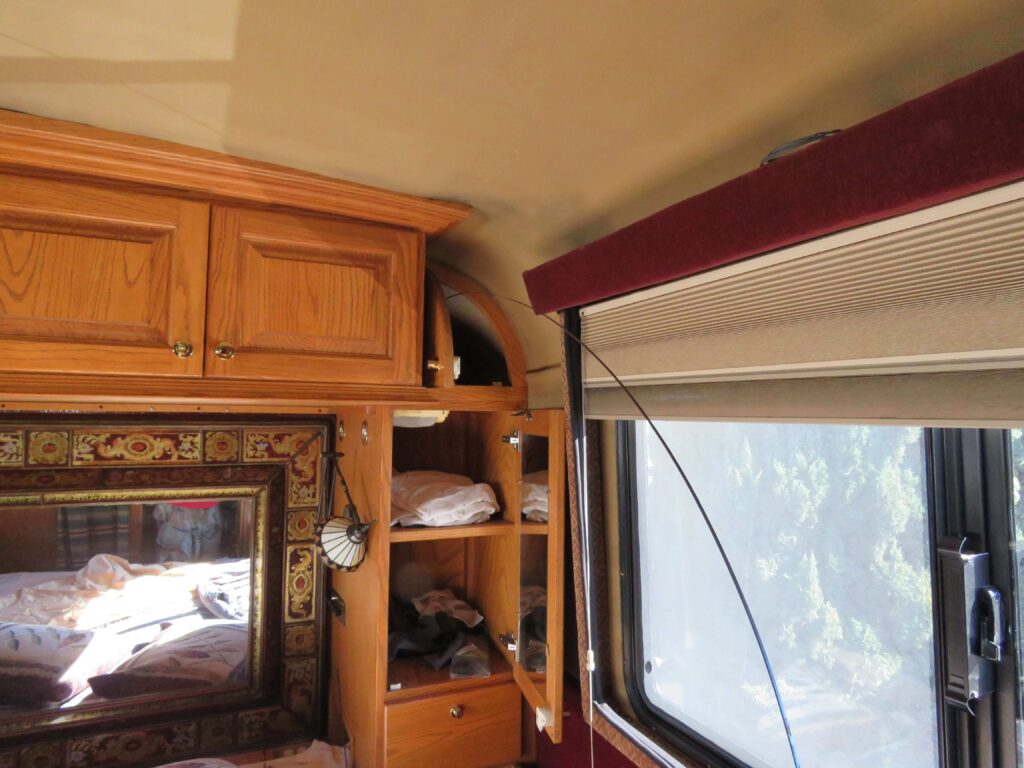

You will need to run the wiring to the cameras. through the cabinets, maybe even behind the refrigerator, up the rear wall, behind your bed, or behind whatever else is in the way, and also snake the cables up through the bus bays to the driver’s cockpit where the computer and the display monitor is mounted.
I Can See Clearly Now - With My 360 OmniVue Vision Camera System - bus conversion photo
Running the cable inside the pantry cabinets.
Running the cable inside the bedroom cabinets using a snake.
Running the cables is very simple in a new conversion but is a bit more challenging for an already converted coach like mine. It is not that difficult for the average handyman, as most Bus Nuts are, as there are usually cabinets behind where each camera is installed that you can access. Wiring is not that difficult with a few common tools and the cable can be hidden out of sight so nobody will even know it is there.

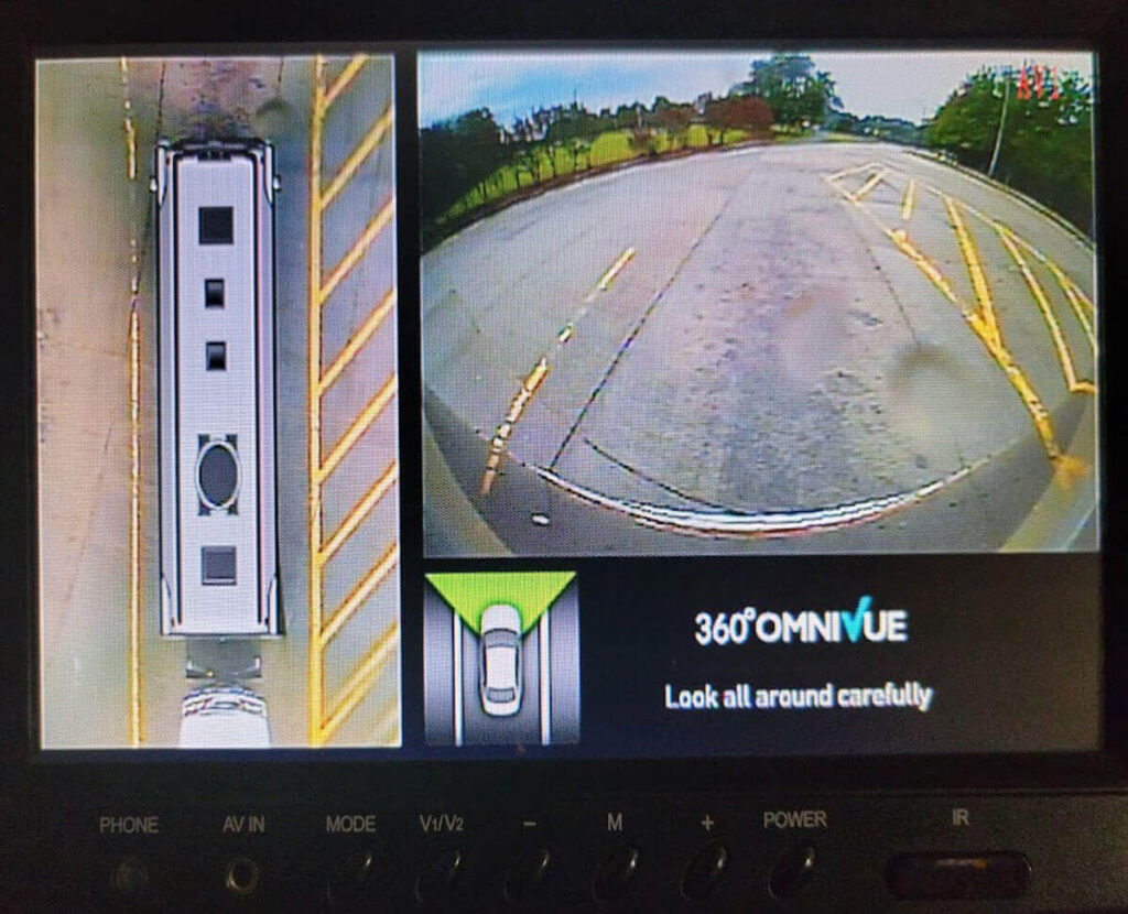

Once the cameras are installed, the display screen is installed in the cockpit where you can view it easily while driving. Mine is mounted just above the dashboard to the right. It could be mounted overhead, but that may be awkward to look at while in motion. The default screen size is 7” but I opted for the larger 9” screen in my bus to give me a little better view with my old eyes. After that, the computer is wired up to the cameras and the screen.

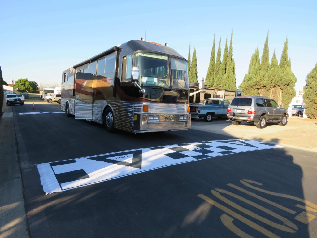

The computer must be programmed to your bus’s characteristics. It ties in all four cameras so you can also have a bird’s-eye view of everything around your bus on the left-side screen. This is great for backing into those tight spots as you see everything on both sides, the front and rear of the bus all on one screen. It allows you to clearly see what is happening at the front and rear corners of your bus, the key points when backing into a spot.
Bird’s-Eye View of my bus and the front of my toad.
There is also a main screen on the display, besides the bird’s-eye view screen that changes depending on what you are doing. That screen image changes from Front, Rear, Left, and Right sides automatically or can be changed manually with a separately mounted pushbutton cycle switch located separately on the dash.
The entire screen.
The left screen is the birds-eye view that never changes. The right screen changes either manually or automatically. The left and right cameras are tied into your turn signals, so you get automatic left and right views of your bus so you can see if someone is passing or if an object is in the way! This is great for safer lane changes especially if you are towing something.
When you shift into reverse, the rear camera automatically appears on the screen so you can see what is directly behind you. All the while, the bird’s-eye view is on the screen next to it so you can keep an eye on both screens at the same time. The default view is the front camera, but this can be changed to any view you like during programming. I wished I had mine changed to my rear-view camera as I immediately change it to that before driving so I can keep an eye on my toad while driving.
Running the cable through the basement from each camera to the cockpit.

Pattern used forward and aft on the driveway to calibrate the images so the computer can stitch them together to create a bird’s-eye view of all sides of the bus.

Driver’s side camera was installed before being painted.

Drilling a hole for the rear camera.
Drilling a hole for the driver’s side camera.
