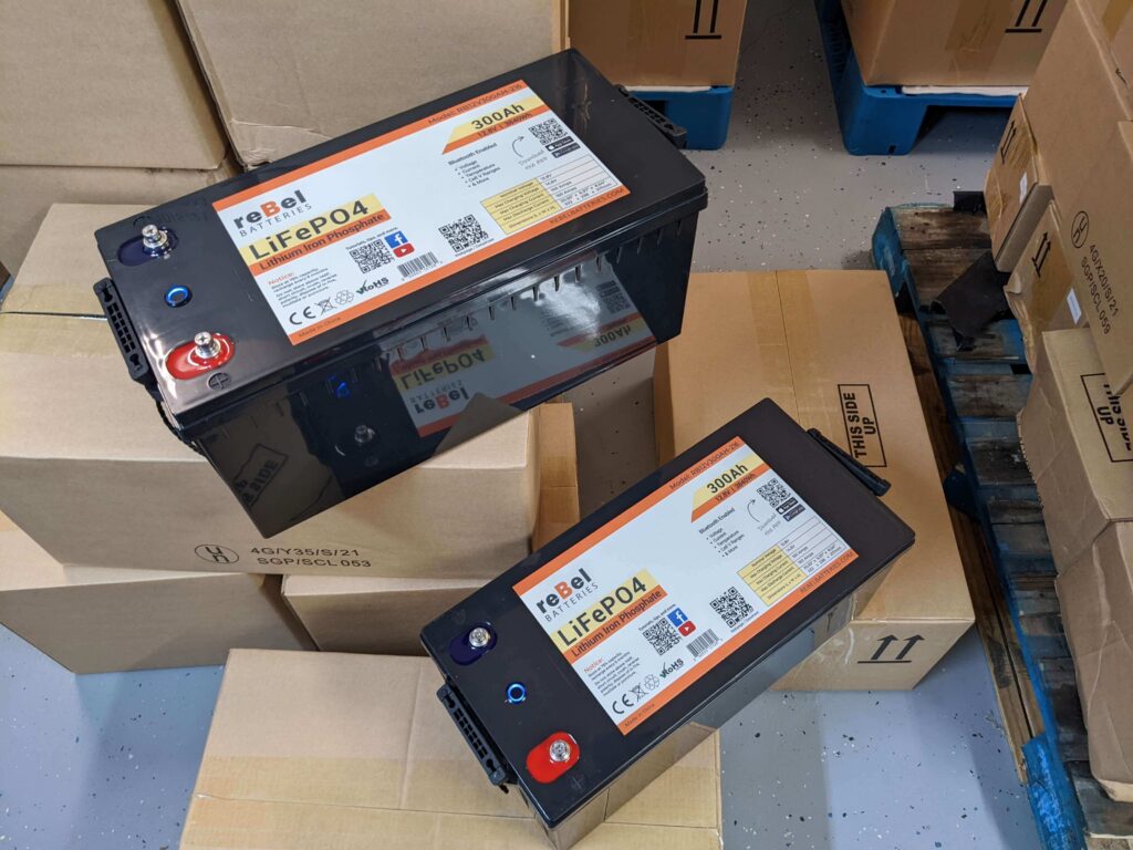

Today a quality 300-amp hour lithium battery from a USA supplier (Rebel Batteries) owned by a disabled American Navy vet with ware-housing, shipping, warranty fulfillment, and technical support all in the USA, retails for
$1,549 including shipping. That is just over $500 per 100-amp hours of capacity. Like most lithium batteries, these are made in China and shipped in bulk to Texas where the Rebel Batteries company is located.
They not only feature a quality 150-amp battery management system with both low and high temperature shut off and all the other protections you would expect, but they also have a built-in Bluetooth battery monitor. From your Apple or Android phone, you can see and manage nearly everything associated with the battery - including the state of charge. So, you no longer need to buy a separate battery monitor.

Let’s look at the internals of these newer, higher-capacity lithium iron phosphate batteries like the one in the photo below from Rebel Batteries. They supplied the battery shown here for this article. I asked them to send me one unsealed so I could open it up and show you the build quality. This is the same unit they used for their teardown video that you can download from their website. Even though these only cost $1,549 including shipping, the build quality is the case to a bolt and nut and lock washer on the bottom where the battery leads are attached. Those leads are fully encased in a sealant so they can never come loose and the connectors can be properly torqued without spinning. impressive.
Notice how the leads going in and out of the battery management system are similarly encased in sealant. The internal battery connection leads are silicone insulated extremely high strand count wires that can easily handle the max discharge and max recharge current of 150 amps. Standard wire like what you might buy at an auto parts store cannot handle nearly that much current without over-heating. These wires can.
The battery management system features very large heat sinks and is separated from the 300A LiFePO4 battery cells by an insulating layer. The cells themselves are prismatic cells that in total are only about 14” long so the outside case could be much shorter.
This is a standard 4D case that measures 20.5” x 9.37” x 8.54 inches overall including the handles so thick foam blocks are placed on each end and on the top to keep everything secure for high vibration environments like your bus, van, or motorhome.
In this picture, you can see the high and low-temperature probes, the battery balance wires, and the Bluetooth module secured with sealant as well.
The Bluetooth module is accessed by software you can download to your Apple or Android phone or tablet. The software was installed quickly and easily and connected to the battery management system the first time without trauma. It provides all the data you need to see how much capacity you have left, charge cycles, etc. Note how even the cell voltages are which is a good indication that the BMS cell balancing is working well.
This battery was manufactured in March 2021. The 300-amp hour Rebel Batteries use even larger internal wires than the ones in this one and the BMS can handle up to 16 of these batteries wired in parallel.
That is very impressive as many, even much higher priced lithium iron phosphate batteries are limited to just four wired in parallel. With this much amp-hour capacity on tap, should you ever need it in the future, you are future-proofed. The Bluetooth module automatically turned itself on when the application connected my phone to the battery to get these readings.
