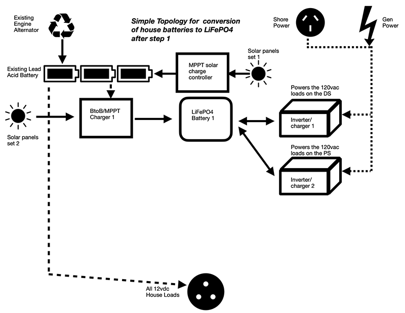

Those considerations lead directly to the topology I have shown in the previous articles in this series and graphically depicted in the diagram above. Let’s review what we previously learned.
Remove the positive cables running from the existing lead acid battery bank to the existing inverter/charger(s) already in your coach.
Connect a new house lithium battery bank directly to the inverter/charger already in your coach so only the Li battery bank provides 120vac power to the coach freeing up the lead acid batteries to power only the 12vdc loads.
Remove about half of your existing lead acid batteries. Since they now power only 12vdc loads, you don’t need as many as you did when they also were powering the high draw inverter to provide 120vac power for your appliances.
Add a Battery-to-Battery charger between the remaining lead acid batteries that are charged by the engine alternator and the new Li house battery. That will keep the Li battery charged while driving, limit the amp draw to the rating on the BtoB unit to protect your alternator, and properly isolate the Li from the LA batteries.
The existing inverter/charger(s) already in your coach will recharge the Li bank while you are plugged into shore power or while the generator is running.
If you also want solar charging, add one or more solar panels and an MPPT solar charge controller and connect it directly to the Li battery bank.
That is all there is to the topology. All batteries are recharged automatically while driving and with solar, shore, or by generator power while parked. The Li batteries power only the inverter(s) to provide 120vac for your appliances, a task for which they are ideally suited. The remaining lead acid batteries power only the 12vdc pumps, fans, lights, and any 12vdc appliances, a task for which they are ideally suited.

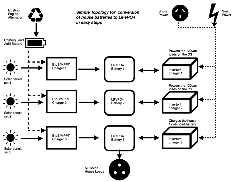

This topology is not only simple, easy, and safe to implement, but it is also very extensible over time. If you find you need more 120vac power the way you live in your coach, you can simply add a second Li house battery bank, a second inverter/charger, a second Batter-to-Battery charger, and a second MPPT solar controller and solar panels.
Now you have two totally independent Li house battery banks so there is no risk of mixing two different brands of Li batteries together, which is not recommended, while at the same time you are achieving the objective of increasing the 120vac power available in your coach while boondocking. Both house battery banks will be automatically charged off the alternator while driving and from solar, shore, or generator power while parked.
When you do decide to replace all but one of your existing lead acid batteries, just add another Li battery bank, another inverter/charger (or just a charger), another MPPT solar controller, and solar panels. Connect your 12vdc house loads to this new Li battery and your conversion is complete.

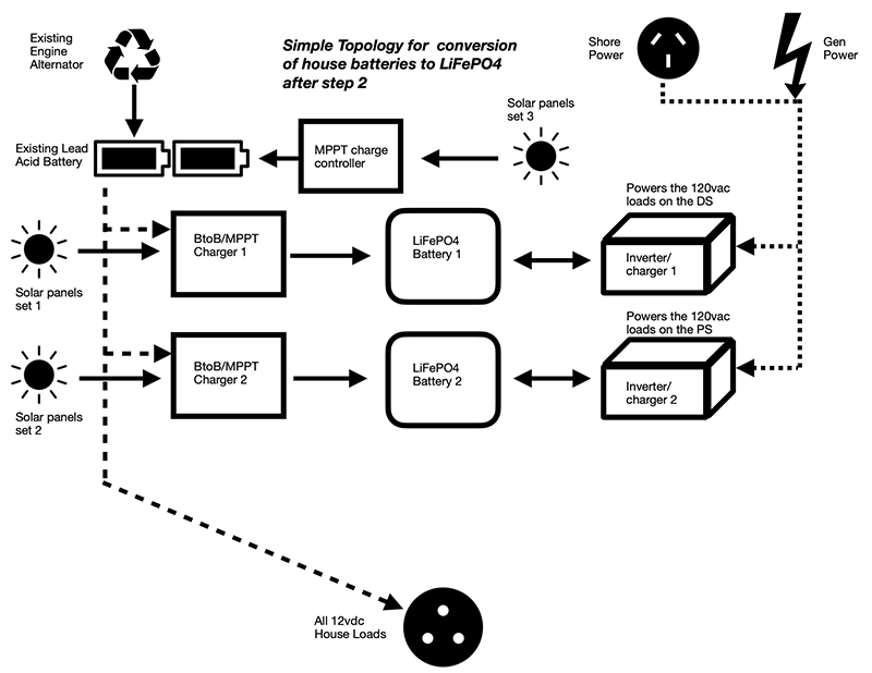

Here, in this third article in this series, we will walk through how easy it is to now change the configuration again. EEZ RV Products has recently introduced a new 400-amp hour ruggedized LiFePO4 battery in a welded stainless-steel case with great build quality under the Evergreen Battery name. I will now remove all but one of the AGM lead acid batteries (leaving it in place only to absorb any voltage spike that could occur from alternator charging), move the 300 Amp hour Rebel Battery to handle only the 12vdc loads and install this EEZ RV Products 400 Amp hour ruggedized unit to handle all the 120vac inverter loads on the passenger side which is where the residential refrigerator is located in this coach.
By making this change I will wind up with 400 available Amp hours of capacity for the 120vac loads on the driver’s side where the kitchen, microwave, induction cooktop, coffee maker, and 120vac audio/video systems are located, and 400 available Amp hours of capacity for the 120vac loads on the passenger side of the coach where the residential refrigerator, basement refrigerator, and outdoor entertainment systems are located. The third LiFePO4 300 available Ah battery bank will take over the 12vdc loads like the hydronic heating system, zone system heat exchanger blowers, LED lights, and the over-the-road AC zone system blowers throughout the coach.
On the previous page is a photo of how it looks installed in my Prevost. The three Renogy MPPT/BtoB chargers are mid-row left. The inverter/chargers supplying the coach 120vac loads are top row left and right (white boxes). The inverter/charger for the 300 Ah Rebel Battery Li powering all the house 12vdc loads is bottom row right.
The battery itself is just above, the center row right. The 400Ah Lion Energy Li battery bank is in a closet above this battery compartment. The 400 Ah EEZ RV Li battery bank is the stainless-steel box lower row left. The one remaining lead acid AGM battery is the lower row center. The black box upper row center was originally devoted to the 12vdc house loads and is now not used for much.
Note the three circuit breakers just to the right of the Renogy BtoB/MPPT charge controllers. The heavy red cable coming from behind the black box upper row center and attached to the post on the silver upright piece is coming from the B+ terminal on the alternator.
The heavy red cable also attached to that post is coming from the B+ on the lead acid battery. The three circuit breakers supply protected input power to each of the three Renogy BtoB/MPPT charge controllers. That constitutes the total of what is necessary to keep all three Li battery banks isolated one from another yet properly charged while driving while simultaneously protecting the alternator from any voltage spikes and/or any of the Li batteries drawing too many Amps from the alternator while charging.

This is the simple, easy, safe, cost-effective, and highly flexible way to convert your motorhome or bus over to the many advantages of LiFePO4 batteries.
In Part 1 of this final article in the series on how to safely, inexpensively, and correctly convert your motorhome or bus from lead-acid (AGM, sealed lead-acid, wet cell, etc.) house batteries to LiFePO4 batteries I discussed why you don’t need to do this conversion all at once. Rather, you can, as I did, “ooze” into the process as your needs and budget allow. I did it in three steps over two years which allowed me to use up some of the remaining life in the six 8D AGM batteries that were in my coach when I purchased it while enjoying the many benefits of LiFePO4 batteries from day one to power the 120vac appliances in my coach while off the grid.
In part two, I want to talk about why I created this extensible topology the way I did and also cover what I feel are the critical aspects of great build quality for today’s high-capacity LiFePO4 batteries.
The first thing that determined this simple topology is, you are sure you never allow a lead-acid and a Li battery to be directly connected one with another. These two battery chemistries operate at very different voltage levels - a Li battery when 80% discharged still outputs the same voltage as a lead-acid battery does when it is fully charged.
If you were to connect them directly together, the higher voltage Li battery would send a current surge into the lead-acid battery trying to bring it to the same voltage level. That could damage one or both batteries and could cause the lead-acid battery to explode under some circumstances. Here, either the BtoB/MPPT charge controller or the Inverter/charger prevents the two different battery chemistries from ever being directly connected one to the other.
The second consideration is that it is not a good idea to mix Li batteries from different manufacturers, or different capacities or even Li batteries of the same capacity from the same manufacturer purchased more than 3-6 months apart because they may have different battery management systems which might not function well together. In this topology all the battery banks are isolated one from another, so you don’t need to be concerned about that.
Some authors and YouTube videos will suggest that it is okay to mix them in some circumstances. I think that is a risk my readers should not take. The increased cost of keeping them isolated in my mind is well justified and will make sure there is no issue ever, not initially and not over time.
Saving your alternator is the third consideration for why I designed this topology the way I did. Unless your motorhome or bus is only a year or two old, your existing alternator and voltage regulator were designed ONLY to charge lead-acid batteries. Lead-acid batteries have so much internal resistance that they severely limit how many amps the batteries can take out of the alternator. If you try to run your existing alternator at more than about 60% of its rated capacity, you run the very real risk of overheating it which can cause permanent damage. The alternators used in large motorhomes and bus conversions can be verrrry expensive to replace.
Li batteries have very low internal resistance so they will happily take all the amps your alternator can put out. To protect your alternator from overheating you need a way to limit the amps the alternator supplies to recharge your Li battery bank(s). That is one thing the Battery-to-Battery charger does. It takes as input the charge current going to a lead-acid battery and internally converts that charge current to the profile required to fully recharge the Li bank while at the same time limiting the Amperage draw to a specified value - in the case of these Renogy combination BtoB/MPPT charges that limit is 50 amps.
So, even if you are charging three separate Li banks as I do, the maximum amp draw on the alternator is only 150 amps (50x3), about 60% of the 270 amps my oil-cooled alternator was designed to put out all day long without damage. In most cases, not all three Li banks will require all 50 amps at the same time anyway since they will be at different levels of discharge most of the time while you are boondocking. As a result, there is almost no way I can harm my existing 20+-year-old expensive alternator using this design.
For the alternator to work it needs to see voltage on the line running from the alternator to the battery it is trying to charge. That is why you cannot directly connect the output from the alternator to the input of a Battery-to-Battery charger. The BtoB charger does not allow voltage to flow backward from the battery through the BtoB charger so the alternator would never see voltage on that line. Instead, leave one lead-acid battery in the system as shown. Connect the output line from the existing alternator to that lead-acid battery. Run a separate line from the B+ terminal on the lead-acid battery to the B+ input on the BtoB charger.
When the engine is running, the alternator will see the voltage from the lead-acid battery and turn itself on to recharge it. At the same time, the BtoB charger will see the elevated voltage put out by the alternator which will allow it to turn itself on to charge the Li battery with the proper charge profile. No user intervention is required.
The final reason to keep one lead-acid battery in the system as shown is that each Li battery has its own built-in battery management system which protects the Li battery from overcharging, undercharging, charging while too cold, over-discharging, etc. If all the BMSs in all the Li battery banks were to shut down charging at the same time with the alternator still spinning, it could result in a large voltage spike which could damage some or all of the electronics in the system. By keeping one lead-acid battery in the system, that lead-acid battery will absorb any such voltage spike and the alternator would just see itself still charging a lead-acid battery as it always has.
The fourth consideration is that by isolating the lead-acid from the Li batteries and isolating the Li battery banks from one another by using separate BtoB chargers (one for each Li bank), you limit the recharge rate to the output rating of the BtoB charger(s). In this case, each Renogy combined BtoB/MPPT charger can output a maximum of 50 amps to recharge each Li battery bank. That is a much lower recharge rate than a 300 or 400-amp-hour Li battery can safely handle.
It does no harm to charge them more slowly so the only thing you “lose” is fast charging from the alternator while driving. It has no effect on the time to recharge while running the generator or while on shore power as the recharge rate, under those circumstances, is determined by the output of the inverter/charger connected to each Li battery bank - and they usually are designed to output 100 or more amps.
If you use these Renogy units to recharge both from the alternator and from solar at the same time, each charging mode will be limited to 25 amps. If you really want faster charging while driving, you can always add one or more of these Renogy units in parallel for each Li battery bank. The effective charge rates will double to about the same rate as charging off the generator or shore power as long as the total recharge amps do not exceed the safe working output of your alternator which will be about 60% of the rated output of the alternator.
The final consideration that caused me to design this conversion system the way I did was to allow you full flexibility to add or subtract battery capacity over time to match what you actually use - the way you live in your coach. I recommend you record the state of charge on each of your Li battery banks first thing each morning when you get up while boondocking. That will show you how much capacity you used the day before for whatever each battery bank is powering.

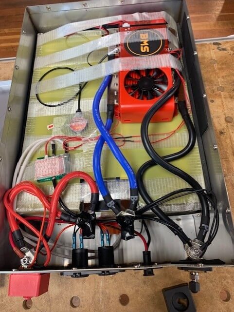

Let’s use as an example the new EEZ RV Products 400-amp hour ruggedized Evergreen brand LiFePO4 battery. It has among the best build quality I have seen to date. The stainless-steel case is made from non-magnetic (the higher grades), with fully welded corners all around. The top of the sides are rolled and recessed enough that the lid sits flush with the sides. There are no raw edges anywhere.
The screws that hold the top in place are stainless-steel machine screws going into threaded inserts, not sheet metal screws, so there are no sharp edges on the inside of the case either. The cells are properly separated with fiberglass separator sheets and the cells are connected with busbars. The whole battery pack is wrapped with fiberglass insulating sheets and it sits on top of a custom-made heating pad that covers the whole bottom of the pack.
A dense foam insulator layer protects the battery cells from vibration and insulates them electrically from the stainless-steel case at the bottom and around all four sides. The case is larger than an 8D AGM case to provide lots of open-air space for heat dissipation while holding the cells and internal components securely in place. A stainless-steel bulkhead keeps the battery cells from shifting front to back and the dense vibration-insulating foam prevents them from shifting side to side.
Stainless steel straps hold the battery cells in place even when this battery is turned upside down. The openings for the included 1-amp and 2.1-amp USB power ports, the 12vdc non-regulated cigarette lighter power port, and the standard solar charge controller input port are all sealed with rubber caps to provide water protection.
All of the internal electrical connections are made via flag connectors with a nut and bolt so the connections can be properly torqued without fear of stripping. Same with the external battery cable connections. They are a nut and bolt to a flag-like connector for the same reason. Many, even high-capacity batteries, are using threaded holes in the battery posts and 6 to 8-mm bolts to hold the battery cables to the battery. You need to be careful not to strip the threads in those holes or you run the risk of ruining the battery before you start.
Because it is so easy to remove the top, this case design lends itself to easy replacement of internal components if ever needed. A simple bead of caulk on the inside of the top flanges will make the case more water-resistant. I wouldn’t call it waterproof, but for most applications, this case design looks like it would likely survive even moderately heavy water splash. However, it is not meant to be immersed in water.
The DALY battery management system and all the internal wiring are rated to handle the 300-amp continuous discharge rate the battery is designed to output. This high-quality BMS looks to be similar to, if not the same as, the high-quality, fan-cooled DALY unit that retails in the USA for $300 or more all by itself. All the high-power wiring inside the battery is double runs of 4 AWG high strand count tinned solid copper marine grade wire with 200 degree C insulation.
They will easily carry 2 x 150 = 300 amps over these short runs. Your cables connecting to this battery should be AWG 00 to 000 depending on the length and wire type. You want to be sure your wire can handle up to 300 amps of continuous discharge. Charge current should be limited to 150 amps for the longest battery life. Note that my use of the Renogy BtoB/MPPT charge controllers l the charge rate while driving to 50 amps per battery. While on shore or generator power the charge rate is right at 100 amps per battery.
This battery has a Bluetooth battery monitor built in which connects to an app on your phone. As mentioned above, it also has automatic heating built in. When the battery cell temperature reaches freezing, the BMS will prevent charge current from entering the battery and will automatically turn on the battery’s internally powered heating blanket. Once the cells reach a safe-for-charging temperature, the heater will turn off and the BMS will once again allow the charge current to enter the battery. No action on your part is required.
Keep in mind that with this much capacity along with all these features and this build quality, this battery is quite heavy. It weighs just under 100 lbs. so mount it accordingly. It can go anywhere in your coach since the stainless-steel case and internally powered heater will keep the battery safe in most mounting locations. I put mine in the rack where the original AGMs were located in an external bay.
