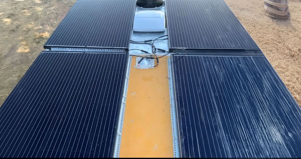

Roof Solar installation.
You save 43.5 Amps per hour using 12 VDC over inverting DC to AC power. Some may argue that using a 48 VDC inverter is more efficient and uses fewer DC Amps but still more than double what the DC refrigerator draws.
So, by not having to convert from DC to AC except for a couple of heavy loads, you can really stretch out your power needs. In one conversion, we call “Big Dog,” we have 1800 Watts of solar power, 1000 Watts of wind power, and a 550 Watts hydro generator. On most full sunny mornings, our batteries increase from 12.1 VDC morning voltage up to 14.1 VDC within two hours.

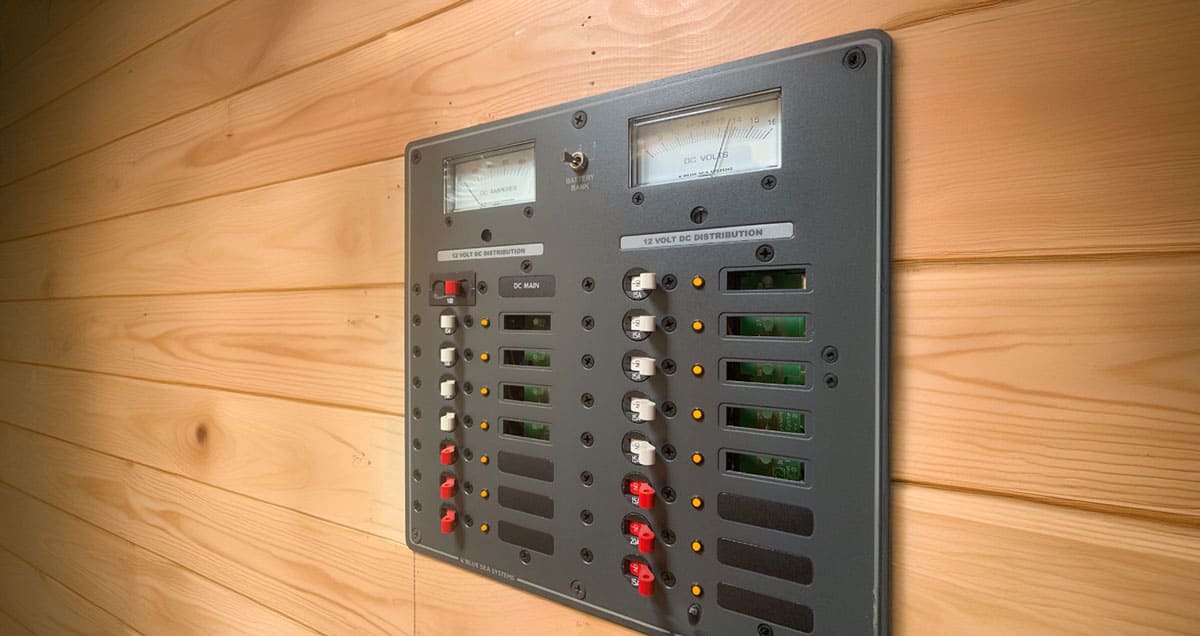

When we design a bus, we determine the customer’s electrical system needs in total Amps and then add 40% for cloudy and windless days. This gives us a baseline from which to work. For the DC side, we use an AC/DC master panel with monitoring capabilities and circuit protection.
We have a DC-to-DC charger to tie the coach batteries into the house system for charging. When the coaches’ start batteries get down to a preset voltage, the solar system will charge them back to a preset voltage and then disconnect from the coach batteries. We do the same thing for the generator start battery. We like to use USB chargers all through the bus to keep the lifesaving personal devices charged.

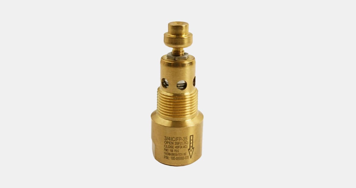

One thing you can do to maximize your energy usage with solar is to clean your solar panels often. To make this easier, we install a sprinkler system on the roofs of our buses. We use a quick connect on a faucet to plug a water hose into, and then you can rinse the panels with water from the onboard water system as needed to keep them operating at maximum capacity.
Anti-freeze valve - it drains after water pressure is reduced.
Anti-freeze valve – it drains after water pressure is reduced.
This makes cleaning panels very easy as you don’t have to climb a ladder with cleaning supplies in your hands, where the roof or the ladder can be slippery and, hence, dangerous when wet, as everything is already on the roof. We have an anti-freeze valve, this valve automatically dumps the water and shuts off the flow when the water pressure is released on the water line that feeds the roof-mounted faucet, just in case the temperature gets down to freezing at night. This is so you don’t have to constantly watch the ever-changing weather.
