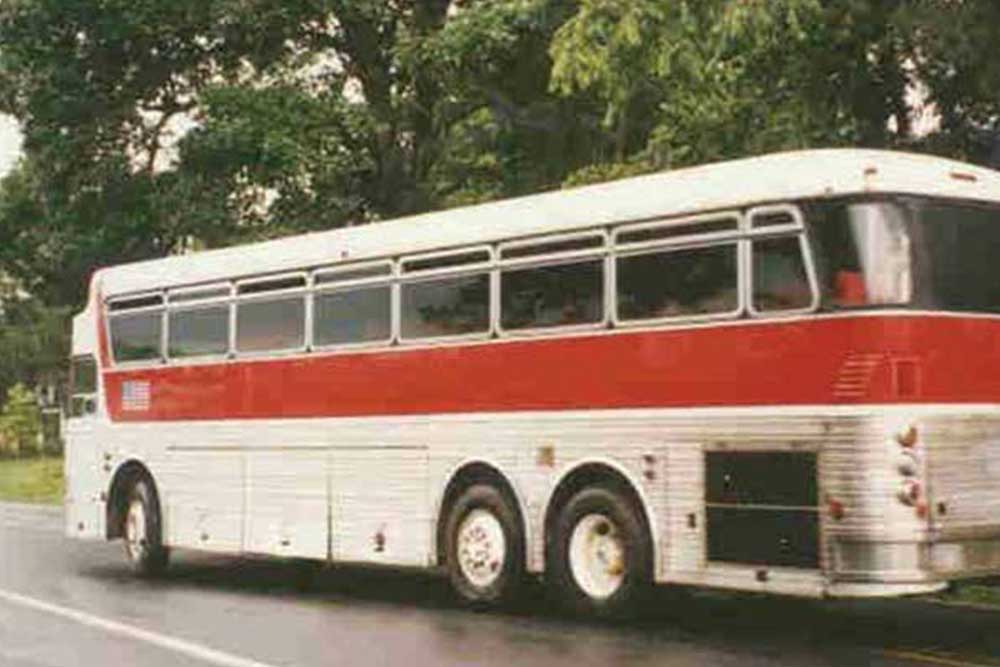

After acquiring my 1968 model 05 Eagle and starting the serious process of deciding to what degree I wanted to do a bus conversion was a big step for me. Little did I realize that this was one of the small decisions – just an exciting beginning.
DOING IT MY WAY. Oh yes this is one I’m doing ‘my way’. Over the past 20 odd years, I have dreamed of how I was to convert the bus of my dreams. Suddenly I found myself in the position of starting. I now own an Eagle, so what do I do to start the conversion?

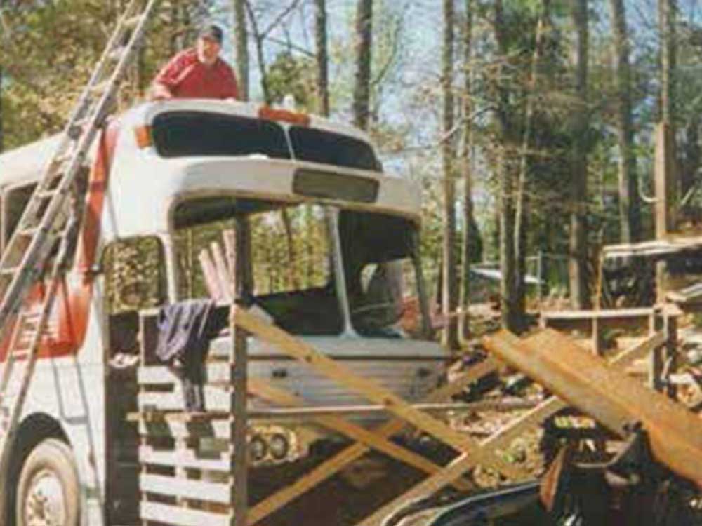

If you are fortunate enough to have a building in which to convert you bus; you won’t need the follow-ing info. I had no facility so I went to Harbor Freight and ordered an all-weather tarp.
I suggest 26 feet by 55 feet. This size will totally cover your 40-foot bus. Tie all sides down for protection. With a tarp this size, you can work on a side or end even in the rain because it can make a shelter to work under.

I elected to build my own for several reasons. I didn’t know how long I would need it. I didn’t want to spend the money to buy it. I didn’t want to borrow it from friends who had it for their work. If I built my own, I would save money and when I was finished, I could dispose of it easily.
I decided I needed an adjustable scaffold for the front and rear (for removing and installing caps) and one to run the length of the bus. That way I could work one whole side without moving the scaffolding.
I went to a building supply house and purchased 12 pieces of 2” x 12” x 14’; 20 pieces of 1” x 4” x 16’; and 28 pieces of 2” x 4” x 24”. I started looking for homebuilders and companies that were discarding pallets. Yes, I made my adjustable scaffolding from used pallets. Most pallets are made of oak or other hardwoods.

With all of the windows out, I removed the old caps starting with the front one.
With scaffolding in place in the front, rear and along one side, I drilled the rivets (both rows over the top) using a 3/16” drill. Note: I was advised to buy a lot of inexpensive 3/16” bits because I would go through them. Tried that, and then I decided to buy the titanium nitrate coated drills. They last six times longer than the cheap bit and can be easily reshaped—cheaper by far.
