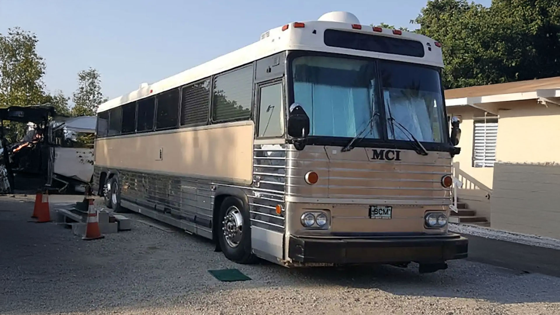

I have been traveling and living in RVs and buses for 40 years now. All of my buses have had a generator capable of running two or three roof air conditioners (A/C) and all other electrical appliances, as well as a decent house battery bank for when I was boondocking. I never had solar panels on a bus conversion until now. Here is why.
My first bus was an MCI MC-7 Combo. At the time, I lived in an RV park and never drove the bus. I was working full-time traveling and teaching computer classes, and I never had time to take the bus out. At the same time, I also owned a Sportsmobile camper that I used for traveling when I wanted to go on a short vacation. The entire roof was covered with solar panels and had sufficient batteries to run the roof A/C for up to two hours, which was adequate to cool down the inside before going to bed. This was my first experience with solar panels.
The MC-7 had a good Onan generator mounted in a bay, but because I was always hooked up to shore power, I only ran it once a month to ensure it would start if and when I needed it. The park I was staying in would occasionally lose power, as it was an old RV park in an older section of town. But 100% of the time, the MC-7 was plugged into shore power, so I seldom used the generator and had no need for solar. But I could run the bus using the onboard generator when the power went off.
My next bus conversion was an MCI MC-9 Log Cabin bus, which, when I bought it, had no roof air conditioners, but it did have excellent factory over-the-road air conditioning. This was great when traveling down the road, but once parked, the best I could do was open all the windows and turn on the two Fantastic Fans, hoping for the best. The good thing was that all windows were left in the bus for the conversion, and most of them opened, so I could usually have a nice crosswind through the interior.
The guy I purchased this bus from primarily traveled in Southern California and up and down the West Coast, as well as to Burning Man in the Black Rock Desert of Nevada. Therefore, he did not need air conditioning once parked, as it was rarely that hot where he camped. However, I bought the bus to live in it full-time and to travel all over the U.S. So, one of the first things I did was to install two roof air conditioners. They were easy to install in the two roof hatches and were already pre-wired for potential future expansion.
The bus was wired for 30A, but by changing the main breaker and the shore power cord, it could handle 50A of power. The bus was designed to be upgraded if air conditioners were later installed.
That bus had no onboard generator, so one of the first things I did was remove the working Onan generator from my MC-7 bus and install it in the MC-9. The guy who sold me the MC-9, Mike Kadletz (some of you may know him), tried pawning off a cheap Chinese generator on me. After I spent a couple of days trying to get it running, I decided to remove my reliable Onan generator from my MC-7, which I was trading in for my MC-9 bus. The generator ran well and lasted as long as I owned the MC-9.
The MC-9 came with only two 12V house batteries, so I immediately added two more. It also came with a 1,000W inverter. Like the previous owner, I could run everything in the bus off the house batteries and the inverter for a day without plugging into shore power or running the generator. This bus was a fairly basic conversion, which he termed 'Back to the Basics', with only the essential appliances on board.
But if I wanted to run one or two roof air conditioners, that was a different story. I had to be either plugged into shore power or run the generator. It had no automatic transfer switch, so to change it over to run on the generator, I had to go outside, open the electric bay, and plug the shore power cord into the generator outlet. Nothing fancy.
At the time, I lived in an RV park most of the time and took the MC-9 on occasional one- or two-week trips, so using the generator worked fine when I couldn't plug in. This bus also carried propane for the heat, hot water, stove, and oven. They were two removable propane tanks, making it easy to get them filled without driving the bus to a propane station. I didn’t have much time to travel in my bus because I was working full-time, so I couldn't justify installing solar on that bus either.
