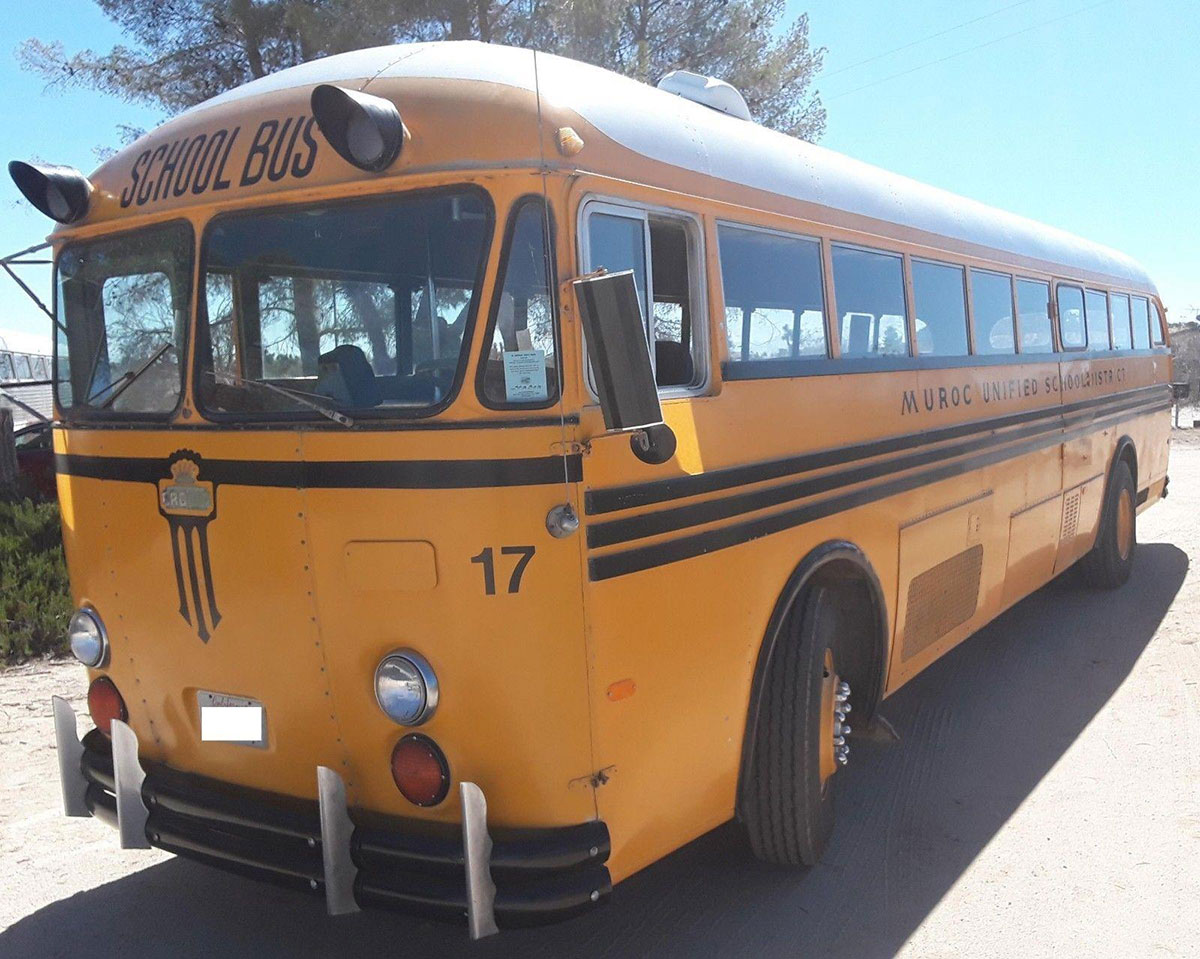

Buses came along years later, and like stagecoaches, they were built to transport passengers from Point A to Point B. A bus arrives at Point A, passengers board the bus and select a seat, then the bus drives to Point B where they may disembark or go on to another stop.
This is true of both school buses and over-the-road buses, what some people refer to as Entertainer Coaches, Tour Buses, or just Coaches. The main difference is, that an over-the-road bus provides a smoother ride, and lots of baggage storage space underneath, whereas most school buses have no bays, but they have more ground clearance so one can get off the beaten path a bit more. Read Doomsday Prepping in a Bus.
All buses have windows along both sides and of course, a big windshield, which seems to grow larger with each model year. There are exceptions such as purpose-built buses like those for entertainers or bus converters right out of the factory, which generally have fewer strategically placed windows along the sides such as the bus in this photo.

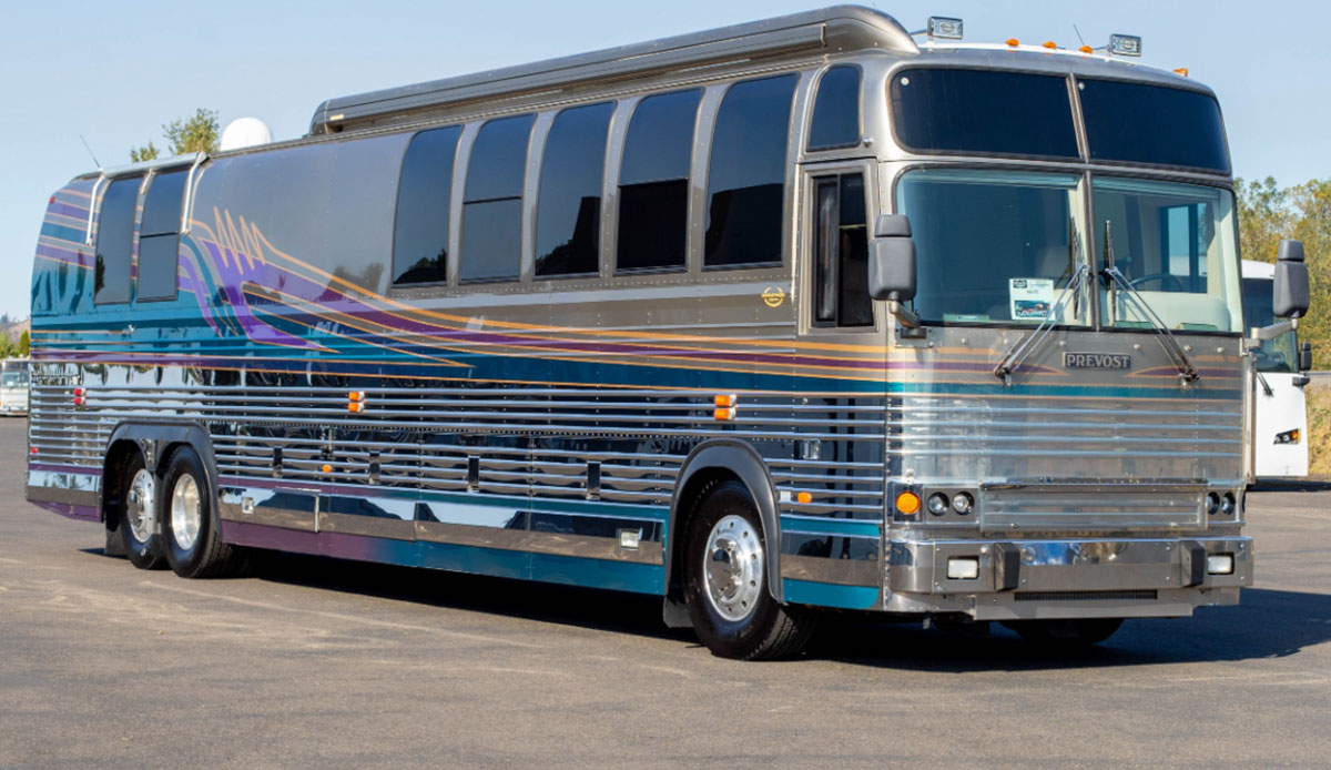

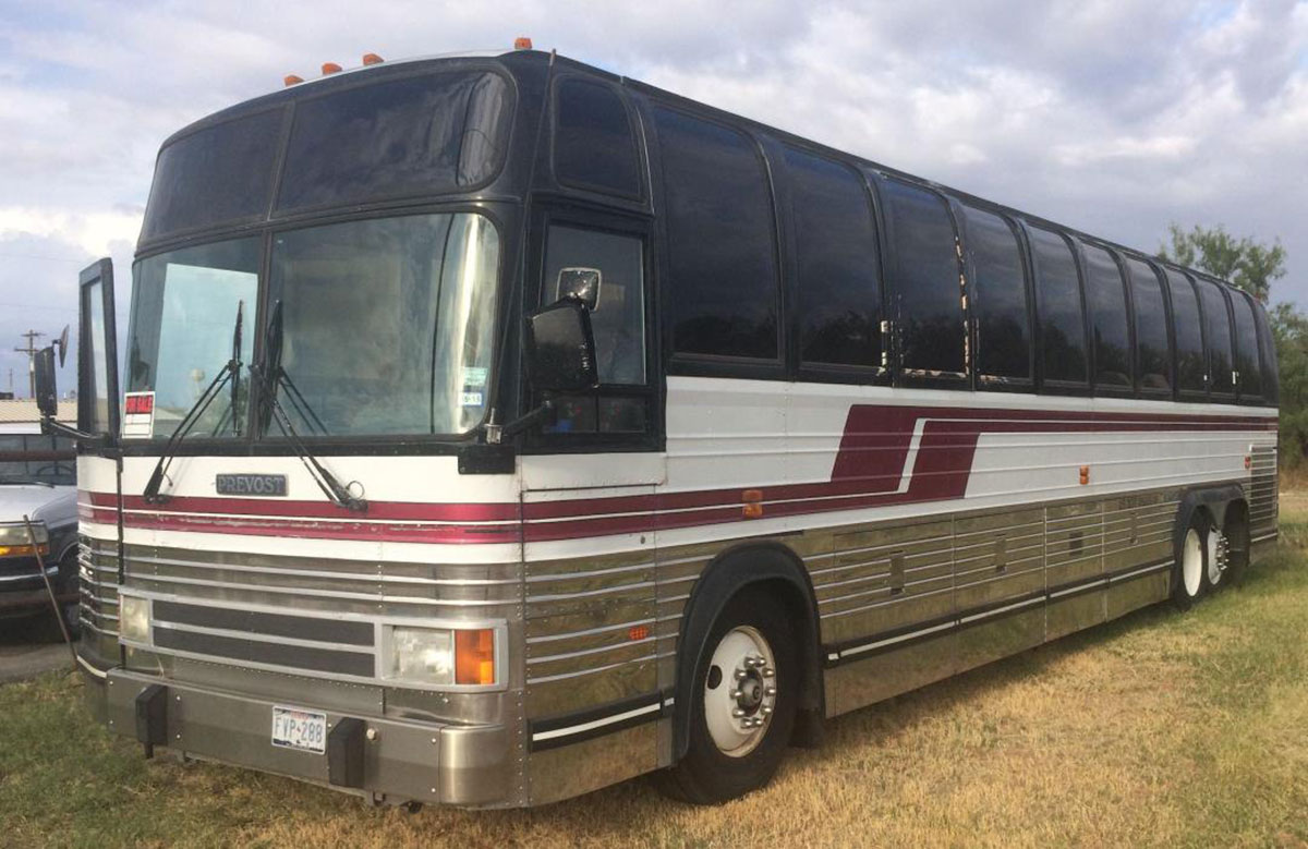

Many people like Prevost buses due to their modern styling. These buses, with slides, now can cost over two million dollars, which is over budget for most of our followers. The rest of us buy used buses, such as yellow school buses with sometimes hundreds of thousands of miles on them, or over-the-road passenger buses that may have a few million miles on them, that have been put out to pasture, sometimes literally, that are ready for retirement from revenue-generating service.

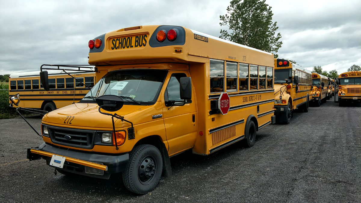

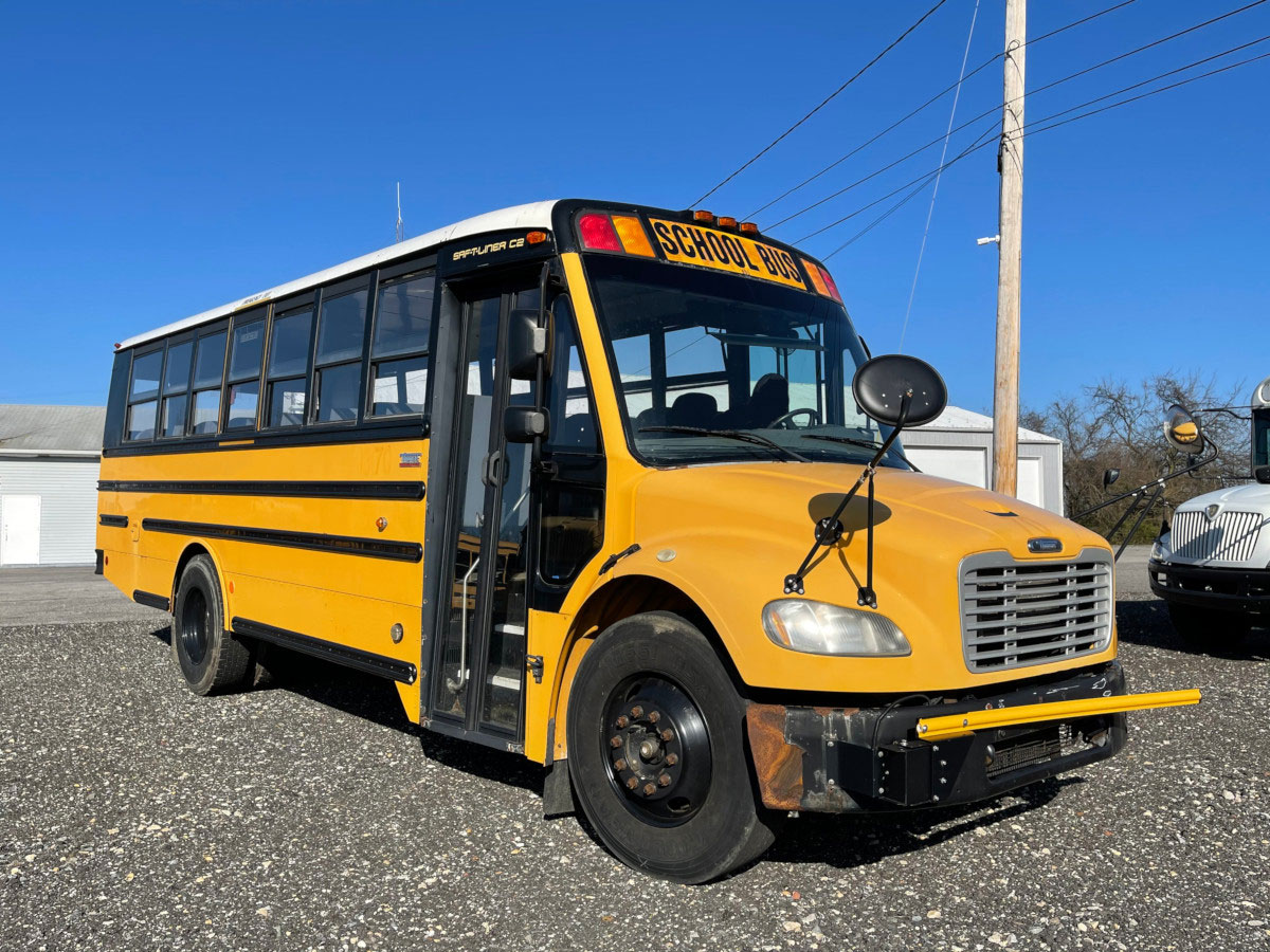

Schoolchildren and adult passengers that travel around the city or cross country like to look out the windows to enjoy the views as they are traveling, and since buses were first built, they came equipped with a lot of windows along each side of the bus.

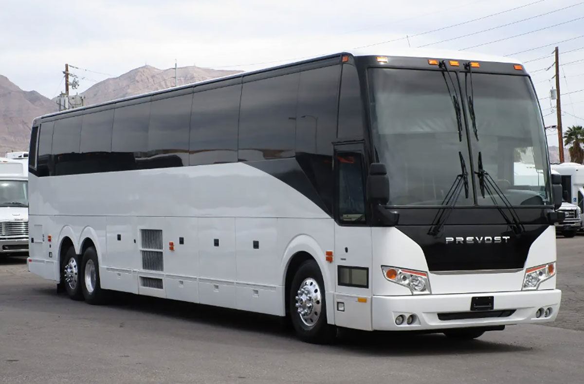

Some windows open and some may not on these buses, but all tour buses have emergency exit windows that can be opened from the inside if necessary.

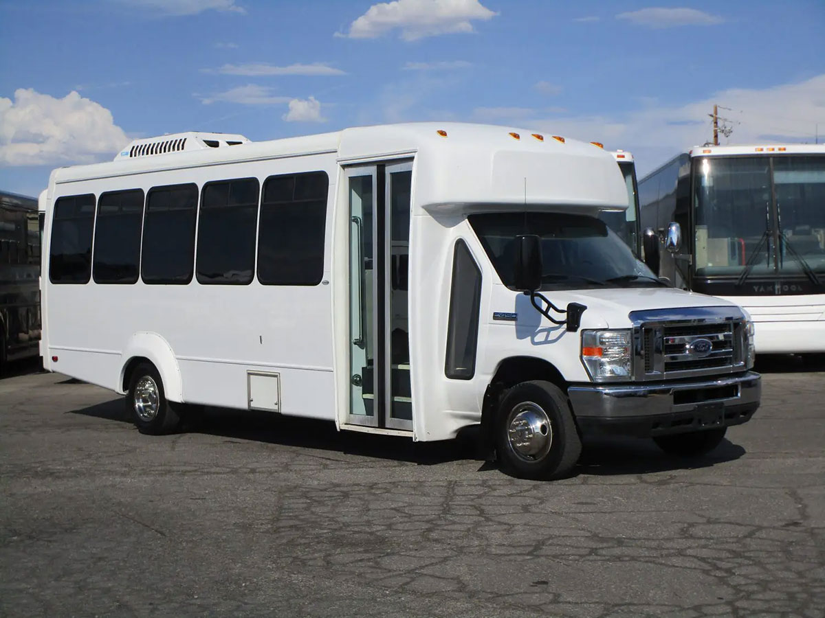

Even people who ride short-run shuttle buses that carry people from the hotel or the rental car lot to the airport terminal, like to see how close they are getting to either the terminal or their car so they can finish that last text message or email and be prepared to grab their luggage to disembark.
Shuttle buses usually have very large windows to see out whether they are sitting or standing. They do not have luggage racks overhead as people carry their luggage on the bus and put them in lower easily accessible luggage racks as luggage can be heavy. Instead, they are stored close to the door when traveling to and from the parking lot or hotel and the airport, usually a very short trip on a predetermined route every day.
Passengers are only on these buses for a short amount of time. They usually have large heating and air conditioning systems as people are constantly opening and closing the doors which may remain open while parked for extended periods waiting for passengers to fiddle with their luggage when boarding or exiting the bus.
The large windows make it nice for converting into motorhomes, therefore many people like these little buses. The only drawback is that like most school buses, there are no luggage compartments underneath, and shuttle buses have very little ground clearance as they are designed for people to get on and off quickly and easily with armfuls of luggage.

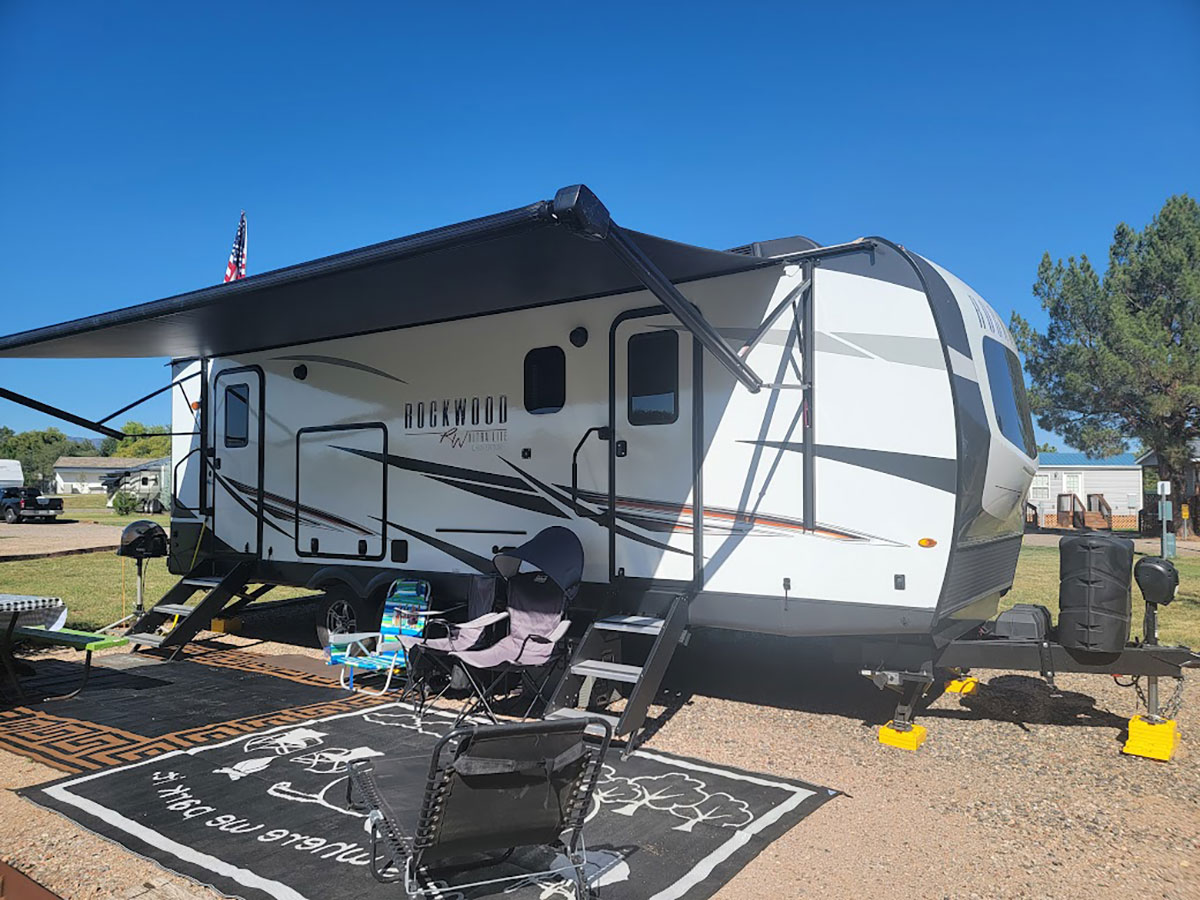

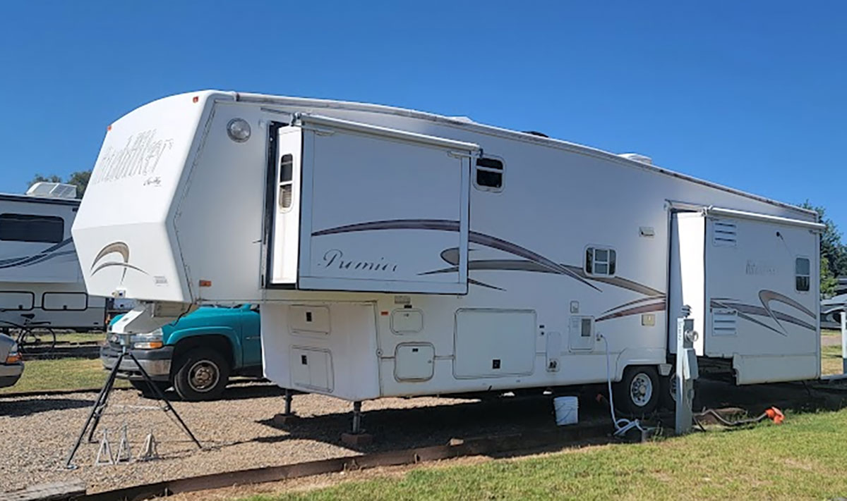

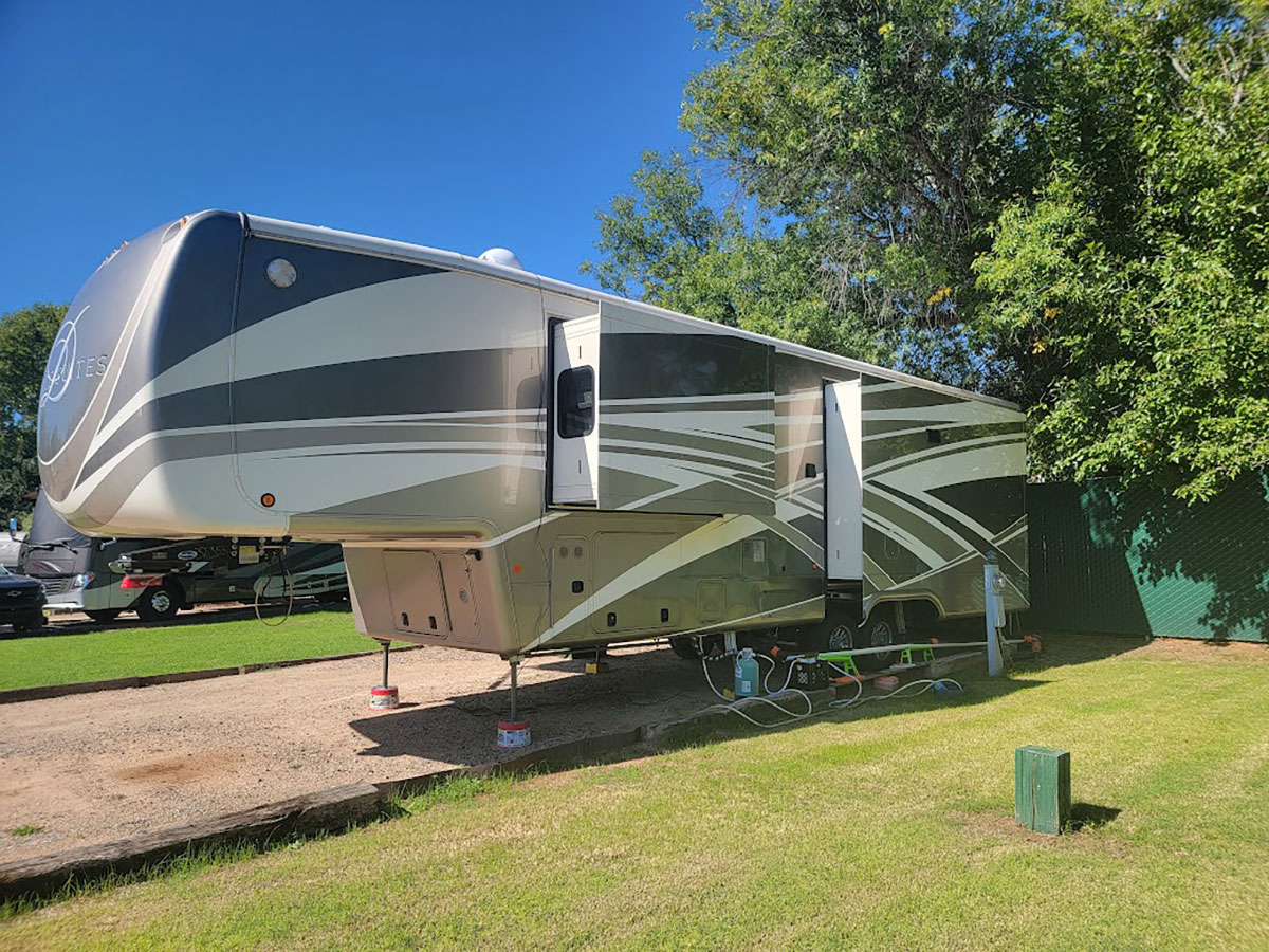

Compared to Buses, Many Conventional RVs Have Very Few Windows
Some factory-built Stick-N-Staple RVs on the other hand, have very few and very small windows as you can see in the photos below. I took these photos at an RV park in Arizona recently. Can you imagine living in an RV with windows as small and as few as these?
It costs money to cut and install windows, so they install very few as these manufacturers are all about building these units as cheaply as possible. Also, as much as these stick-built RVs flex going down the road, it is difficult to keep them sealed anyway. Living in this trailer would be like living inside a dark cave.

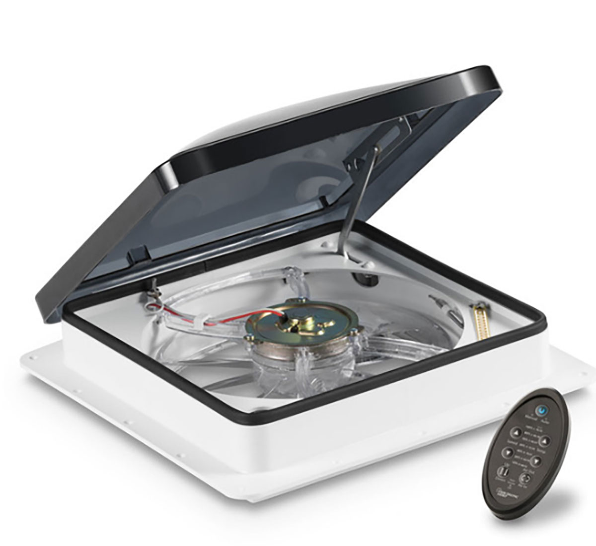

Besides the kitchen, some people also have an exhaust fan in the bedroom to draw any heat out before going to bed at night. You must be careful in the bedroom, however, because if the ceiling fan/vent leaks, or is left open in the rain, it can make a mess of your bedding. It is not as much of an issue in the kitchen or the bathroom, especially if the fan is located over the shower or sink.

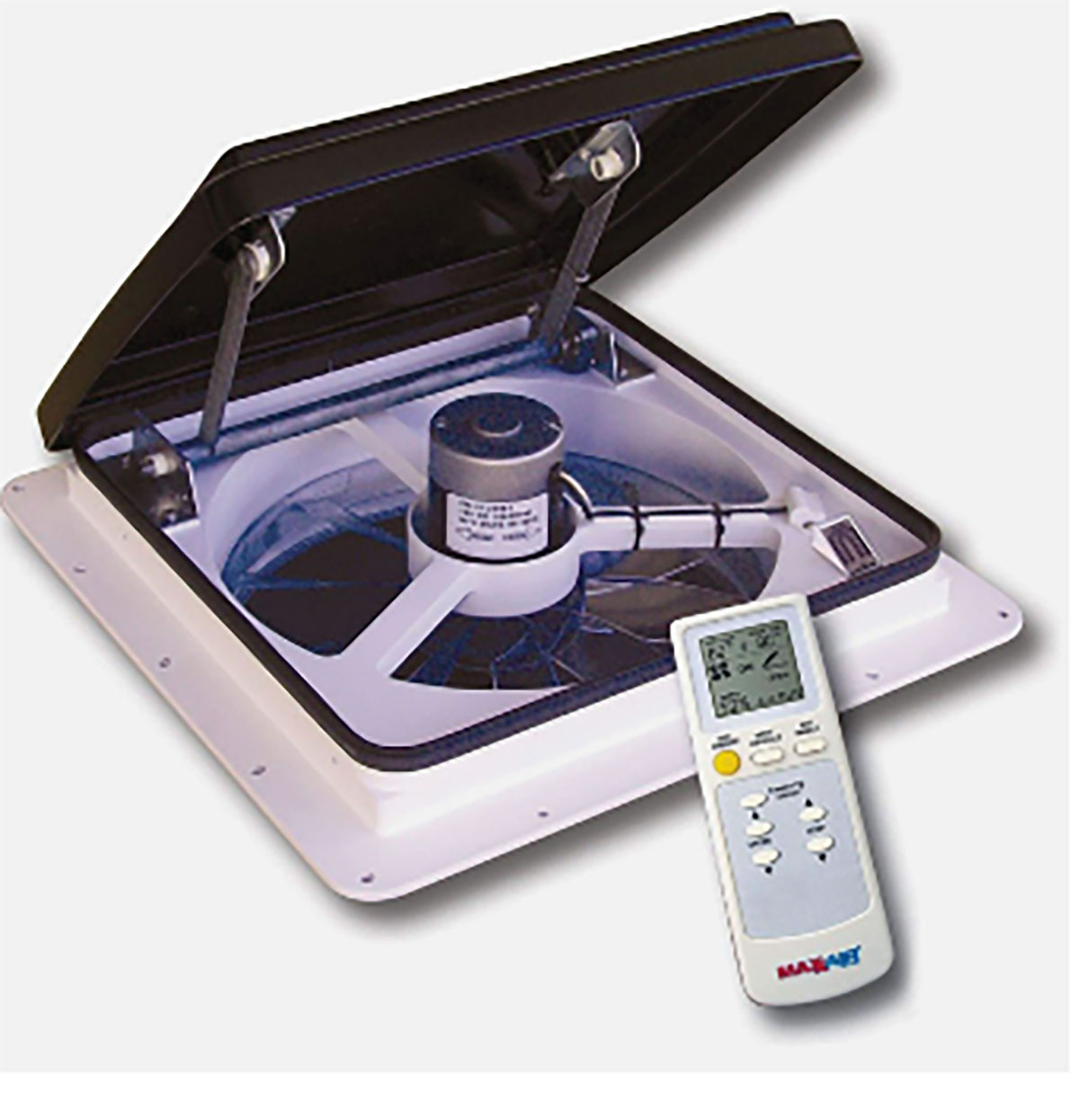

While we are on the subject of exhaust fans, MaxxFans have a built-in plastic cover, which many people like so they can leave it open in the rain. On the other hand, the Fantastic fan’s cover automatically closes when it senses rain.

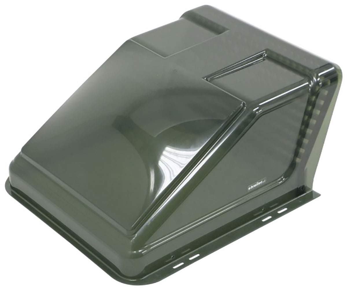

You can also buy a separate cover for the Fantastic fan, and I always had them on all of my bus conversions. An external cover serves two purposes. One, it keeps the rain out and I like to leave my fan on sometimes even when it is raining outside to draw in the smell of fresh rain. If I am cooking on a rainy day, it also draws out the smoke and cooking smells to keep the inside of the bus cleaner.
The additional cover also protects the factory lid that comes on the roof vent fans from the wind when traveling down the road. Wind at 60 MPH has been known to flex these covers back and forth so much over time that they eventually deteriorate from exposure and break then blow off while driving down the highway, leaving the inside of your bus exposed to the weather until you can replace the cover.
The only drawback to these covers is that they cut down the CFM (Cubic Feet per Minute) of air volume that they can expel, but that never concerned me as I felt the tradeoff was worth it.
There are vent covers for MaxxFans as well. If you have a vent fan over your bed, this may be a good investment to ensure that no rain comes in through your vent and onto your bed. Rain can blow sideways as can snow and sleet, so these provide more protection than the stock factory cover. MaxxFan covers are much larger because the MaxxFan has a bigger footprint than the Fantastic fan, so if you are big into solar, these may consume too much real estate on your roof.
Both the Fantastic fan and the MaxxFan covers will protect your fans from exposure to the elements and is one more layer of protection from keeping the bugs and varmints out. I highly recommend using an external cover as it will make your exhaust fan last longer.
However, be cognizant that these covers will also cut down the light entering your bus and that may or may not be a concern depending on where it is located. You may want less light entering the bedroom. Note: The translucent covers (above) will let in more light than the opaque ones, like this one. This can make a significant difference.

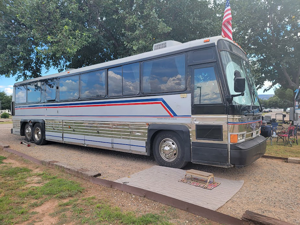

On my last bus, a 1983 MCI MC-9, all factory windows were left in for the conversion and I loved it. If I built another bus, I would consider doing the same thing again. By leaving all windows in a bus from the factory, you let in the maximum amount of light making the bus look larger inside.
Editor’s Note: You can read all about my MC-9 Log Cabin Bus by clicking HERE.
This really brightens up the inside of the bus so you can see everything you need to without having to use lighting during the daytime. The inside of my bus was the brightest bus of any bus I have ever been inside. It had light polyurethane-stained knotty-pine wood on the inside which also helped.
Not only that, but if it got hot, smelly, or stuffy inside, I could open almost all windows for cross ventilation. Cross ventilation is just as important in a bus as in a house in the country and it can save you from having to run your air conditioners as much.

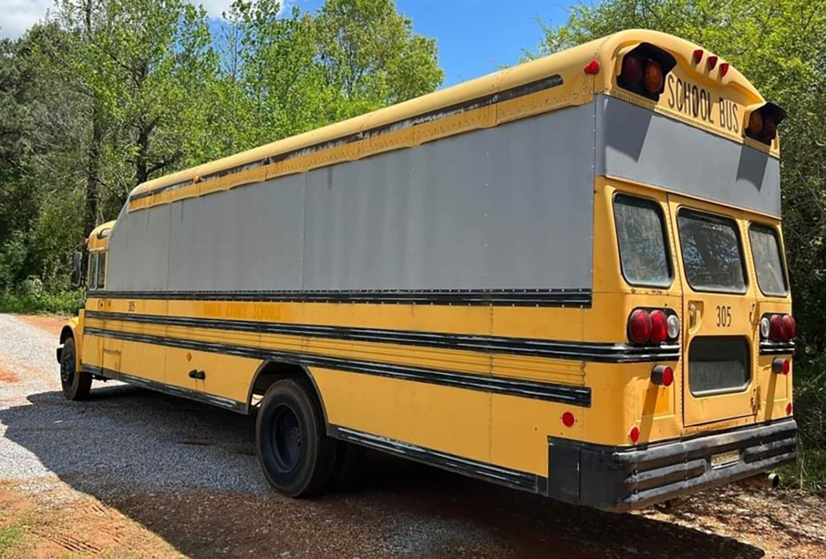

One advantage of removing all windows and covering both sides of the bus with steel, aluminum, or fiberglass, is that you can add RV-style windows which can be double-pane glass if you do not already have those in your bus.
You can also use sliding type windows, which are much better than either the fold-out windows that come in a coach or the vertical sliding windows that come in a school bus that always seem to rattle and are prone to leaking in heavy rain as the buses get older and the seals dry out. Besides, with coach windows that fold out from the top, they must remain closed while the bus is in motion.
RV windows are far superior to school bus windows and can be sealed very well and will cut down the noise inside a school bus conversion. Also, by removing all windows and installing windows only where you need them such as maybe one on each side in the front in the living area, one on each side in the bedroom, and one over the kitchen sink and one in the bathroom (maybe), then you can insulate the rest of the walls thoroughly which can make a significant difference if you plan to stay in places that have extreme weather.
