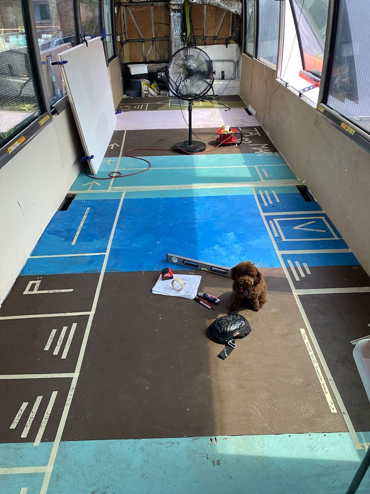

We purchased and converted our MCI J4500 Coach during the pandemic, a project that spanned 18 months from start to finish. Martin dedicated over 40 hours a week to the conversion, working tirelessly to make our dream a reality. After completing the major work, the bus was repainted in Mexico, giving it a fresh and stylish look.

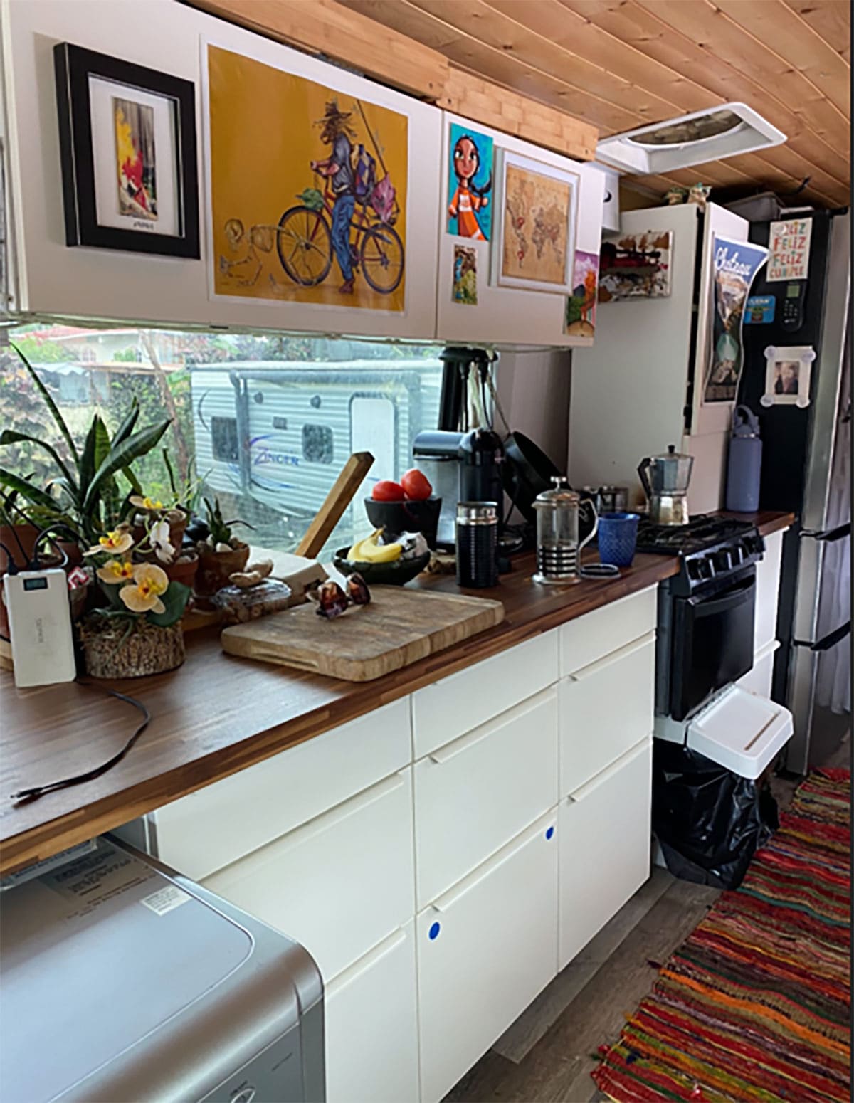

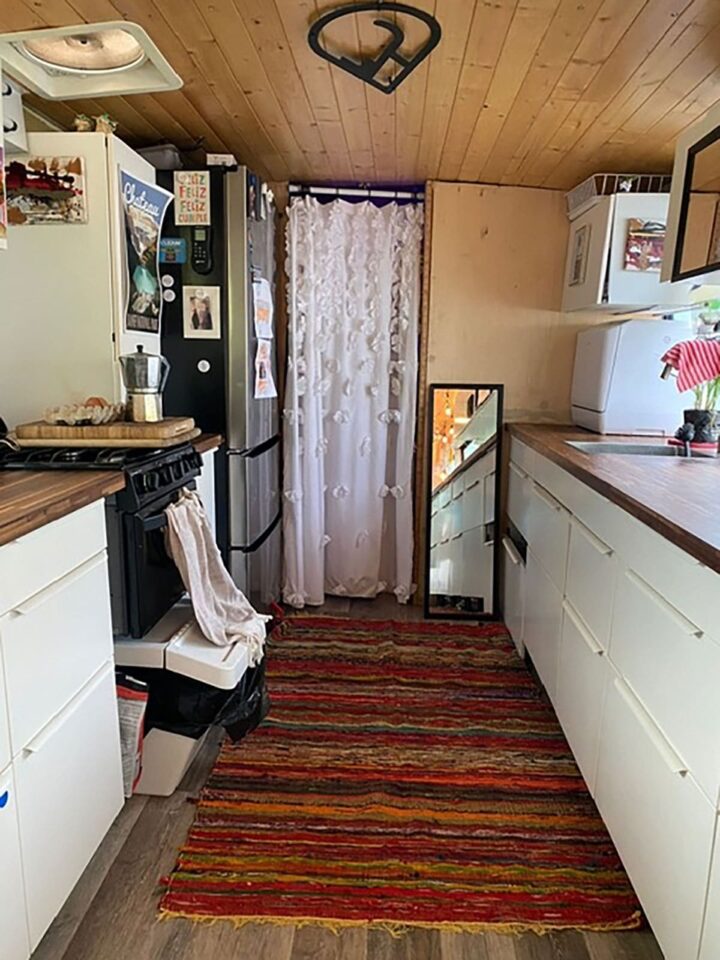

As a professional hairstylist and former salon owner, I wanted to bring a touch of my passion with us. Our kitchen includes an antique table and two salon chairs for cutting hair on the road. The kitchen design, which offers a 360-degree view, was challenging but worth it. We have ample storage with 33 cabinets to keep everything organized and within reach.

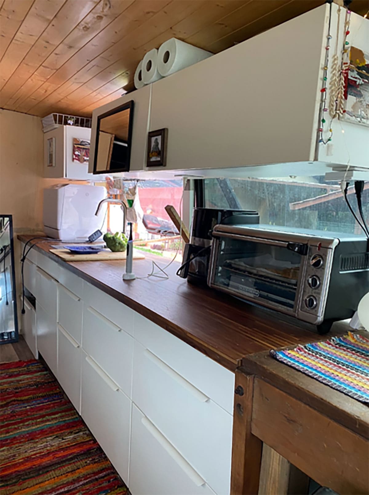

Here are 33 of the 36 cabinets. We have three more in the bedroom.
Kitchen Cabinets Street Side.
Kitchen Cabinets Curb Side.
Our bus is designed for comfort and efficiency. It includes a combined washer/dryer (which requires external power), a dishwasher that uses just six liters of water and 500 watts of power, and a 120-volt inverter fridge. The master bedroom features a custom king-sized bed for restful nights, and we have a spacious shower and bidet-equipped toilet to ensure a comfortable experience.
Our Kitchen looking towards the rear bedroom.

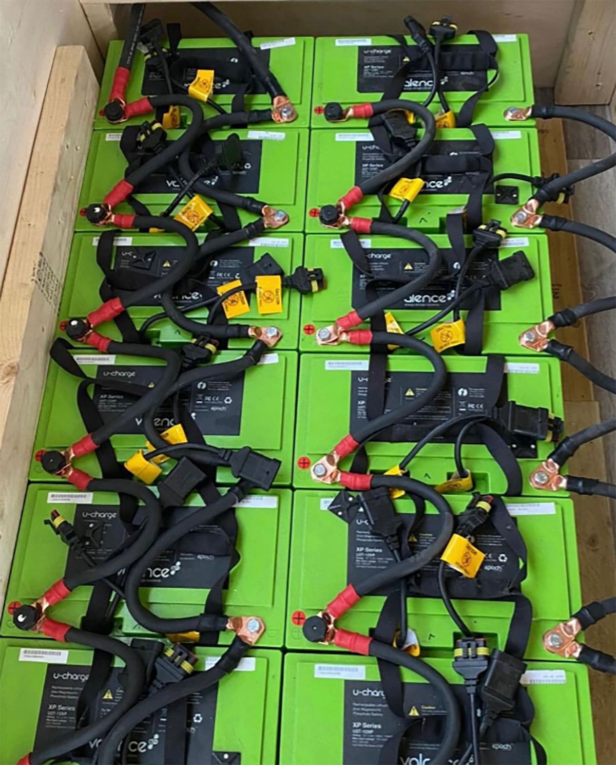

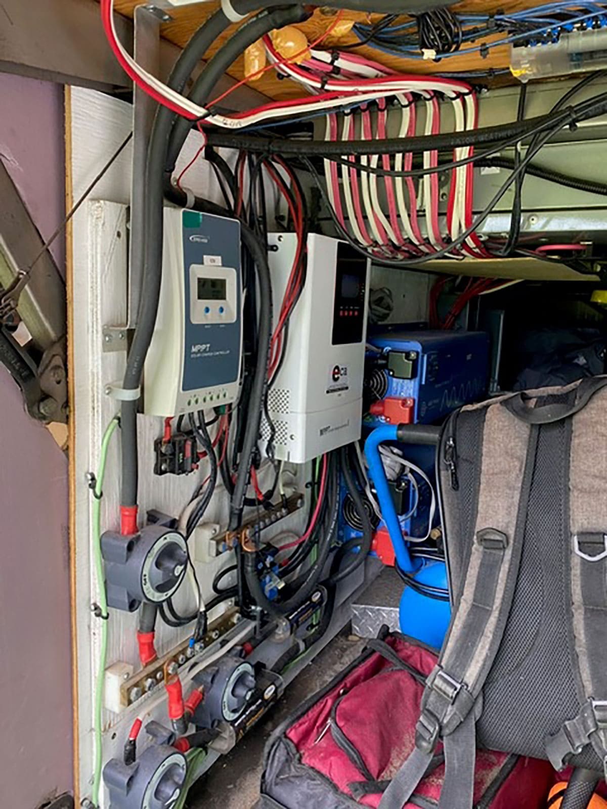

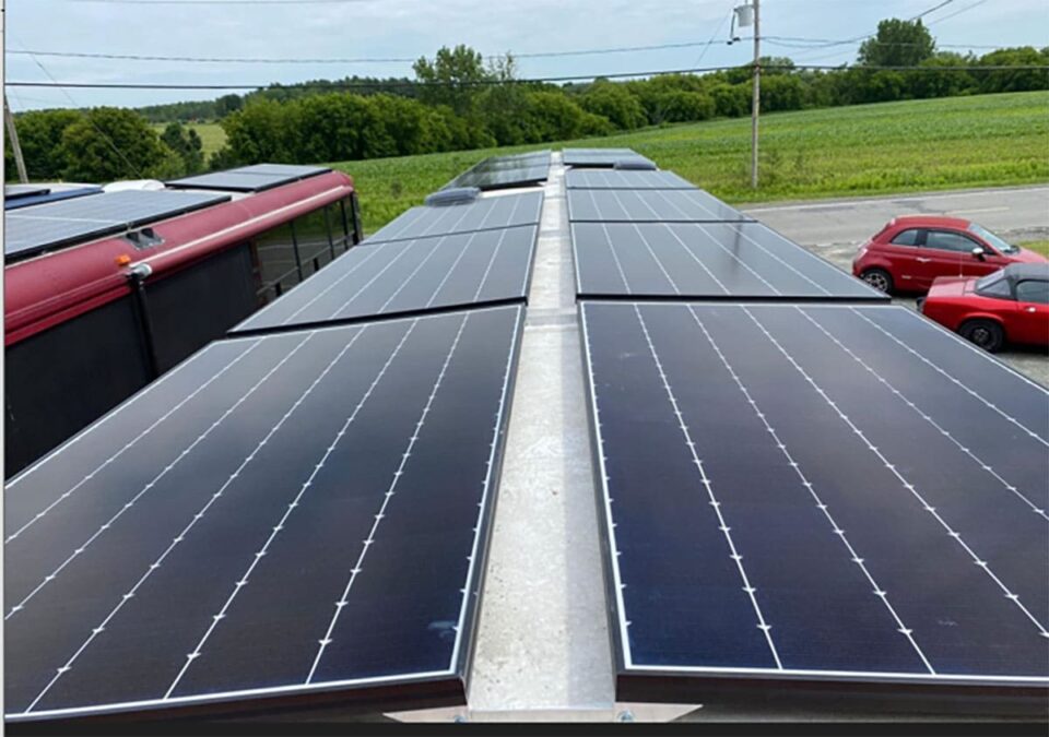

Sustainability was a core principle in our design. Jajadabus is equipped with 12 solar panels and a BlueTech water system with three filters, a 100-gallon fresh water tank, and a 100-gallon black water tank. The bus features air suspension and a unique ZF transmission. Two air conditioning units run on eco mode, consuming only about 380 watts per hour. Inside, we installed twelve lithium-ion batteries beneath the sofa to balance the bus.
Solar panels allow us to stay longer in boondocking locations.
Solar Controllers and wiring.

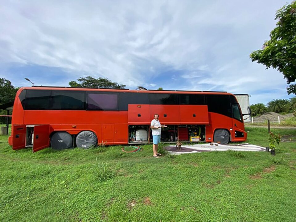

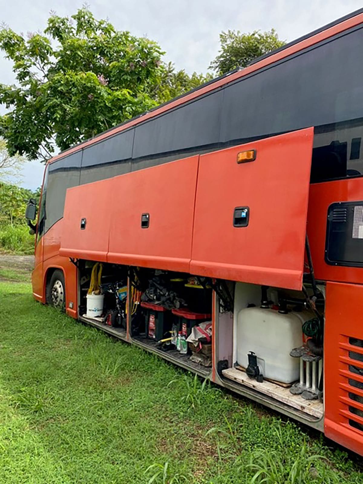

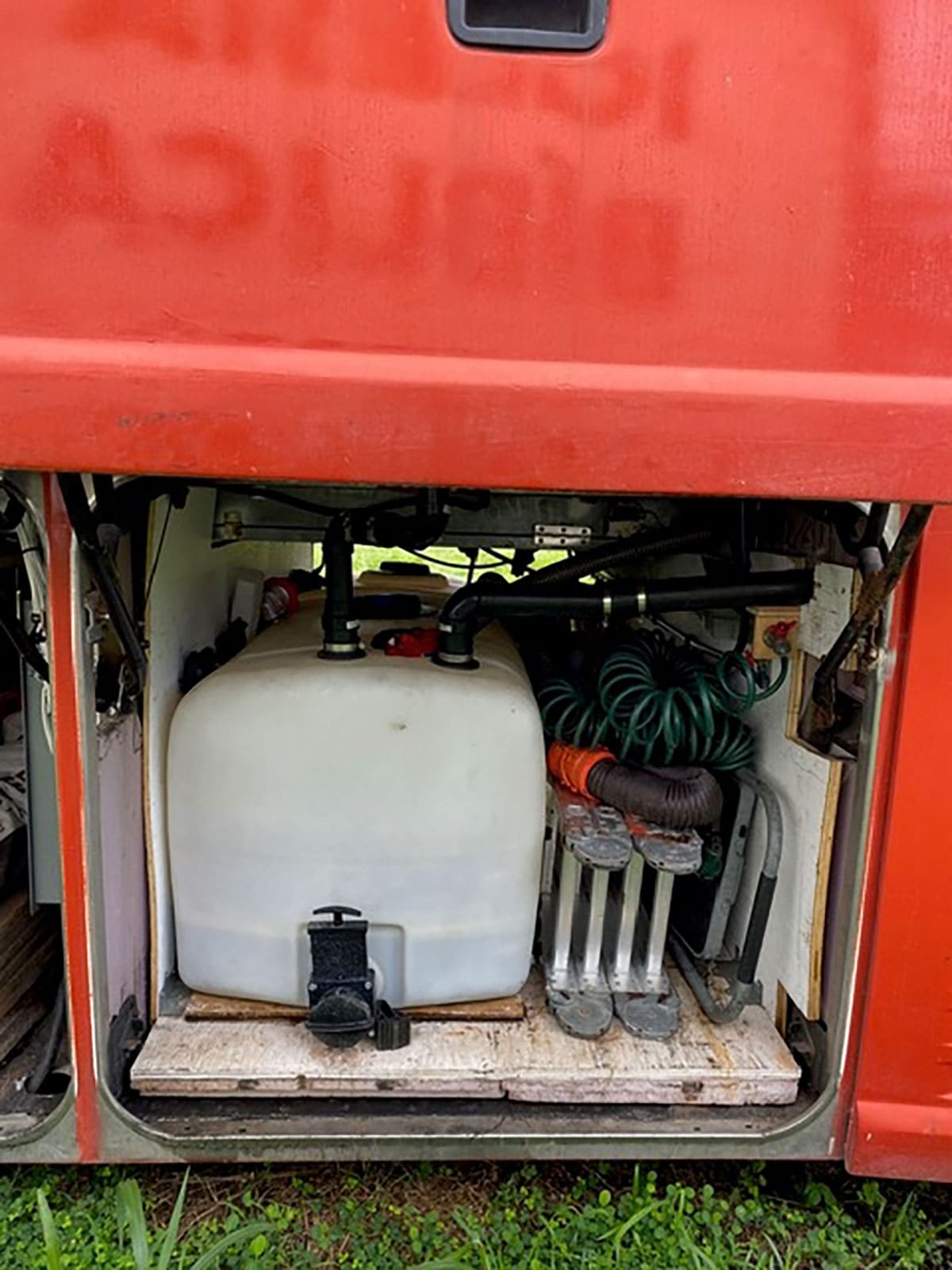

Our gray/black water tank and storage.

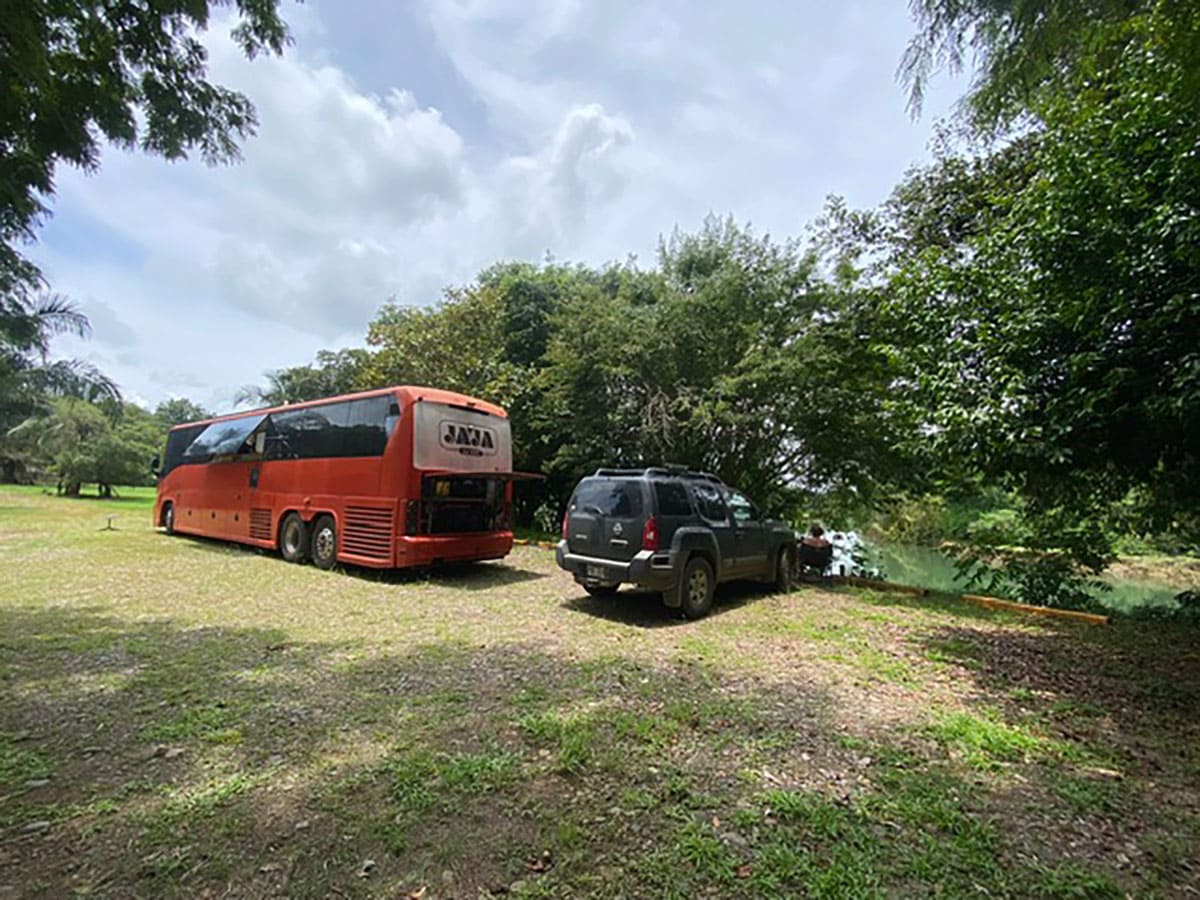

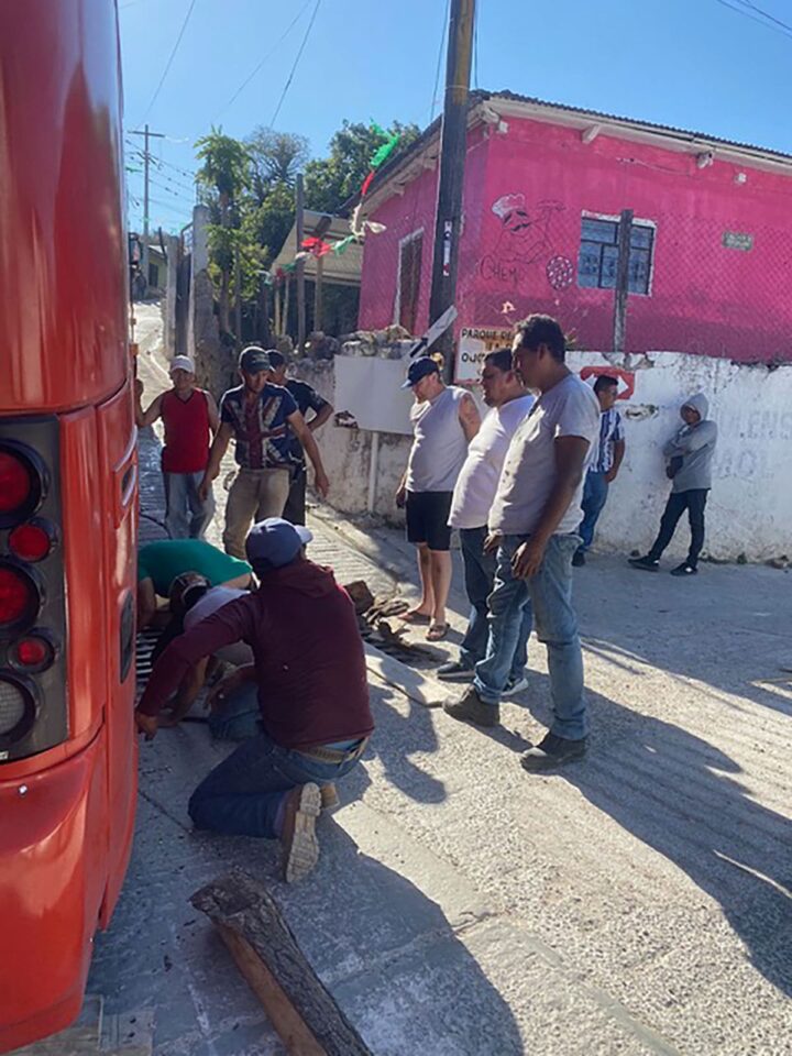

Since hitting the road, we’ve traveled 53,575 kilometers (33,290 miles) and spent 732 days on the road.  Driving a 45-foot bus through the winding, narrow roads of Costa Rica has been challenging. We will cross into Columbia on November 13th and using Overland Embassy for the logistics.
The roads are often in poor condition, requiring careful planning and constant vigilance. Before setting off, we consult truck drivers to determine their routes. The worst roads we encountered were in Mexico, but Costa Rica has had its fair share of difficulties. Despite these challenges, the breathtaking scenery and the freedom to explore at our own pace make it all worthwhile.
In Tzimol, Chiapas, Mexico, the road was too narrow for the Jajadabus.

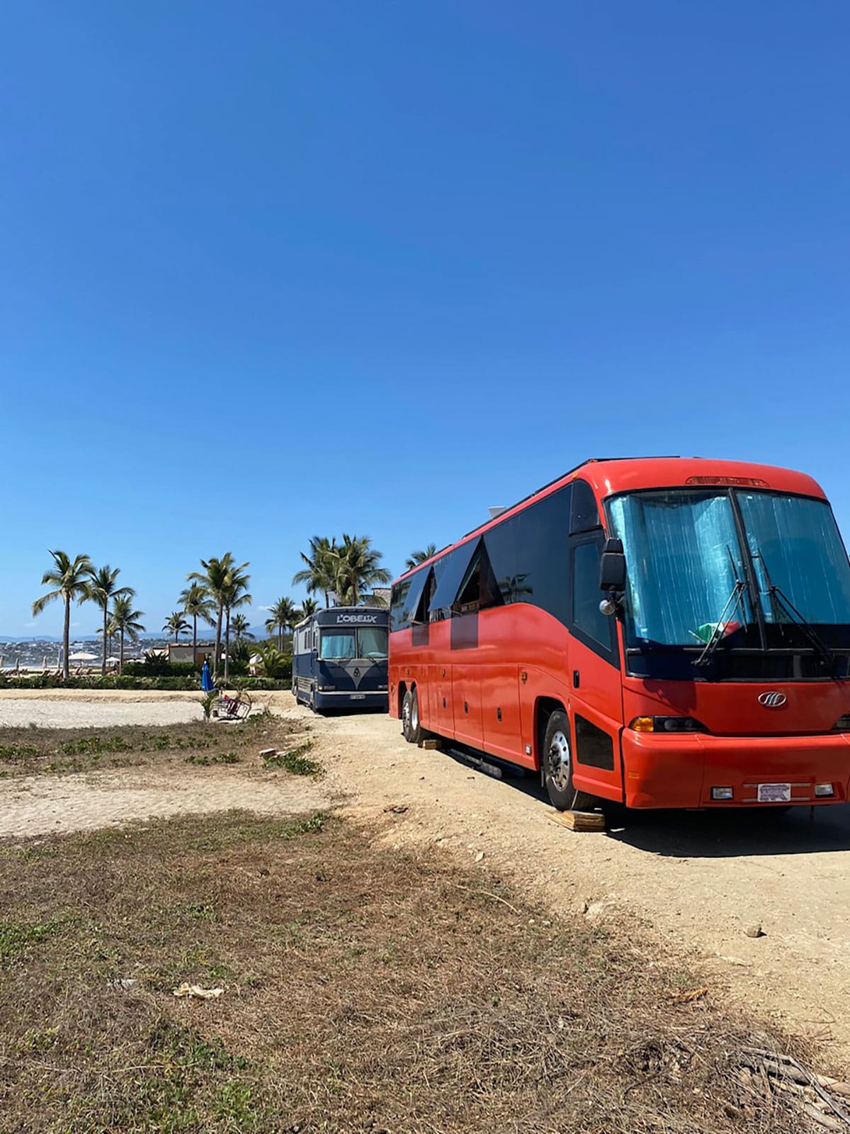

One of the joys of our lifestyle is the ability to stop and stay wherever we find beauty or interest. From secluded beaches to bustling towns, our experiences are as varied as the landscapes we traverse. We’ve met fellow travelers, learned from local cultures, and immersed ourselves in the natural wonders of each destination.
Yoda and me enjoying life on the road.

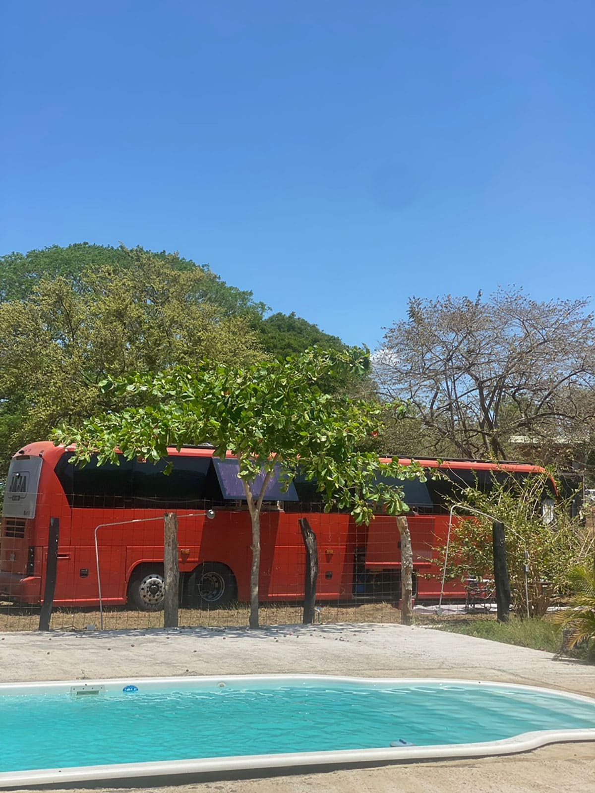

Unique Challenges in Costa Rica
In Costa Rica, we faced unique challenges that those in the U.S. and Canada might not experience. The narrow, curvy roads and the need for constant GPS monitoring added complexity to our travels. Ensuring the bus could handle the terrain required careful planning and frequent consultations with local truck drivers. One memorable moment was navigating the mountainous roads near the Monteverde Cloud Forest. The sharp turns and steep inclines tested our driving skills and the bus’s capabilities, but the awe-inspiring views and the magical atmosphere made it a rewarding experience.

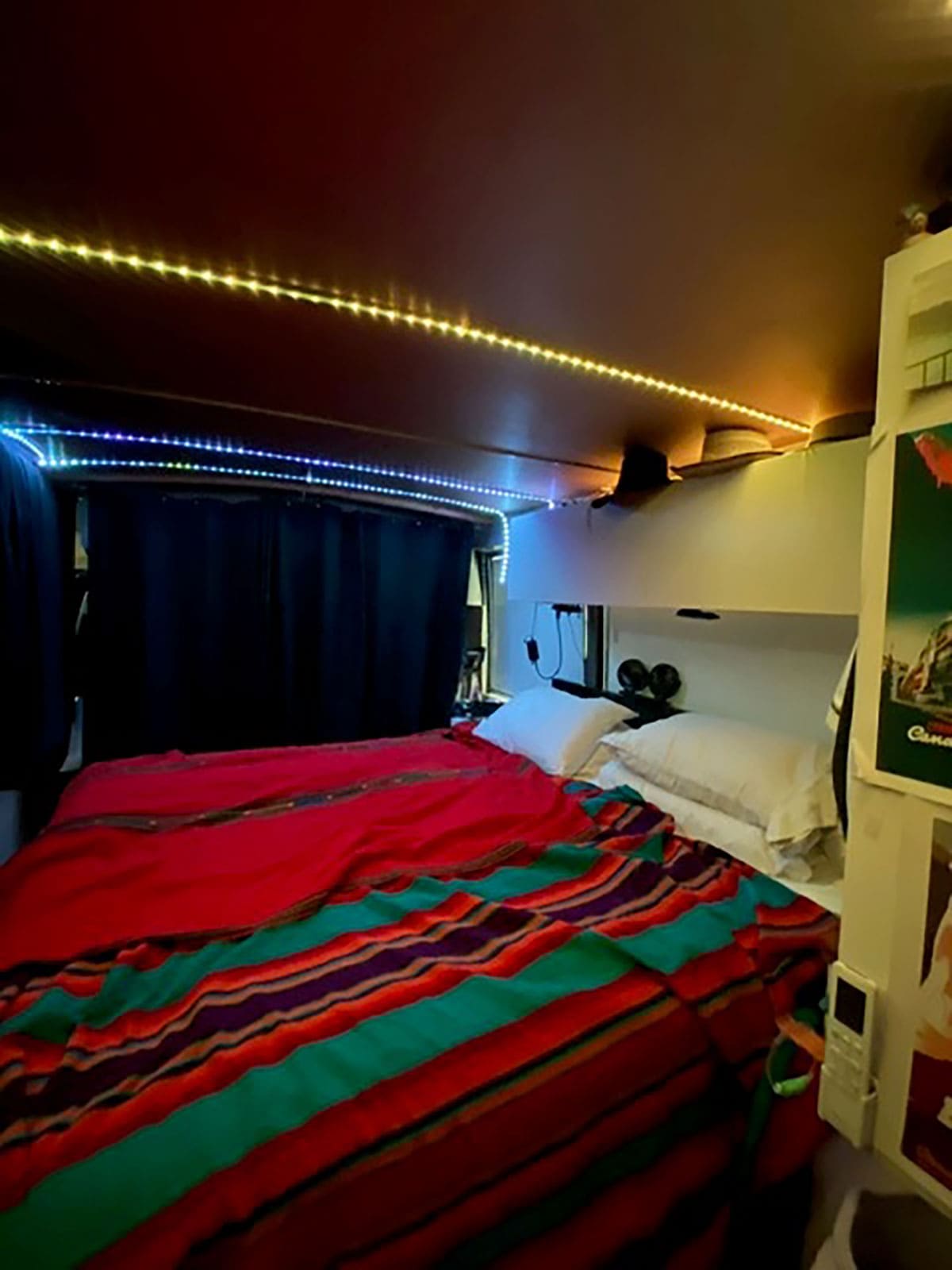

The bedroom. We have heat shields and curtains to prevent the sun from coming in and to keep the room cool since Jajadabus has all its windows.

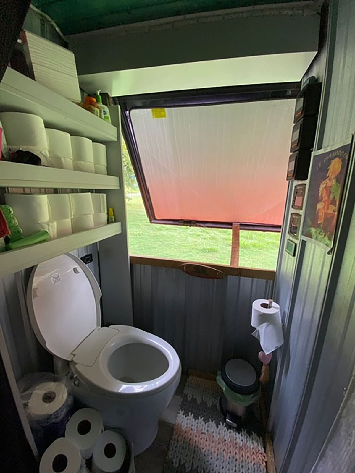

The bathroom, with its spacious shower and bidet-equipped toilet, provides a touch of luxury on the road.

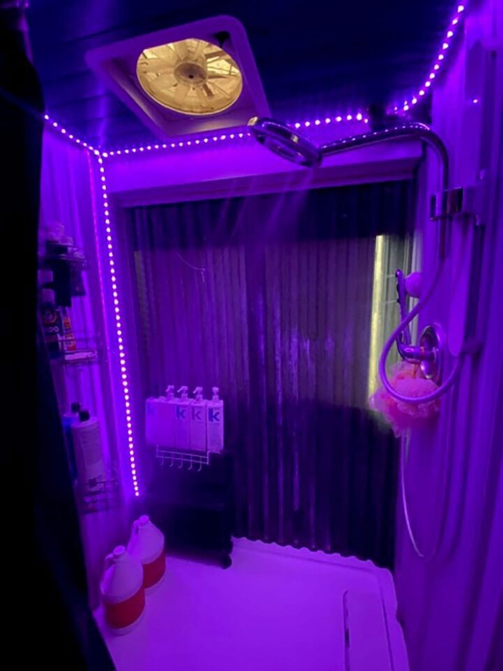

The Shower with an MaxxAir fan to draw out the moisture.

 Here are some photos of the first days we had the bus when we started our conversion.

House Batteries16 Valence U27-12XP
