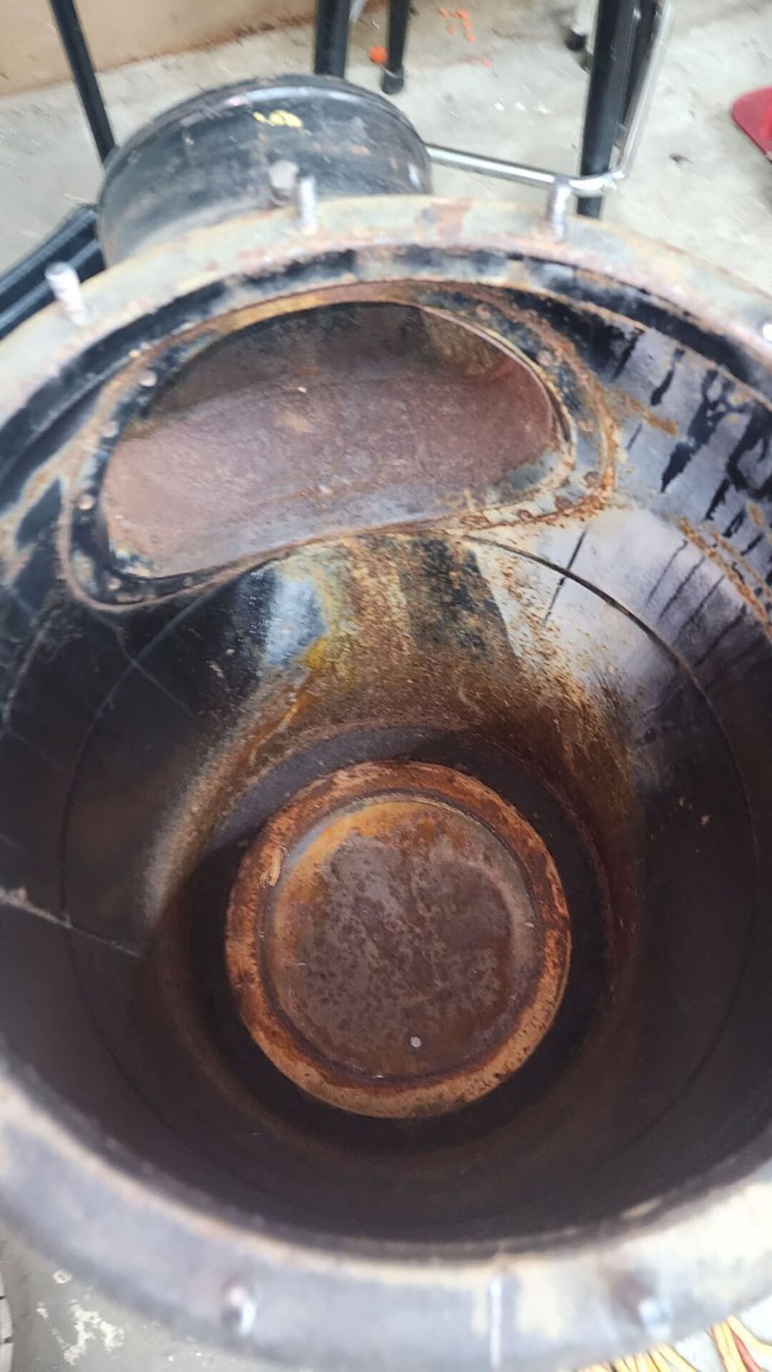

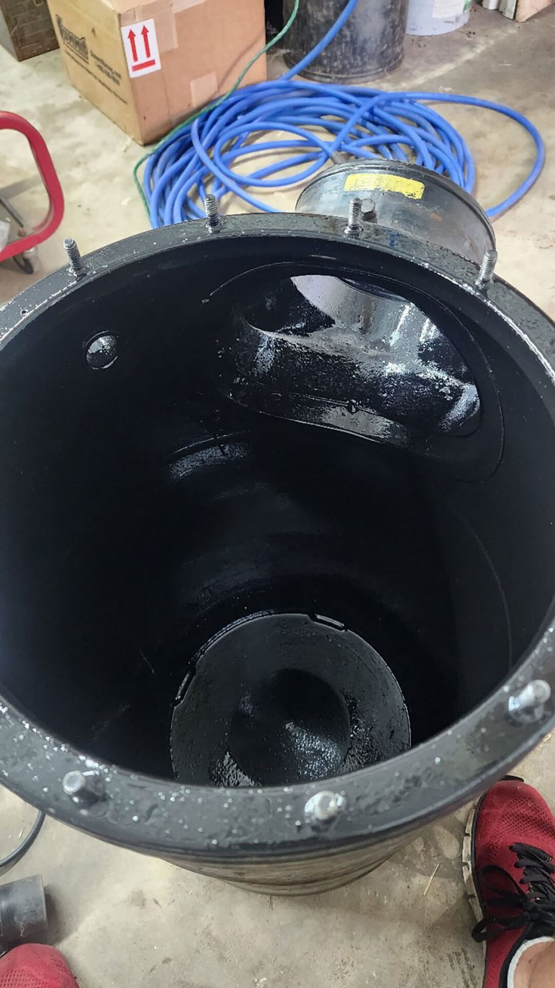

I guess they put a new air filter in it when the engine was swapped out because I bought one to replace it with, and the filter that came out was clean as a whistle; I saved it but put the new one in any way. I also painted the inside of the breather housing with POR-15 because it was rusty.
Air Filter Housing before painting.
Rusty Air Filter Housing before painting.
Air Filter Housing after prepping and painting it with POR-15.

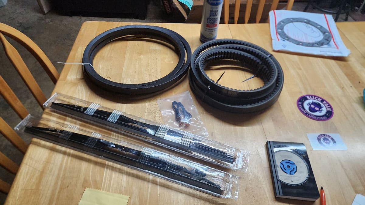

I put all new belts on the engine, AC pump belts, fan belts, and a belt for the 12-volt alternator that sits on top of the fans. The fan system itself was built up with oil and dirt. I don't know if it was leaking or if they just spilled oil on it every time they added to it, but I want to take all of that out and replace the gaskets and bearings, as well as the rubber isolators, give it a good cleaning, and fully clean it, and paint the fans.
Upgrading some parts to help ensure the bus will run with no issues.

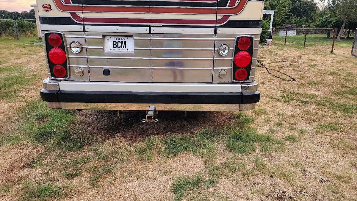

I purchased new taillight lenses and NOS (new old stock) brake lights, and my son Jeremy installed some new LED headlights because the original stock lights didn't give enough light at night. The tail lights work sometimes, but not always as I had truck drivers flashing their headlights at me as they passed, letting me know that one or possibly both lights were not working as they should, even though I put new pigtails and new bulbs in.  It must be a wiring issue?
NOS brake lights installed.

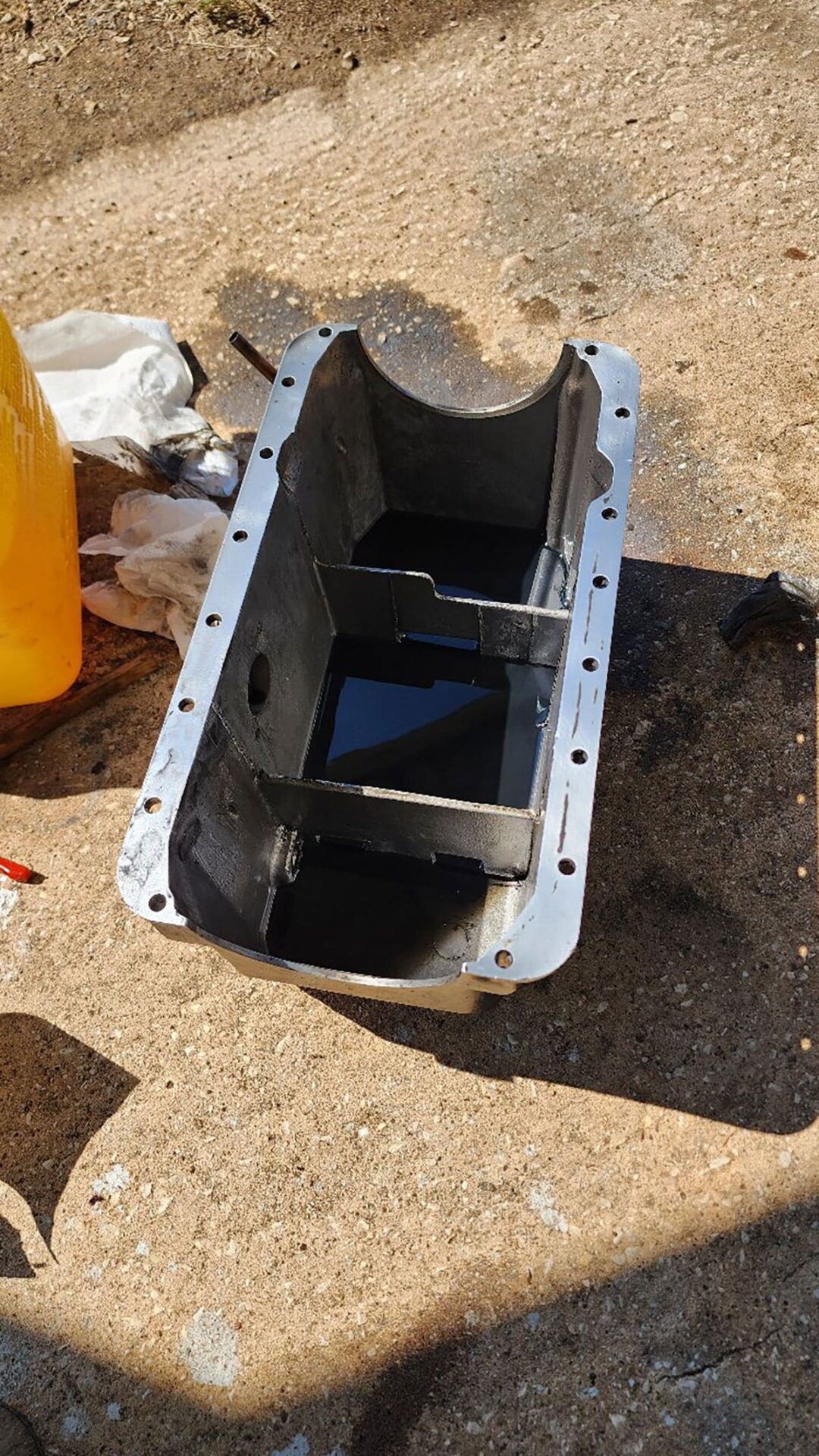

We discovered the main culprit was the oil pan gasket. She had been sitting so long with no running intervals that the gasket had shrunk and dried out, causing the leak. My friend Aaron helped me find a Perkins lower gasket kit, and my son and I spent the better part of a day getting the oil pan off and cleaned, then the matting surface on the block cleaned and a new gasket installed. All of this was an expense, but I was learning that bus maintenance can be expensive but much less expensive than replacing parts after disasters happen.
Gasket Set for Perkins generator engine.
We cleaned the old gasket off the Perkins oil pan.
