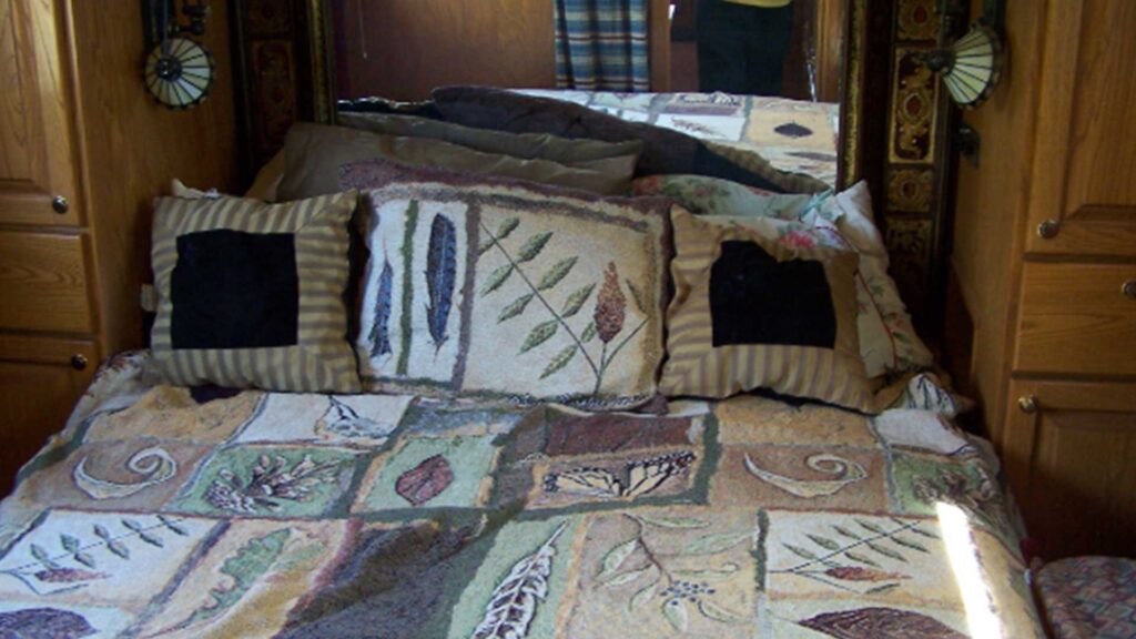

Keeping the Bus Bedroom Cool – Using EHP Rollboard Insulation
Driving a bus with an engine in the rear, called a “Pusher” or more specifically a “Diesel Pusher” if you have a diesel engine, has a lot of benefits, but it also has its unique issues.
Keeping the Bus Bedroom Cool – Using EHP Rollboard Insulation - bus conversion photo
In a front-engine bus, it is easy to keep the engine cooler as fresh air can more easily enter the engine compartment. The airflow to a rear engine is blocked by the bus body itself thereby restricting airflow to the engine causing it to run hotter.
With the engine in the rear, it is harder to keep the engine temperature down, but it has the advantage that the bus is much quieter to ride in as the engine noise is always behind you.
There are several solutions to keeping your rear engine cooler that have been discussed in previous articles, such as rodding out your radiator(s), adding more radiators, adding more cooling fans, installing a water misting system, etc. so, these will not be discussed here.
In this article, I will discuss the issues you may run into because of heat from the engine, by having a rear-engine, or front, or a mid-engine bus for that matter. My bus came converted with a Duxiana mattress. Some of these mattresses can cost as much as $10,000. They are comfortable but heavy. Most mattresses have 400 coil springs in them, the Duxiana has 4000 coils and they are made from one continuous roll of wire. They are amazing mattresses and friends that have them, swear by them.
These are heavy mattresses and the weight comes into play when they are over your engine compartment and you need to access your engine compartment for maintenance or repairs. You have to drag the mattress off the bed frame to access the engine compartment and then drag it into another room as there is not much room in a bus bedroom. My mattress was old and dusty and because of the weight and my allergies, I decided to replace it.
I bought a Sleep Number air bed four years ago. I like the lightweight aspect of it as I can deflate it in about five minutes and remove the two air bladders and easily carry them out and set them on my sofa, out of the way, when I need to access the engine compartment.
The Sleep Number bed also is really not a mattress but an air bladder with a zipper-enclosed cover so it does not trap in as much dust so my allergies are less prone to acting up. It breaks down into two bladders, one for each person, some foam for the sides, and a mattress wrapper that zips everything inside.
I had to modify my bed to extend the platform so that it would support the entire mattress. Even though I retained a queen-size bed, without a built-in box spring, I had to support the mattress all the way to the edges. I did that by buying one sheet of 5/8” plywood, and with a few cuts and some screws, I had the entire surface below my air mattress covered.

In the past, when arriving after a few hours’ drive, especially when climbing hills was involved, my bedroom was very hot and my mattress was too hot to sleep on. I generally just slept the first few hours on the sofa and by the time I was ready for the second half of the night, the mattress was cooled down enough to sleep on
Slightly open bedroom window whilst driving.
With the Dux mattress, this was not a problem because the mass of the mattress absorbed the heat better and it didn’t escape into the cabin as much. It kind of acted like an insulator. But with the Sleep Number air mattress, the heat just goes right through the air and dissipates into the bedroom.
