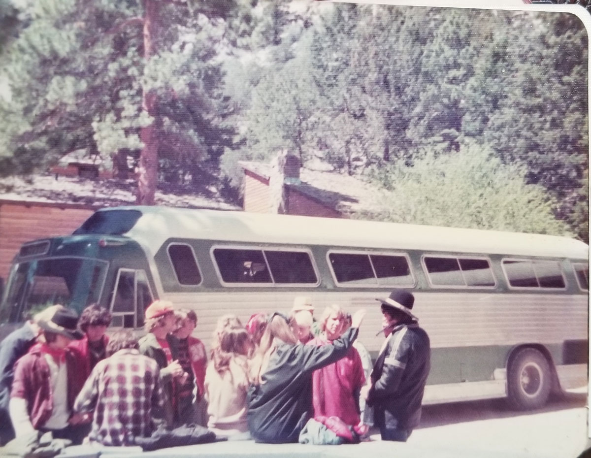

Flx HL100 loading for a cross country trip home from Buena Vista CO.
Flx HL100 loading for a cross-country trip home from Buena Vista, CO.
