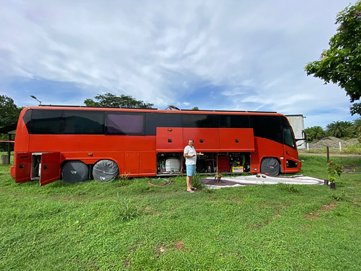

Our bus on one of our first trips out.

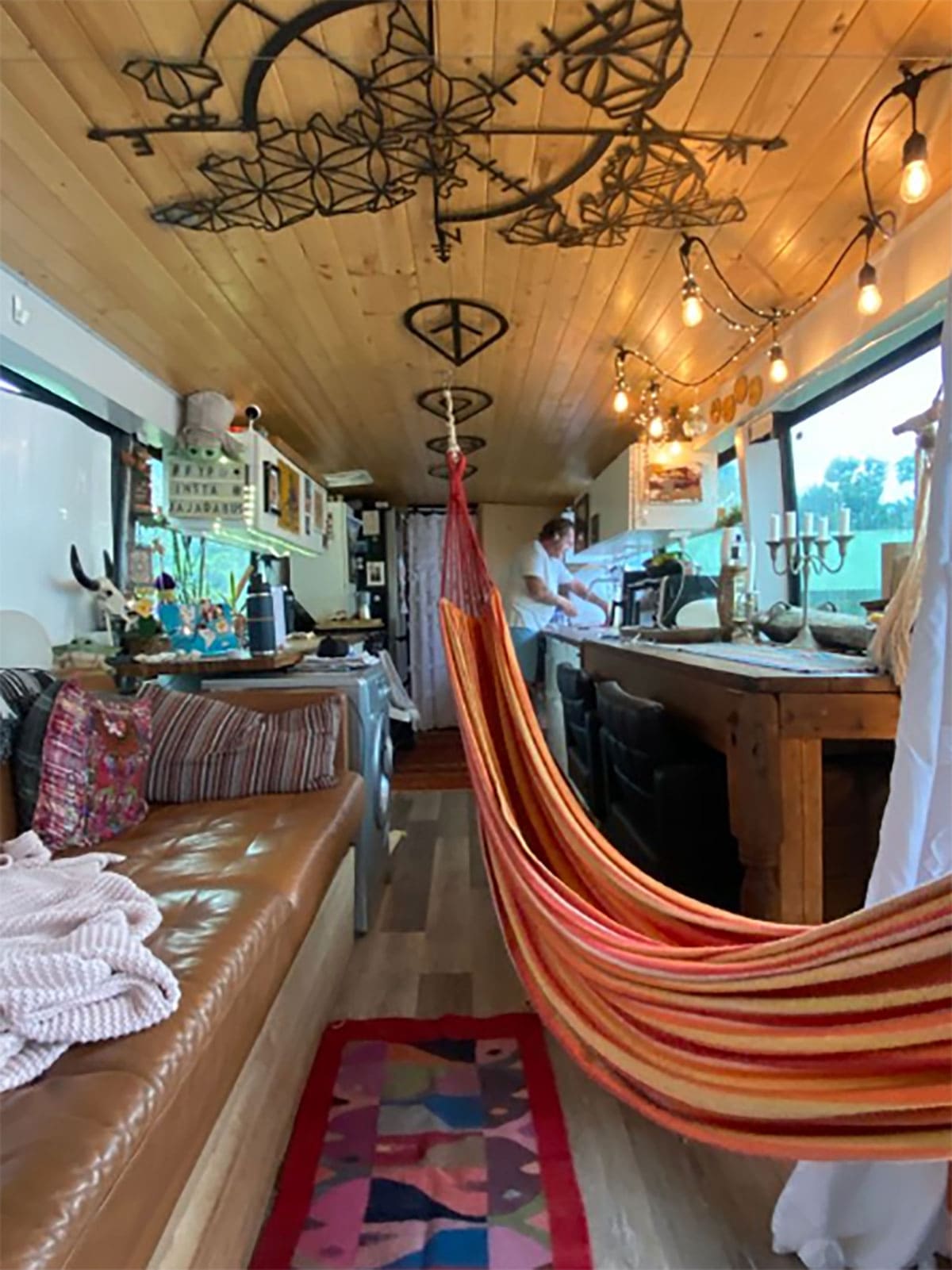

You can see from the living room to the kitchen; I really like the Boho-chic vibe with the hammock and the interior design.

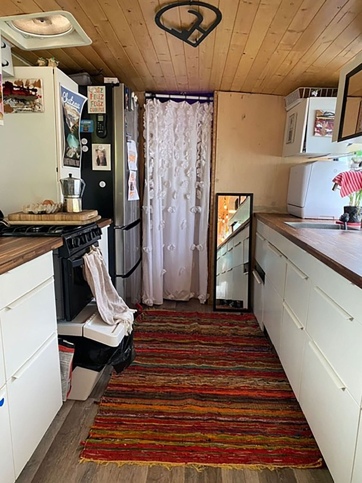

Our bus is designed for comfort and efficiency. It includes a combined washer/dryer (which requires external power), a dishwasher that uses just six liters of water and 500 watts of power, and a 120-volt inverter fridge. The master bedroom features a custom king-sized bed for restful nights, and we have a spacious shower and bidet-equipped toilet to ensure a comfortable experience.
Our Kitchen looking towards the rear bedroom.

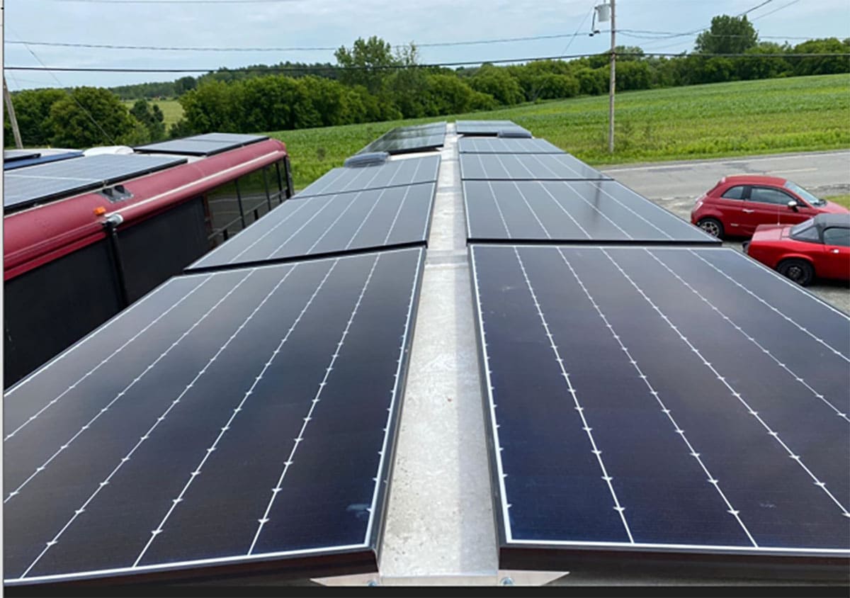

Sustainability was a core principle in our design. Jajadabus is equipped with 12 solar panels and a BlueTech water system with three filters, a 100-gallon fresh water tank, and a 100-gallon black water tank. The bus features air suspension and a unique ZF transmission. Two air conditioning units run on eco mode, consuming only about 380 watts per hour. Inside, we installed twelve lithium-ion batteries beneath the sofa to balance the bus.
Solar panels allow us to stay longer in boondocking locations.

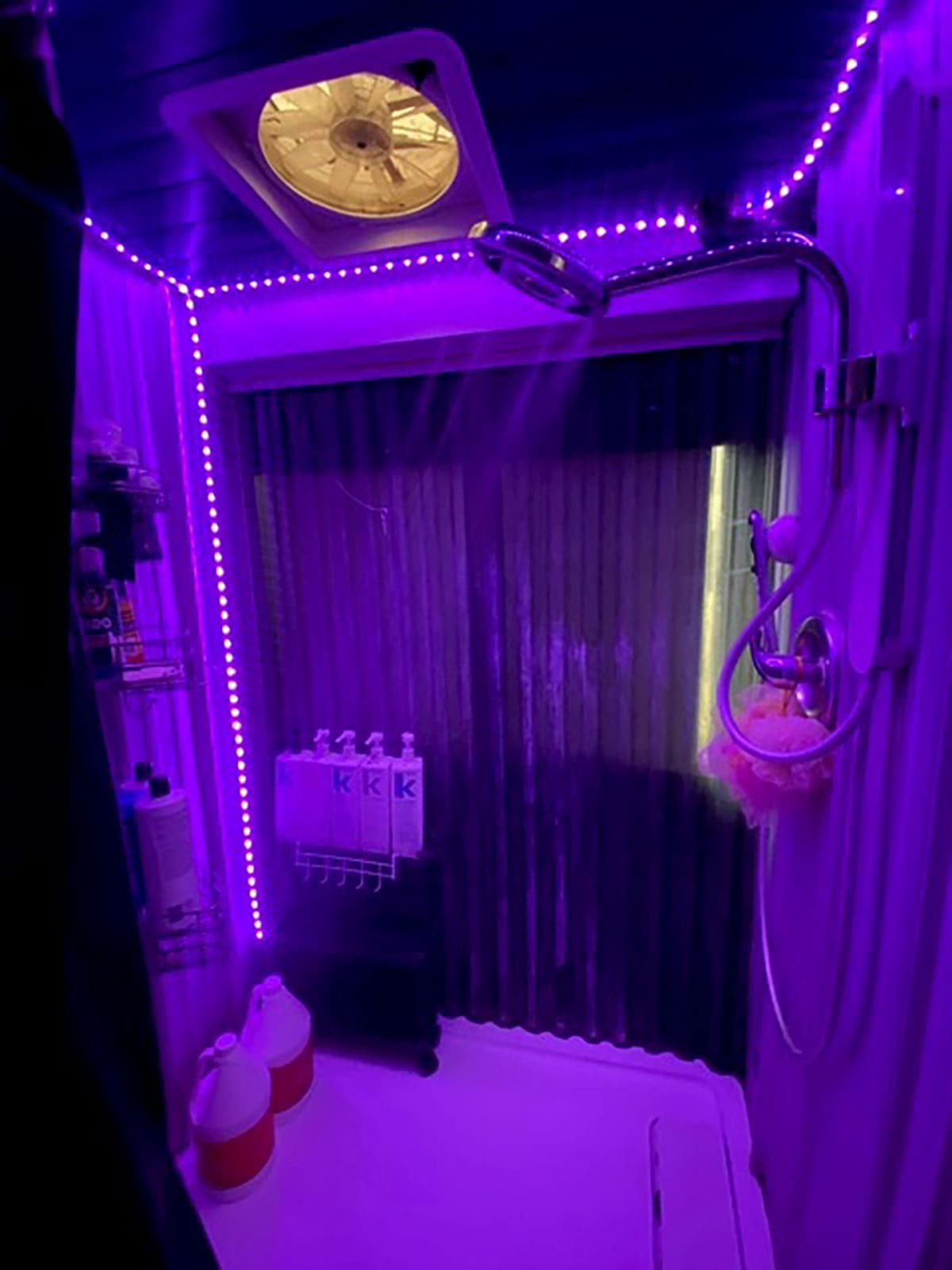

The Shower with an MaxxAir fan to draw out the moisture.
