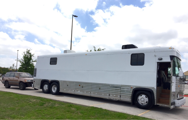

Re: Toad or Trailer – That is the Question
Reply #17 on:
May 04, 2016, 10:13:34 AM »
Nuther vote for 4 down. 1998 land cruise triple locked.
